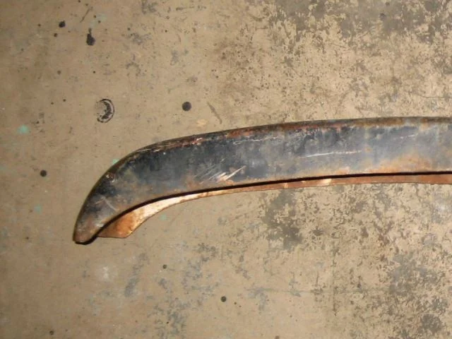

They have a pretty tight radius on the end and I believe are close to 1/8" thick (I'd have to check) so make sure the shop is aware of that.
I'll be back in town tomorrow night, Thursday I have to go to the machine shop close by, I'll bring one of my 40 serieis bumpers with me along with the info above and get some definitive answers regarding time frames, pricing etc.
Here's a picture to give you an idea of the radius. Basically flat across the entire front and turns in at the end, unlike the 40 which has a longer radius beginning at the mounting bracket. If your 40 bumper is original Toyota it should be the same thickness.
