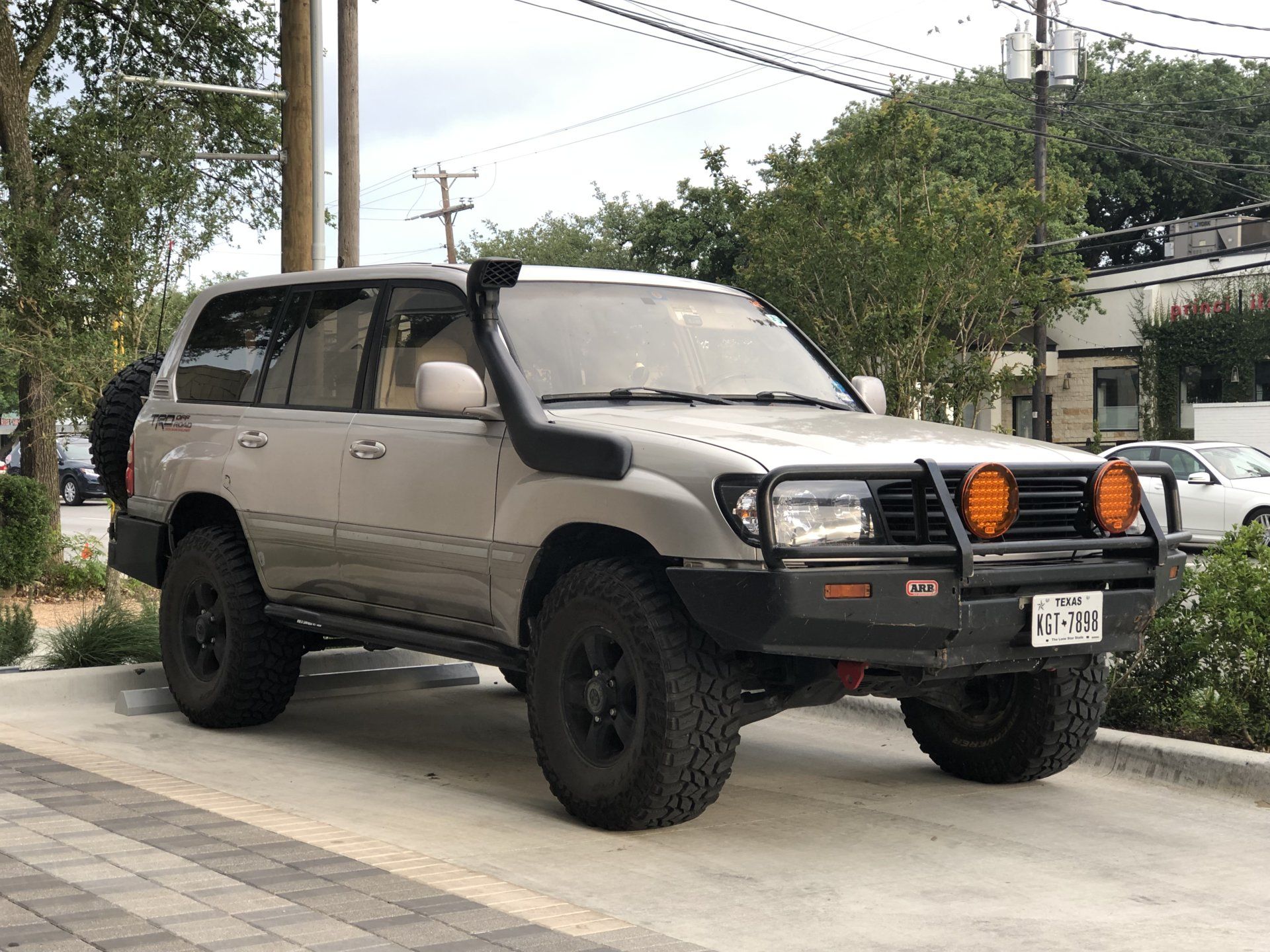

I have the "LED" Amazon lights on my Ironman bumper. Love them. I'm sure the ARBs are "nicer". But, I used the $800+ in savings for other bits. When I "need" to use these lights, they are plenty bright and serve their purpose quite well. I put amber covers on them because the white light from LEDs is intense and makes anything reflective shine very brightly. The amber knocks down the glare while still allowing a TON of light to illuminate the area in front of me.
I run mine to a 6panel switch also bought off Amazon.

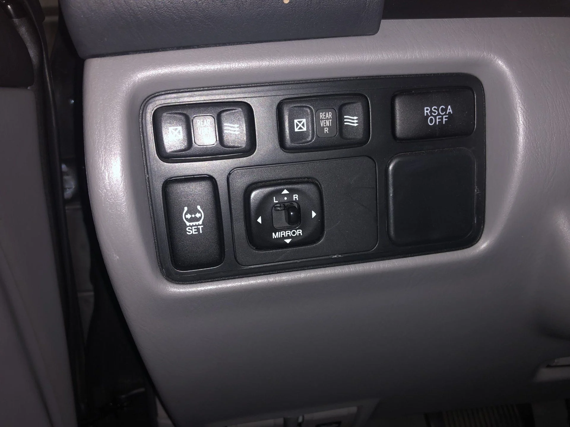

Not sure where to put the switch either. Only available spot is the square spot and the online switches seem more rectangular. How does this work?
Two small switches from any auto parts store will fit on the large square blank.

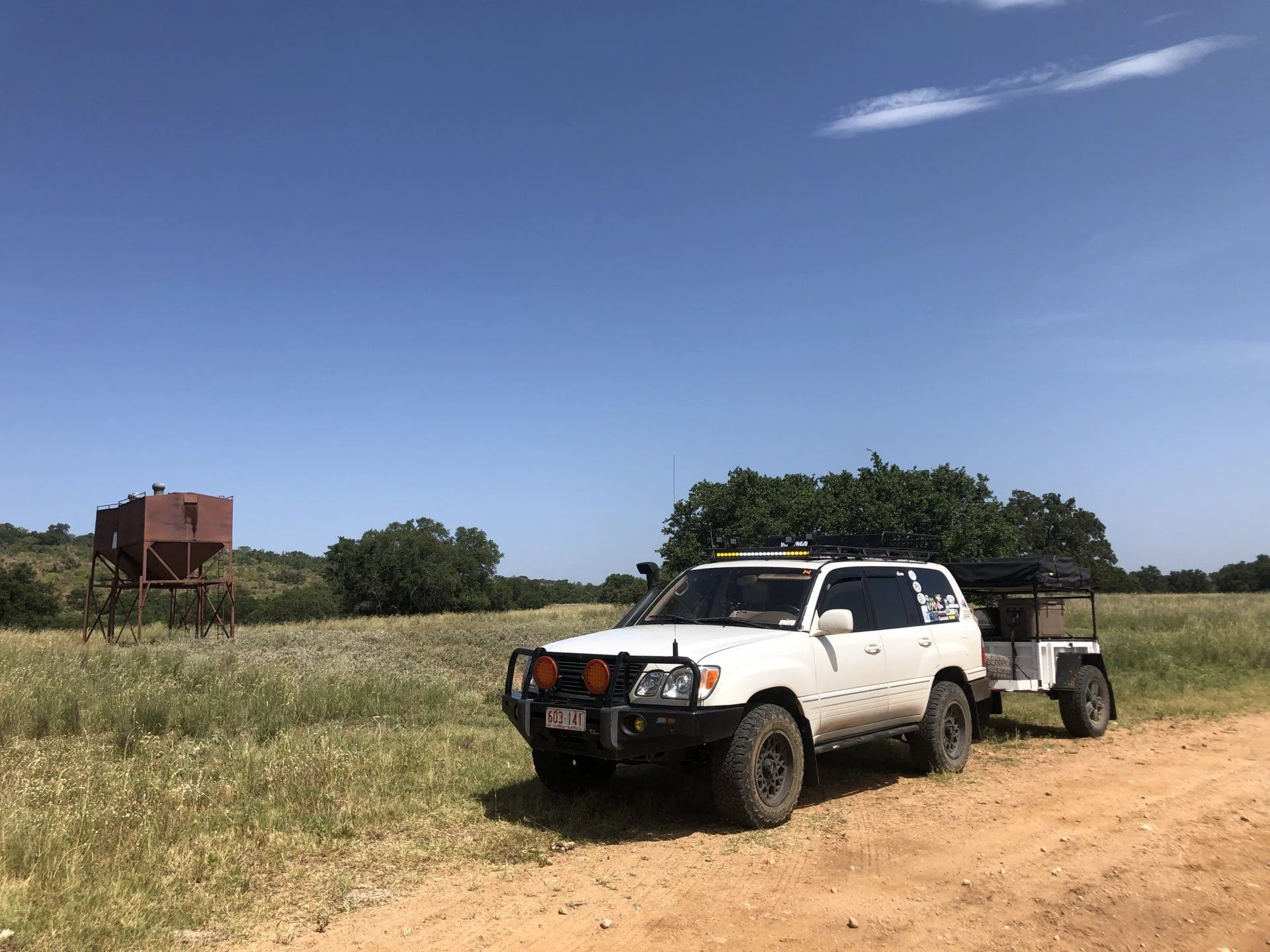

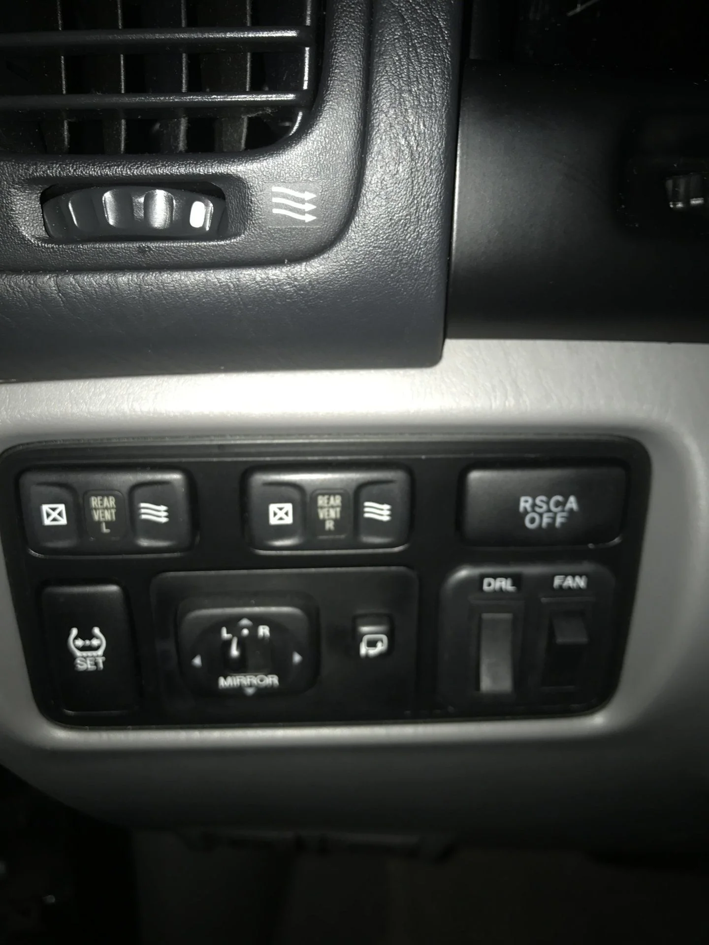

I wired my amazon rounds to my fog light switch since I have the older ARB with no fogs. Only bummer is headlights have to be onnto run them. Honestly I’ve never encountered a scenario where that is a problem. but I also am setting up a 40” bar for my roof that will be on an independent switch.

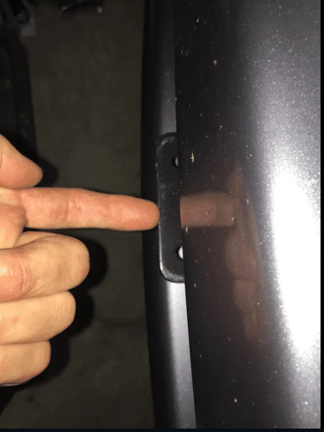

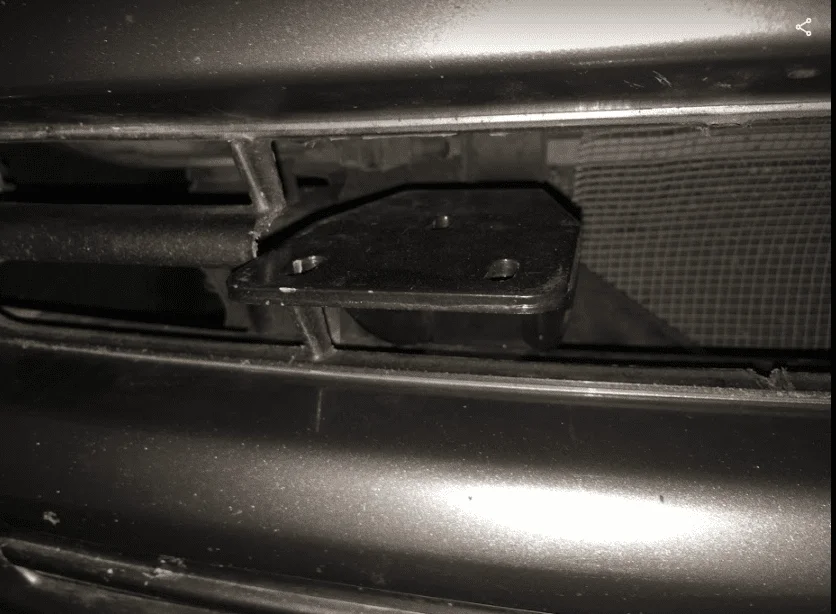

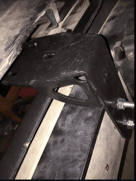

I bought a set of the 384W units and was going to use the ARB awning brackets (super beefy and well made) mounted to the aluminum crash bar. I even went so far as to cut a section of the lower grill in the bumper to allow the brackets to "poke through".
From there I planned to use aluminum flat stock for a horizontal surface to mount the lights.
I changed my mind, as the lights would protrude further than the bumper skin or license plate (Texas requires a front plate).

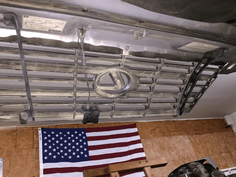

I am going to try and mount them to the grill on the hood.
I then ordered a few pieces of angle aluminum and am going to try and make brackets using the center grill supports that attach the grill to the hood.
Hope to post some pics of finished project or report if this is a bust/bad idea.

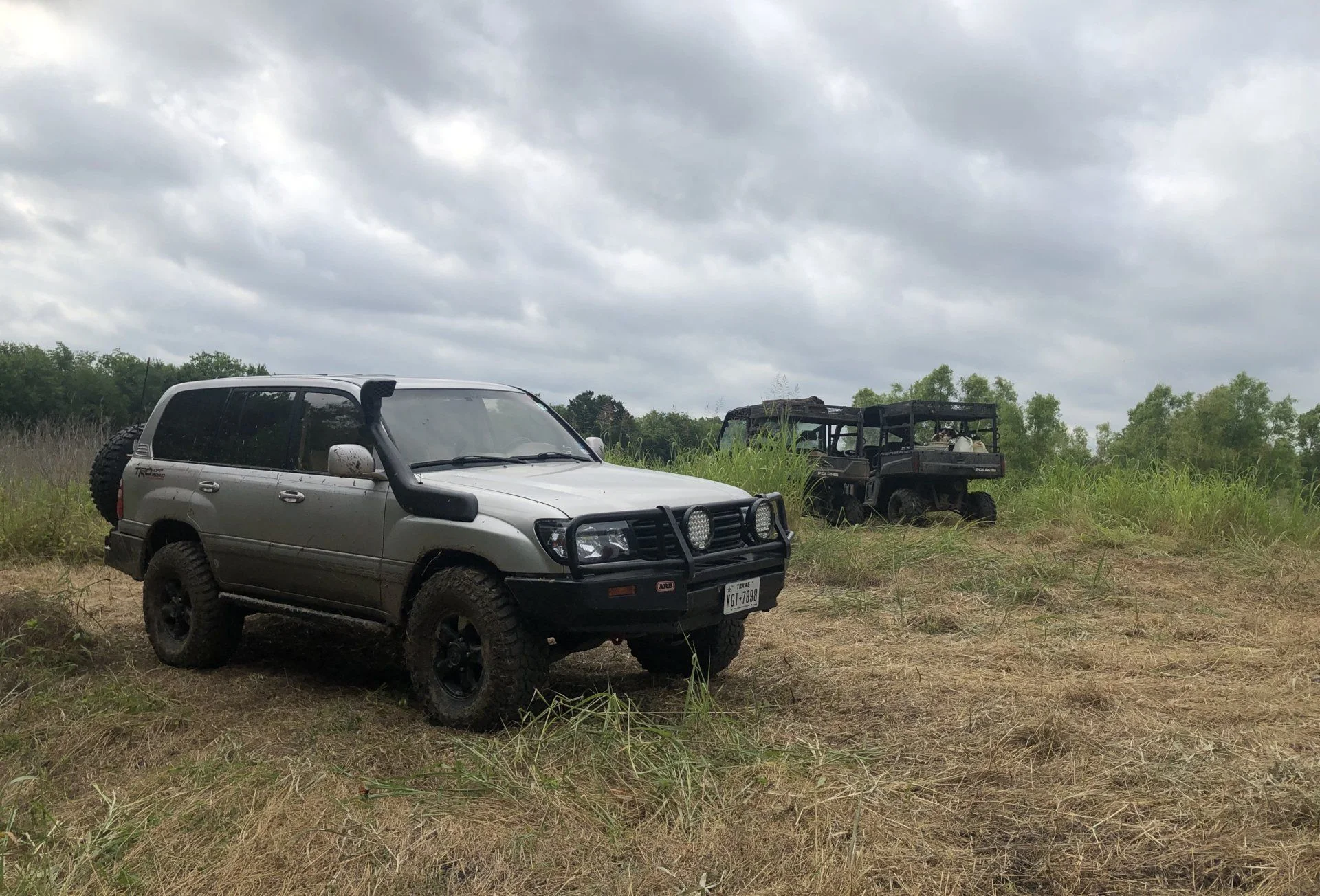

I bought these a long time ago from a mud member but he is no longer in Japan. They are the amber ones as well with the Toyota clip on cover.

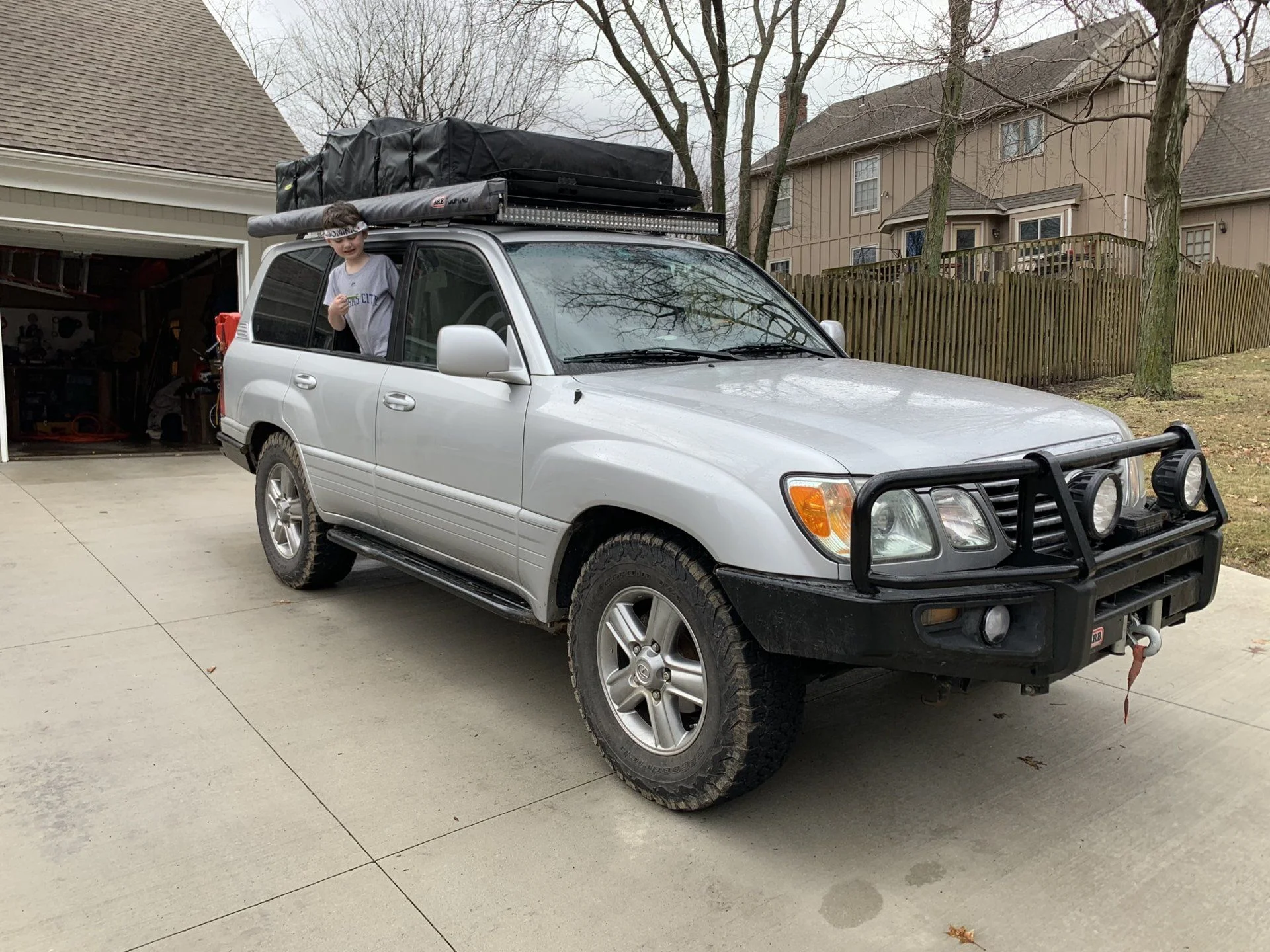

I found these Auxbeam lights I got from Amazon for about $170 a pair. I’ve been really pleased with their performance and how far they have stood up over last year and a half. Sorry for the bug saturated pic.
