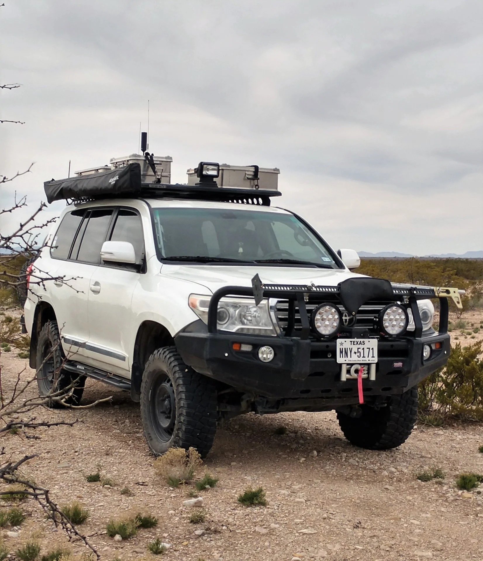

Strength without a bull bar:
-Slee
Strength with a bull bar:
-TJM T13
Strength, but with crumple zones (some prefer this for accident crumpling) :
-ARB
If strength is not a priority…
-Any of the rest will do.

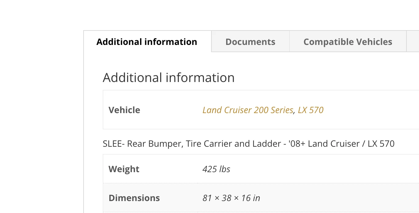

If I were to buy one today, I wouldn't have any hesitation to go Aluminum for the way I use the truck. The weight savings is something you benefit from every day. Crash impact strength is something almost never 'used'. Not sure about the front weight delta, but I believe the rear is on the order of a 200 lbs weight savings (Dissent vs Slee) including attachments. It's significant.
For Dissent, adding advertised weights I get 110+61+57 = 228 lbs. This is for bumper + tire carrier swing + basket swing. Slee says 325 lbs. sans the basket attachment. The additional info section says 425 lbs. Typo? Shipping weight?
So is it 100 lbs. or 200 lbs difference? An early post from Cristo stated 260 lbs. weight without hardware, but with swings I suppose, as they aren't optional really.
I guess we need to email and ask.
EDIT: just got response from Slee. 325 lbs. is the bumper weight, 425 lbs. is the shipping weight. So ~100 lbs. penalty but given the construction/look might be worth it. And actually Slee costs about the same (<$200 difference) with the basket add-on. Well, I have had one sitting the garage for the past ~4 years, maybe I will get around to installing it :(
