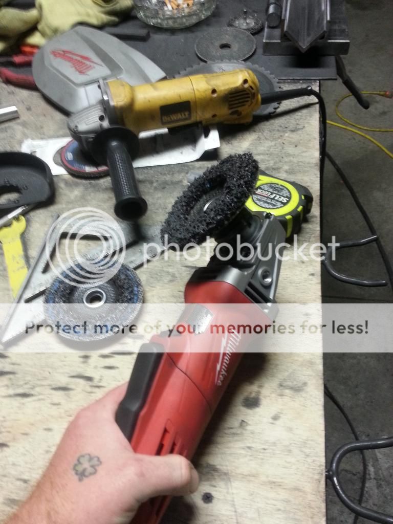

Use these to get all the mill scale off
Got a new Milwaukee 11 amp grinder.. love it
Nice bright clean steel
So clean it almost looks painted those really work well but dont last all that long
