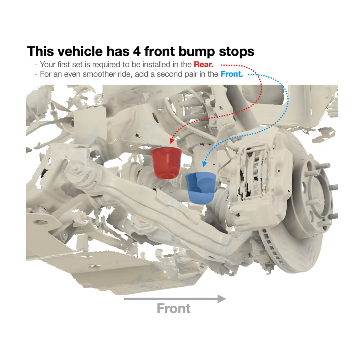

Currently have the Timbren Active Off-Road Bumpstops front and rear. With 35's and 0 offset, I have had some front fender liner contact on some bumps and am looking for smoother engagement on whoops.
Looking to remediate this and improve ride quality by adding a second pair of front bumpstops to the Forward position, for 4 total aftermarket front bumpstops.
Any pointers on whether I should add another pair of Timbren #ABSTOF Active Off-Road Bumpstops, or add a pair from another brand such as Perry Parts or Durobumps? Or even add a pair of Timbren SES #TOFLC2 to the Forward position?
This diagram by @PerryParts is helpful for those with similar questions in this thread also:

The front has a smaller length between contact points than the rear position so it will limit up travel more putting the same bumps in that position. For me it would have been too much. My LX would have been engaging them in low mode so I opted for cutting down a poly bump to fit in the front position to limit it the least while still providing more bump stop than the stock ones.
Perry Parts hadn't come out yet at that point, but it was difficult to find one with a shorter length to fit what I thought it needed to be. Have you done the fender liner mod to alleviate that rubbing? Have a pic of where it rubs?
