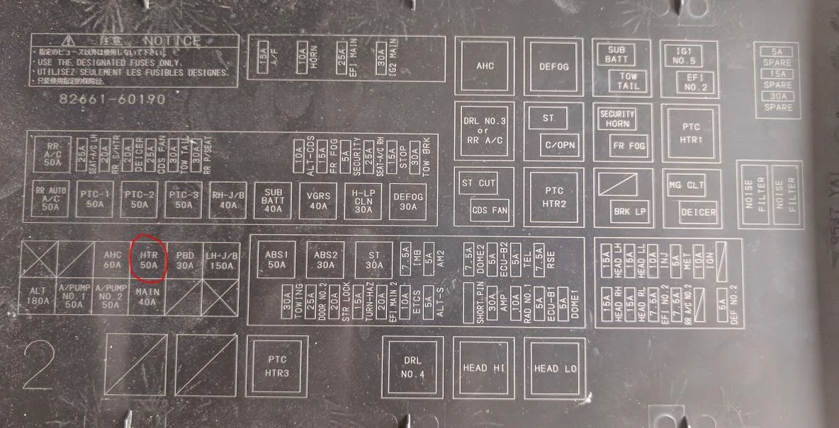

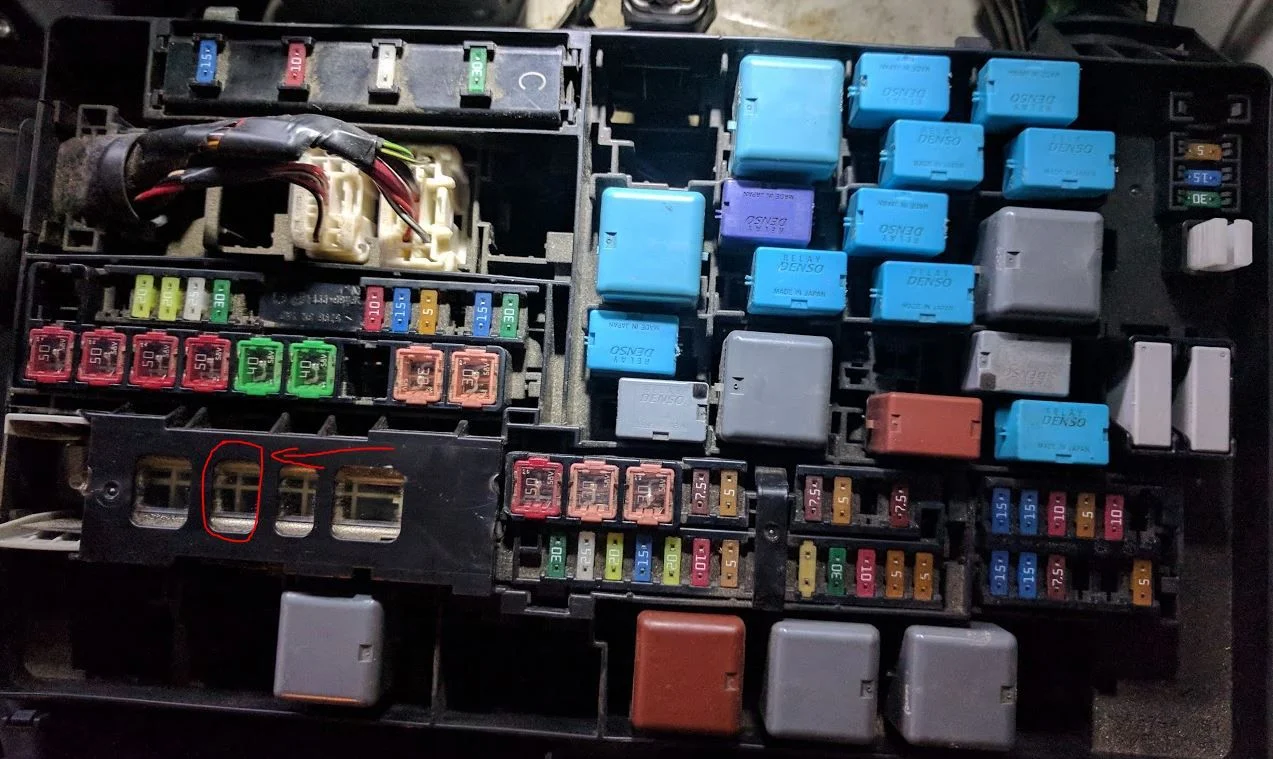

Finally managed to get the car under a roof and located what seems to be the right fuse based on the diagram. However, I can't get to that particular fuse block (can get to all others fine). Attaching some picture: (1) fuse cover showing diagram (2), fuse block where #23 (HTR 50A) should be located and (3) close up of the area.
I can see though the small plastic window, but not seeing any fuses there. Also not seeing how to get inside that particular block (with small plastic windows), the plastic frame seems to be part of the main fuse cover. It almost seems that the diagram is not correct, but that's the diagram that came with the car, so not sure how that's possible.

I just looked at mine and it looks exactly the same. The fusible links are there, they are vertical. But I have no idea how to get down in there to get a closer look at them.

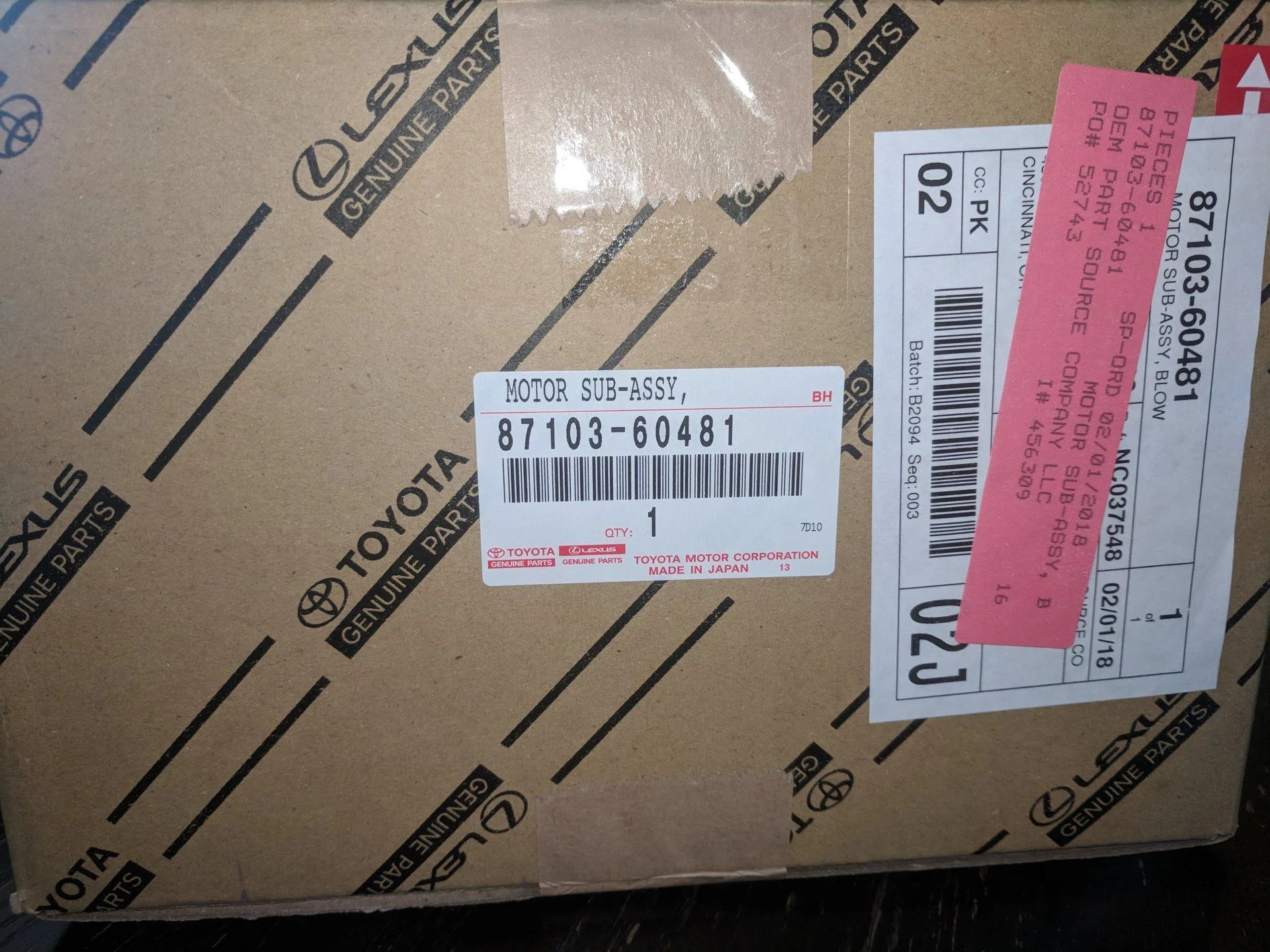

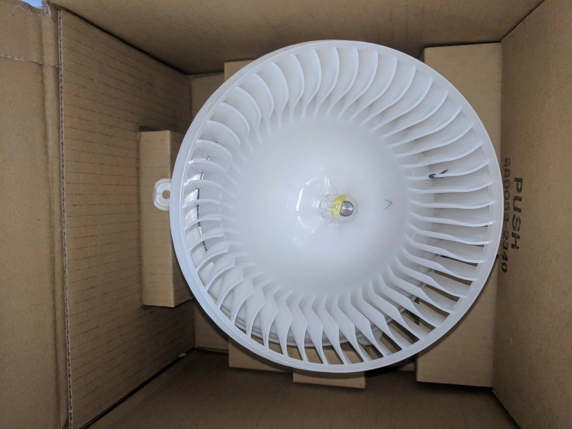

Same thing happened to me this winter. Replace the blower sub assembly. Remove the panel under the passenger side glovebox, remove the radar (1 screw), then drop out the blower (3 screws and unplug the wiring harness). Finally slap in the new one. Takes about 30 mins tops.
