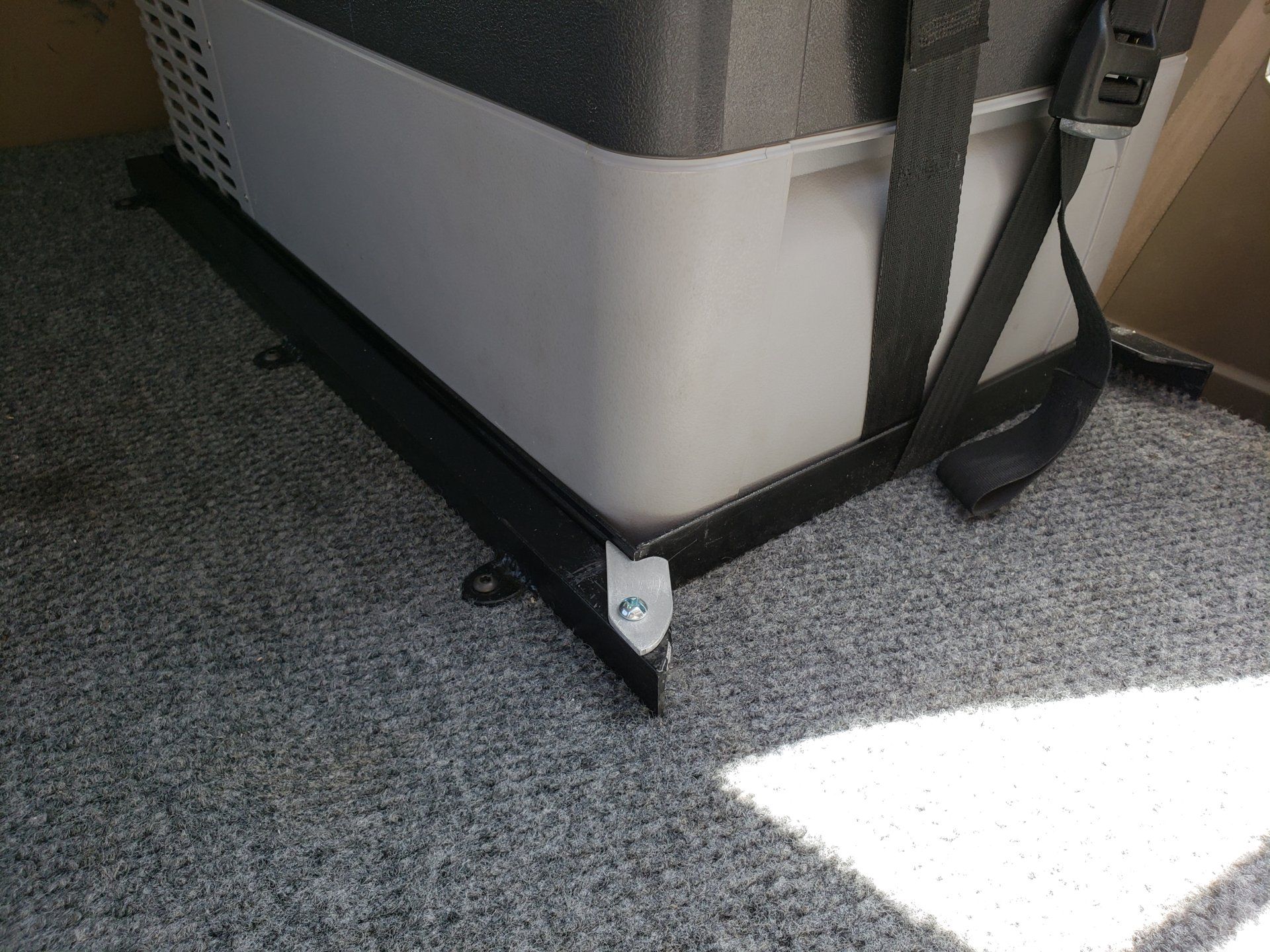

Building an enclosed box can be good too if you need to pack things on top and it will also keep things from falling behind the fridge if it's on a slide. A simple slide is easy to make if you're mounting it at floor level. You would really only need a tilt slide or drop slide if you have your fridge mounted on top of drawers.
I ran my ARB fridge on a DIY slide for years before I added drawers. worked great. I now have a tilt slide since I have a new fridge on top of my new drawers.
I agree with Adam that the gullwing makes a nice option, but you really want a slide unless you like being aggravated by the reach. I see you're on 33s. That's what we run, I'm tall, and I still can't reach the bottom og our fridge. Taller tires would make this even more out of reach.
I home built a slide and it works well with the rest of the sleeper conversion I built along with it. We slide the fridge back to gain extra room inside to sleep, something else to consider as an option that the slide in whatever form makes possible.
