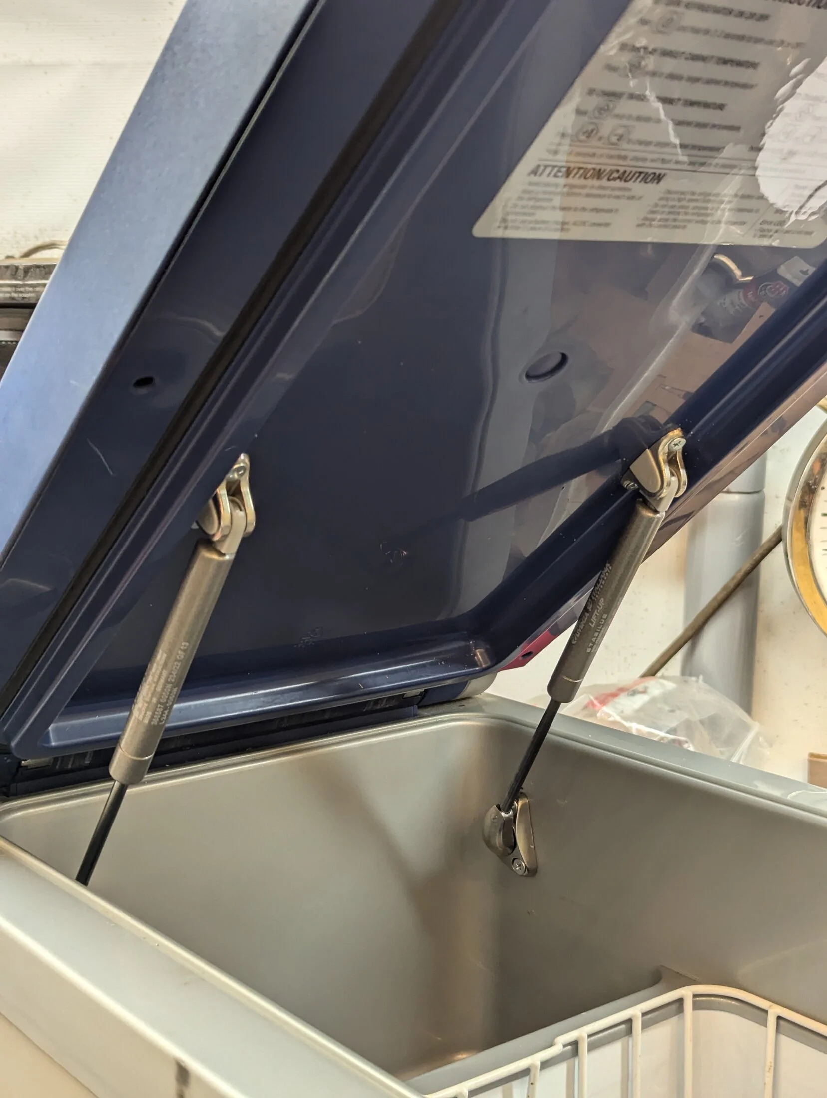

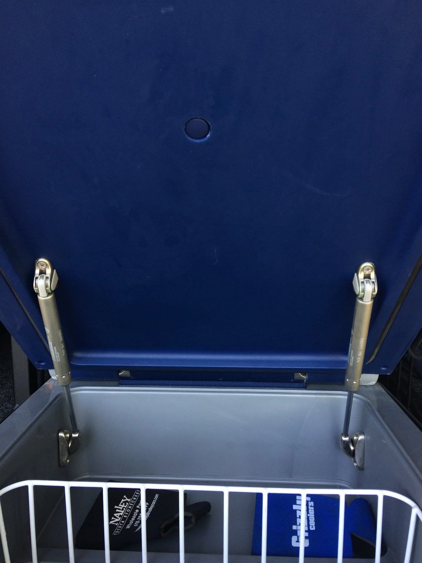

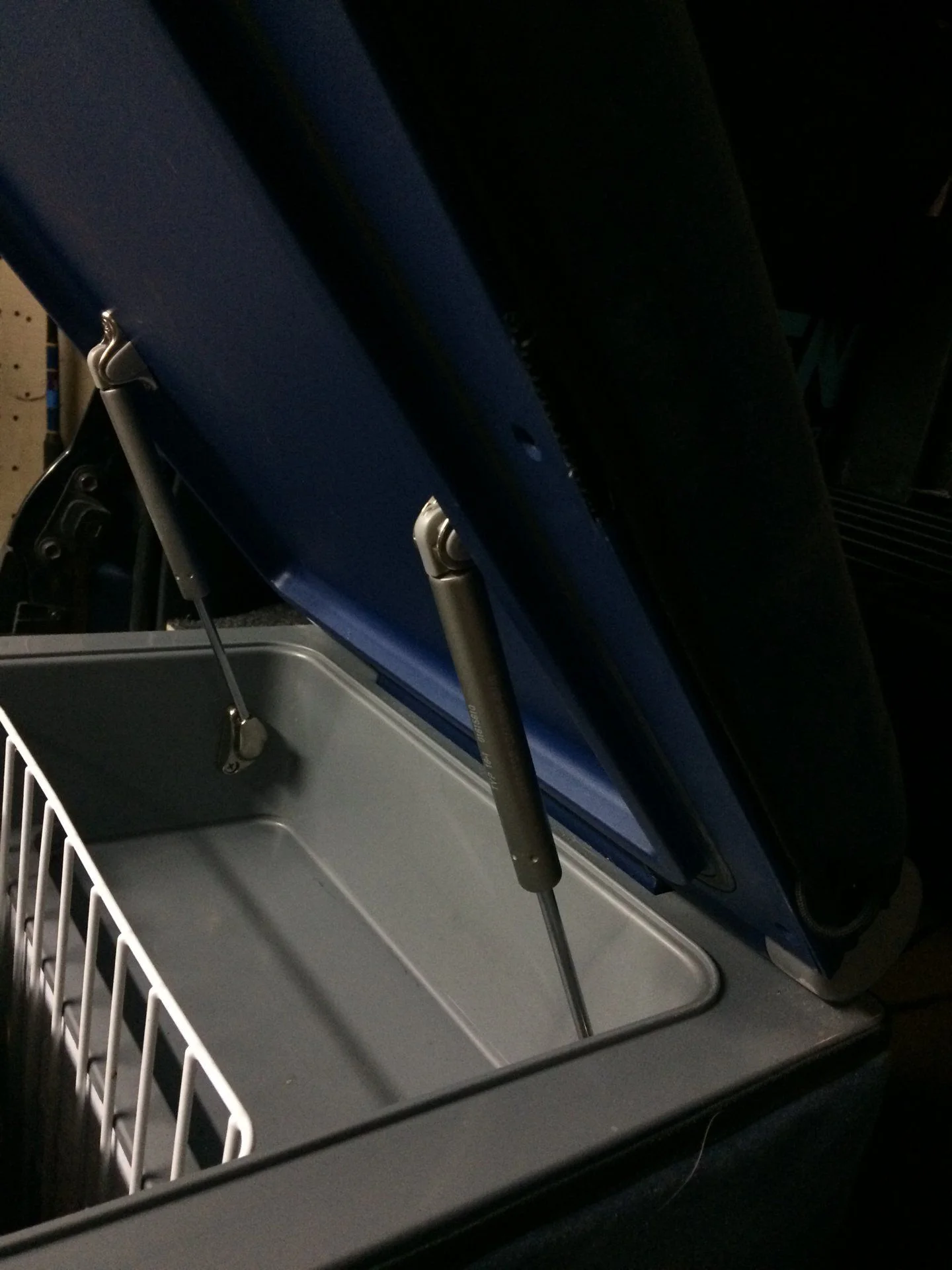

No more getting my head banged by the fridge door. Or having to hold it up with one hand while I sift through the fridge.
**** Update Sept 1, 2018. Sorry, I didn't post up the most recent update. I found that using (2) 50N gas struts for the 63qt is the ticket. The door doesn't come down, doesn't spring off of the hinges (struts are too strong), and doesn't flip up too hard and hit you in the face.
***New update Nov 15, 2024. I replaced the gas springs pretty close to 6 years. I open and close this fridge door several times a week, so this was a great return on investment.

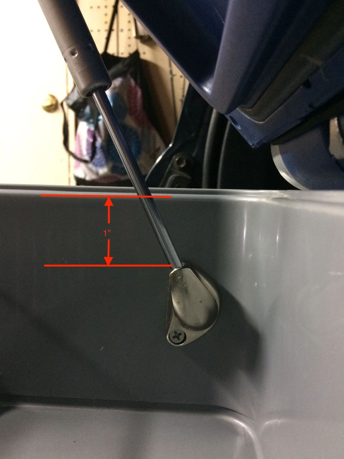

The moment about the point that the strut is attached to is results in a higher force then 11lbs. Mounting the strut further out towards the lip of the lid would have helped. (Try opening the fridge lid with a finger on the inside near the hinge vs opening it further away from the hinge and you'll feel the difference).
Yes, you are correct about that. The lever arm is much larger further away from the hinge.

I added another strut an it performs noticeabley better with equal pressure on the lid.
Nicely done Gil. Did you use self tappers or some other method?
I used the shortest, widest, stainless sheet metal screw I could find. Not much room behind the plastic. With 2 struts there is less stress on the screws.
