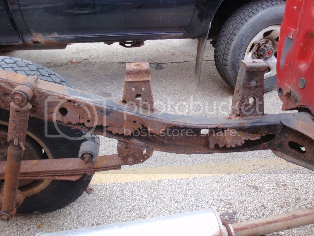

I have been searching for a Toyota to offroad with for sometime. Initially I was looking for an FJ40, however I looked for quite a while, and with my budget was not finding what I wanted.
Finally I decided on a different route, getting a pickup to bomb around in until I have more funds avaliable. So after that I found a 92 Toyota pickup on craigslist... It was a steal at 400 bucks! Good running condition. I got it home and realized the extent of the rust damage.
I began looking for a replacement frame. If you're not from up here in the bitter north, it's hard to find a good frame on that old of a vehicle. I couldn't find one close enough, but I did find an 85 pickup with the solid axle and a decent body, frame was shot and didn't have an engine, but did come with 2 transmissions.
The reason I needed a new frame:
:doh::censor::bang: I spent the rest of the after noon after this laughing...

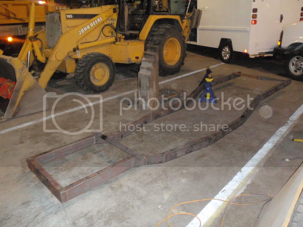

After surveying the damage, and not finding any replacement frame. I decided to build my own frame... :idea: Bright idea, right? It may not be the most time effective solution, but it will sure be beefy. Well, I am making progress... All 2x4 steel tubing 3/16 inch walls.
This is far from finished, those are just temporary cross members to help maintain the shape. I have made some more progress on it, but no pictures of it yet. Gotten the front spring hangers installed now too. I have already been working on this whole project for a few months.

Will butt welding square tubing hold? I am thinking you should fish plate all of the joints. I am not a professional welder by any means but you want your foundation as strong as you can make it. :meh:
It may hold... I don't plan on finding out... :D I will be welding over all the joints with 1/4'' plating. I am waiting for that until I have all the brackets and mounts attached.

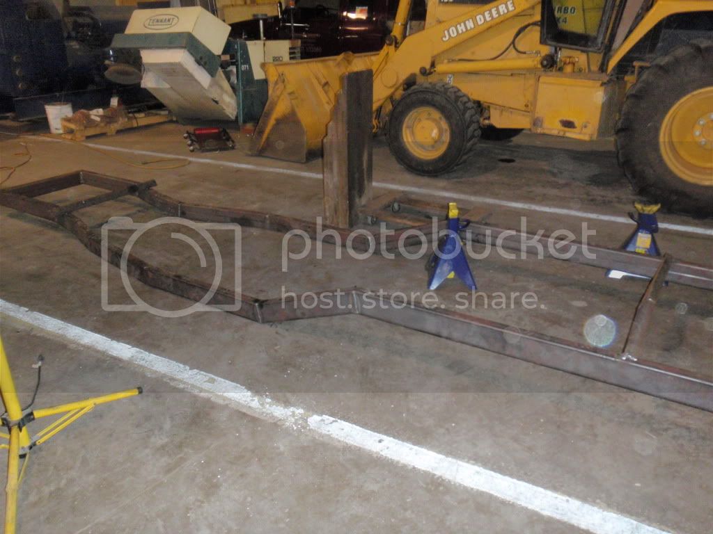

Yep, that is the route I took. Here is the frame I fabricated sitting next to my truck.
Looks like you used varying size of tubing. I thought about it... I still will probably add some bracing to the center section of mine since it's the shorter 4 inch height. What wall thickness did you use?
