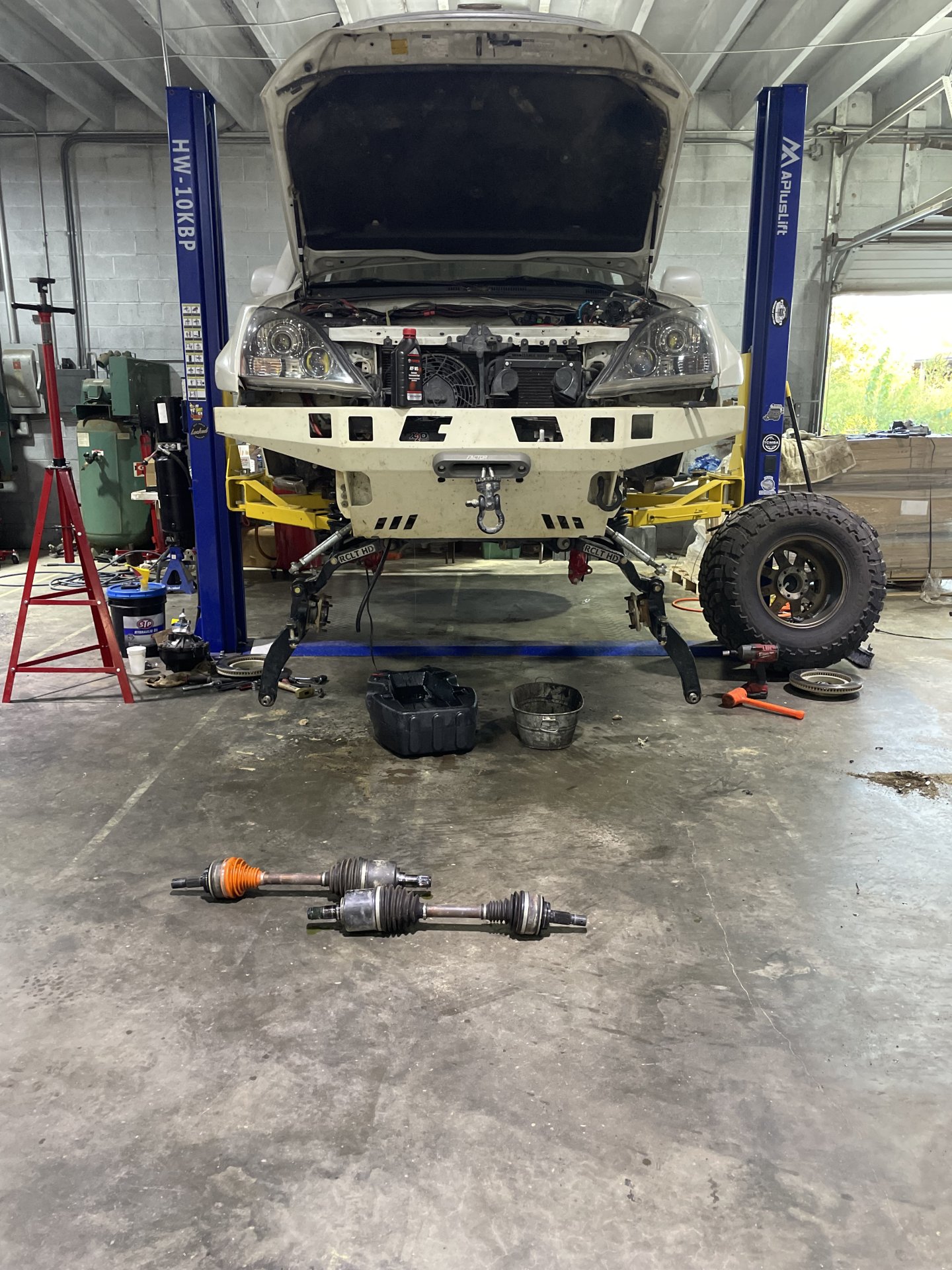

How reduced is the steering angle with this? Any pictures of the wheels at full lock? Obviously those uniballs are insanely strong in the upper and lower arms but it seems like it would limit the steering a ton. I think when I looked at building something similar for mine the max uniball angle was like 20 degrees
I’ve driven it lock to lock and didn’t notice any loss in radius. They spent a good bit of time on engineering the outer marrack links, mounts, length to optimize steering because the 200 series rack is bigger. I’ll get some pictures next time I’m with the truck.

Here we are some time later… I’m replacing the 200 rack again (I blame my initial install, which marlin helped sort after an extended stay in Cali). I’ve wheeled Rubicon, Windrock, ARkansas, KAT, and various other outings along with driving the truck to and from Cali for rubicon, South Dakota and back, Kentucky for numerous trips and all around the SEUSA just to say I’m very happy with the ride quality, drivability for long distance especially with the added range of the LRA tank, and the wheeling has been great. I followed 4link buggies on 40-42’s on rubicon and didn’t skip a beat. One day I’ll make the jump and chop up the body some more but for now I’m SUPER happy with the build and all it can do and still be a daily driver on 37’s.
@Franken470 what went wrong with the rack install?
Me… I didn’t clearance the motor mount adequately and had a few MM of running from the sector shaft to the motor mount causing stress on the steering.
it may have been you, but there was the same issue on Shannon's. We had to clearance and reclearance mine and hers. It isn't as easy as it looks as the sector shaft moves side to side when you turn.
Check the tolerance in your “rag link”… I found through some reading that the tacomas are known for going out and with the added stress of the things we do, I’d be willing to bet the Kevlar joint is bending more than it should. It’s a $100 part and will likely be a part that gets replaced more often with our setups.
Come on now. You think I would use an old intermediate shaft? :P Both trucks have brand new. It is the clearance at the axle with the repositioning of the bottom interface with the wider rack that gets it close to the frame and the bead of weld that sits right there. A little grinding is all it took.
