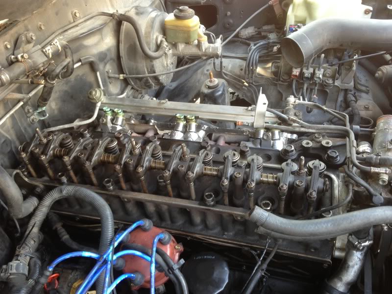

One thing noted, since a fair amount was taken off the deck, all the valve needed to be taken out a fair amount. They must have been pretty tight to begin with, (remember folks, valves get tighter) because none of the rockers would budge at TDC or 360 from TDC...
I also figured I would post a picture of this. I haven't seen a pic of this before, but this is the cover for my timing hole. It's just a rubber plug. I had a hard time finding this, til' I reached down there and found something "rubbery" and pull it out. So here's what to look for...
And this is where I finished off today.

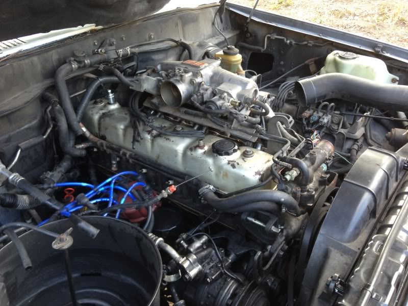

Well. Fart.
Got everything back together, and ran for about a week... Noticed I'm still losing coolant, and look at that...the oil is white, and the level is up again.
So, I'm putting this project on hold. I'm gonna attack my '87 XL600R so I can have some wheels for the time being.
Not sure if I'm gonna just part 'er out, or see about a full rebuild. I'm still gonna bypass the oil cooler to make certain that is not the cause (would hate to see that it was after all this) and double check those freeze plugs. Not sure what I could get out of a parted out 92...
