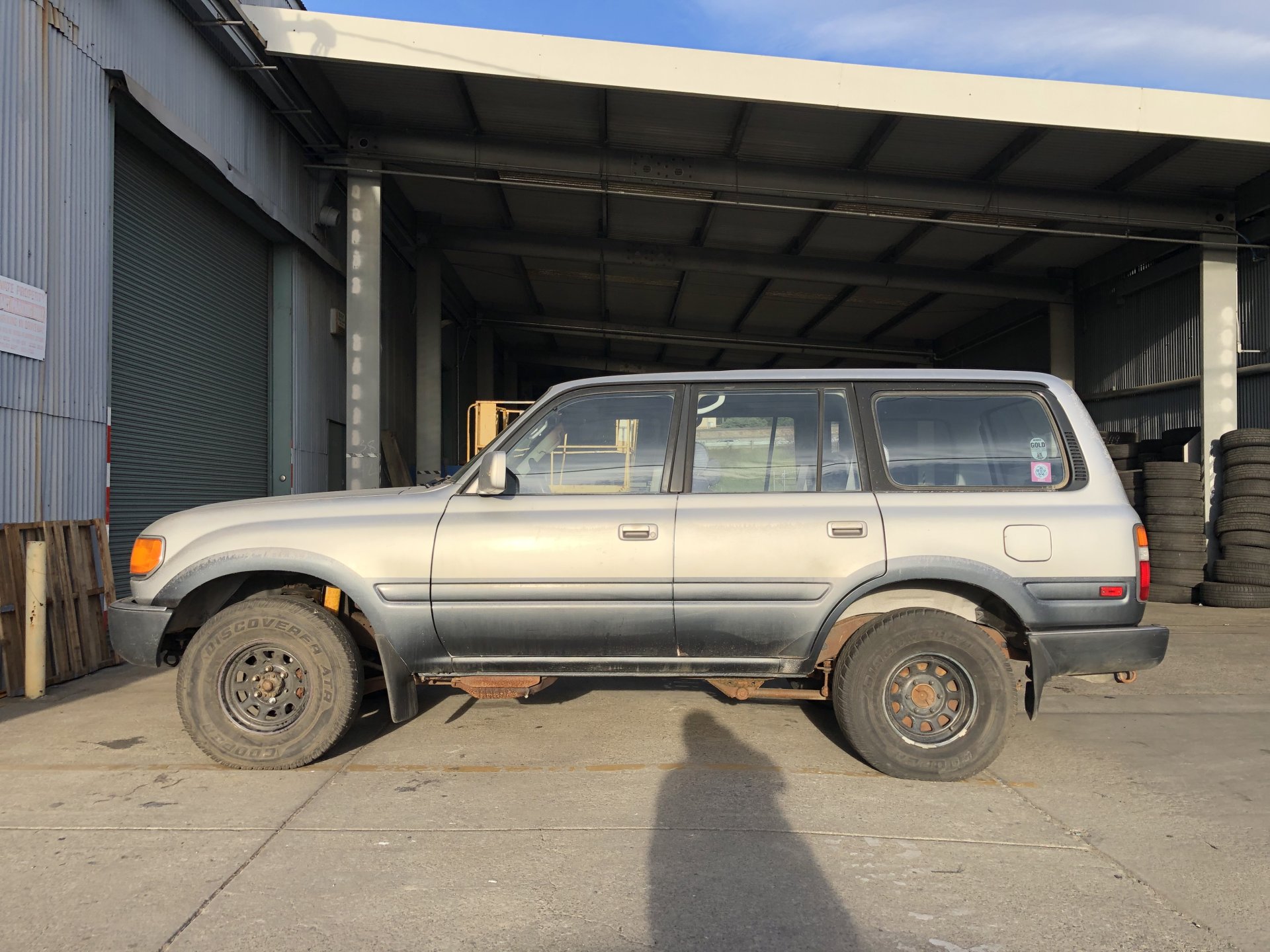

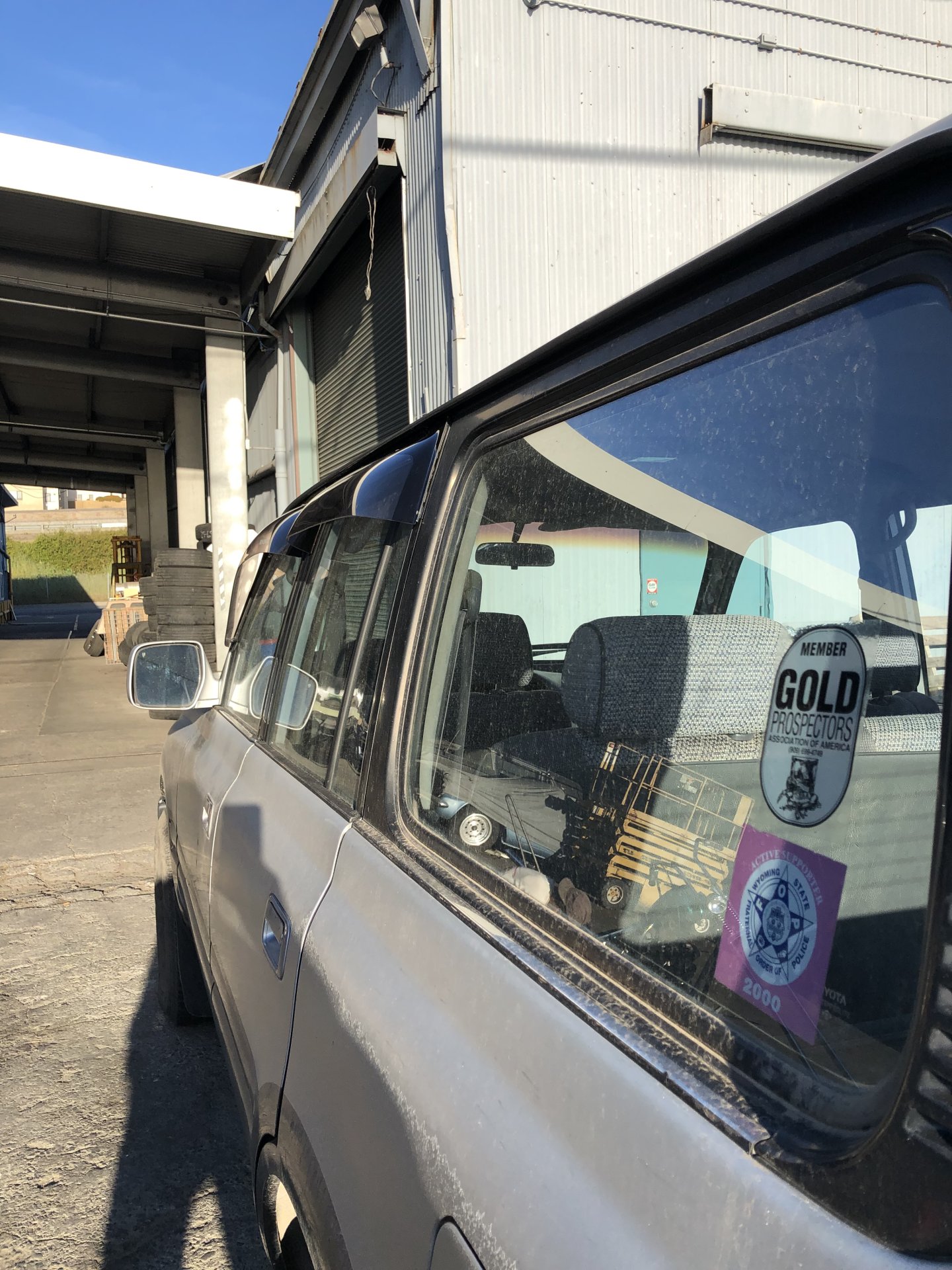

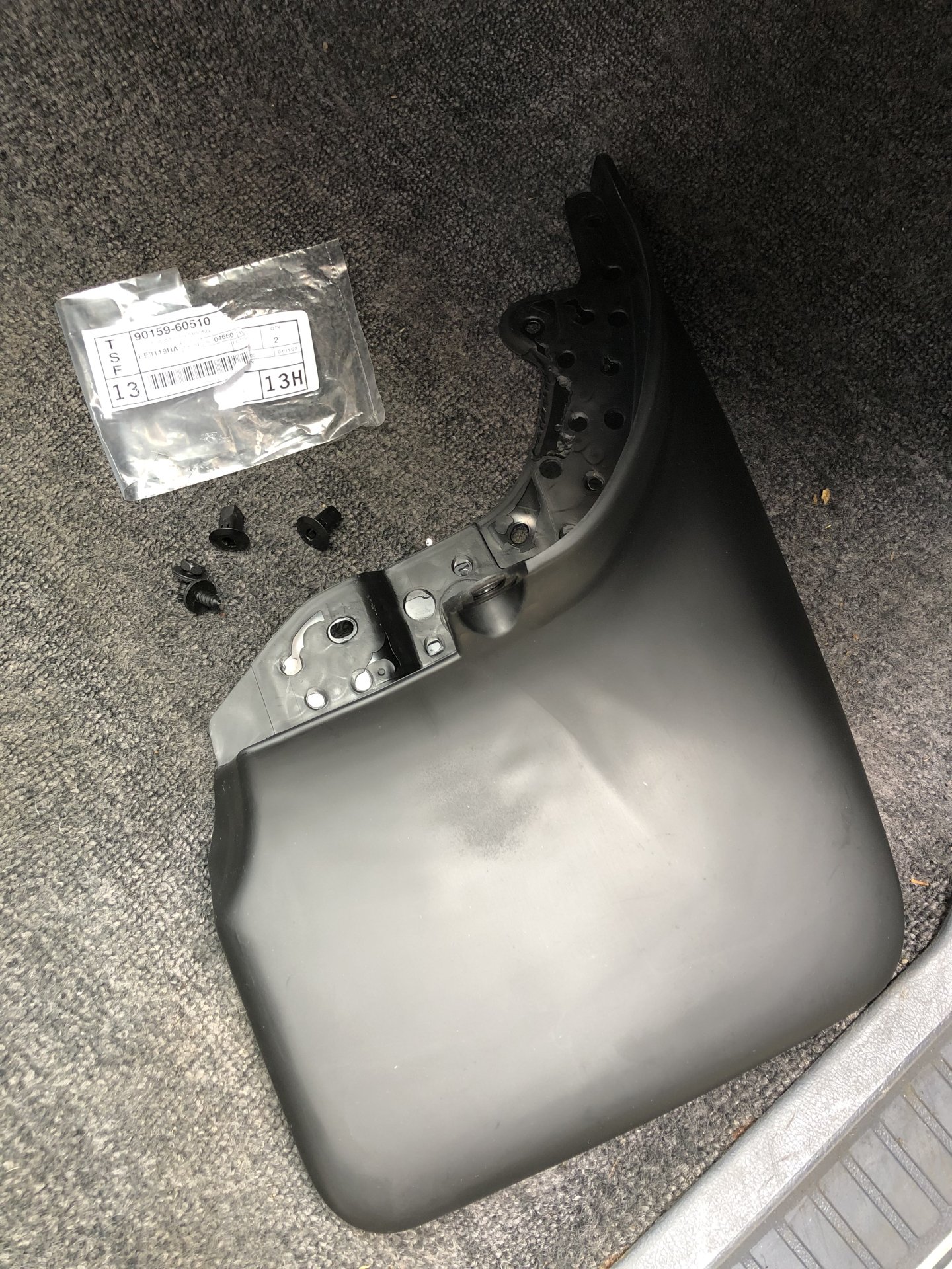

Located a set of Toyota rain guards from Japan. I tested them on my 40th and they looked nice but was curious what they looked like on this one. Going to be painting the vehicle soon and wanted to test everything before new paint.

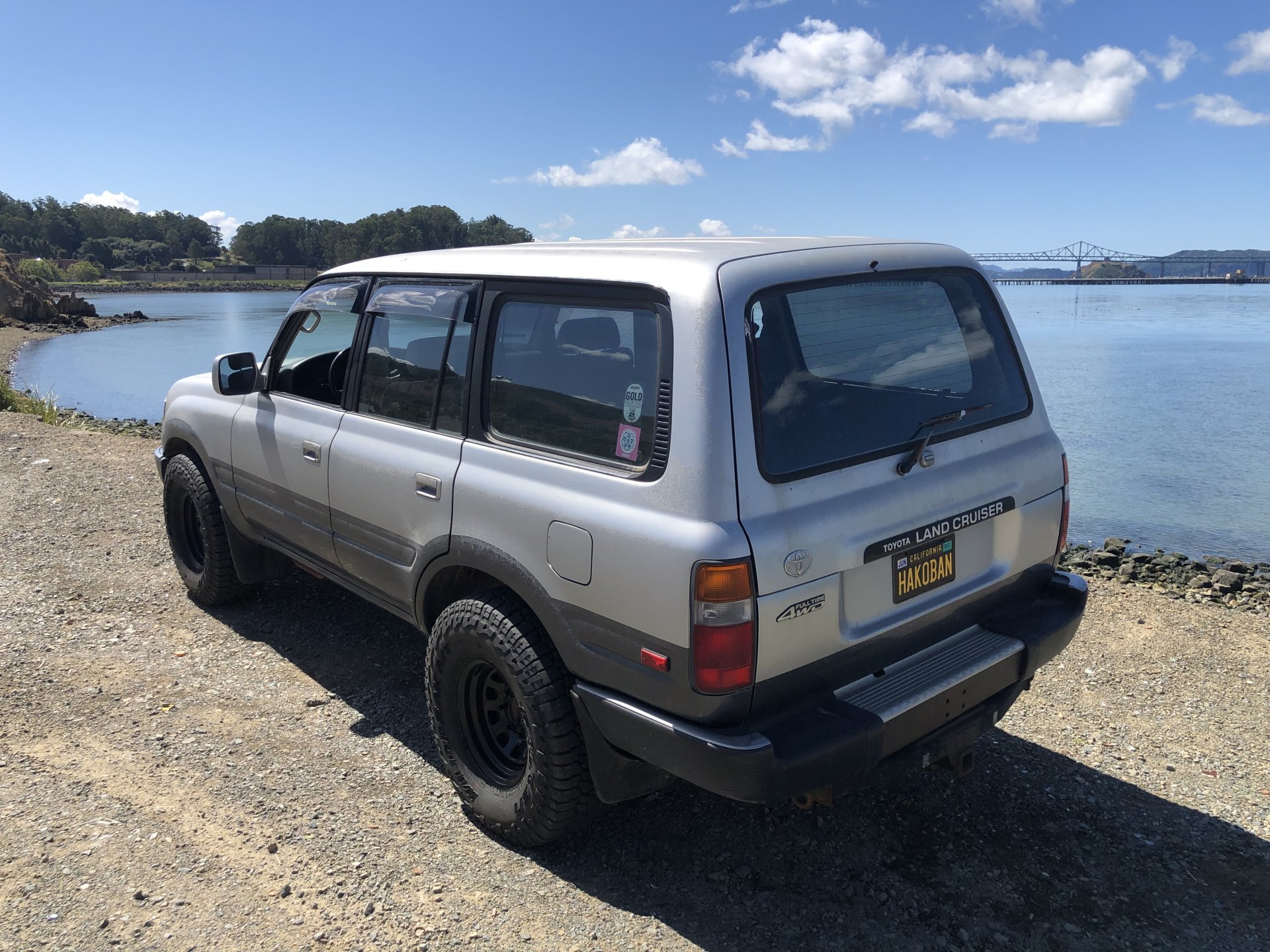

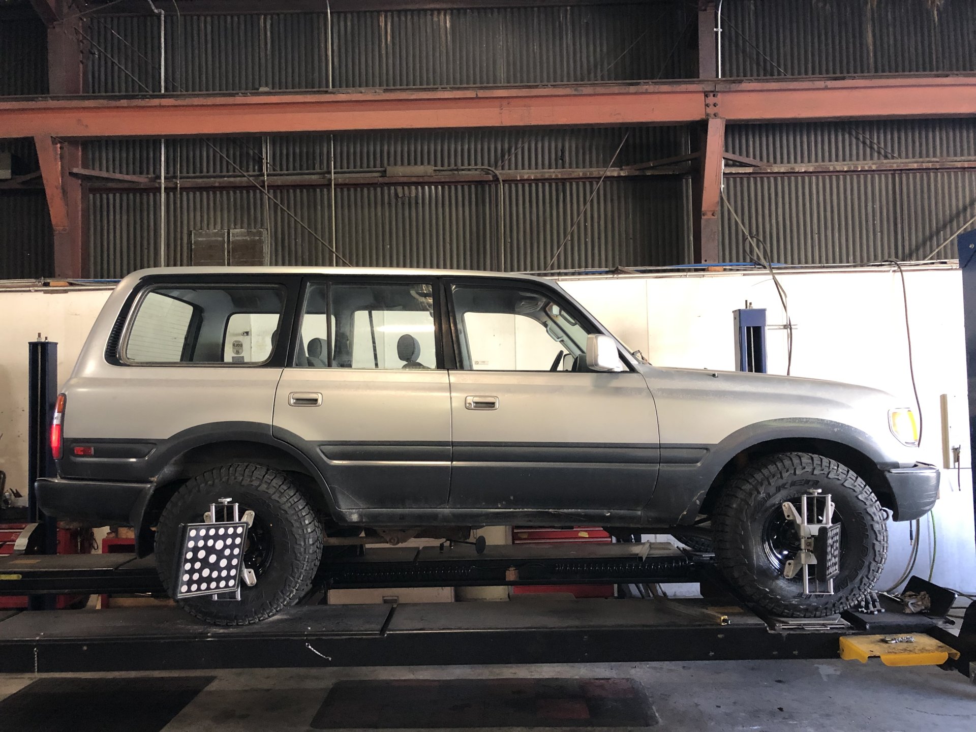

I currently have a set of 15x7 (265-75-15 -0 offset) on there and they look pretty nice. After looking at it for a week or so I’ve decided I like a little taller tire. The rear on this pov sits a bit taller in the back compared to my other LC that are fitted with rear seats etc.
Photos for ref.

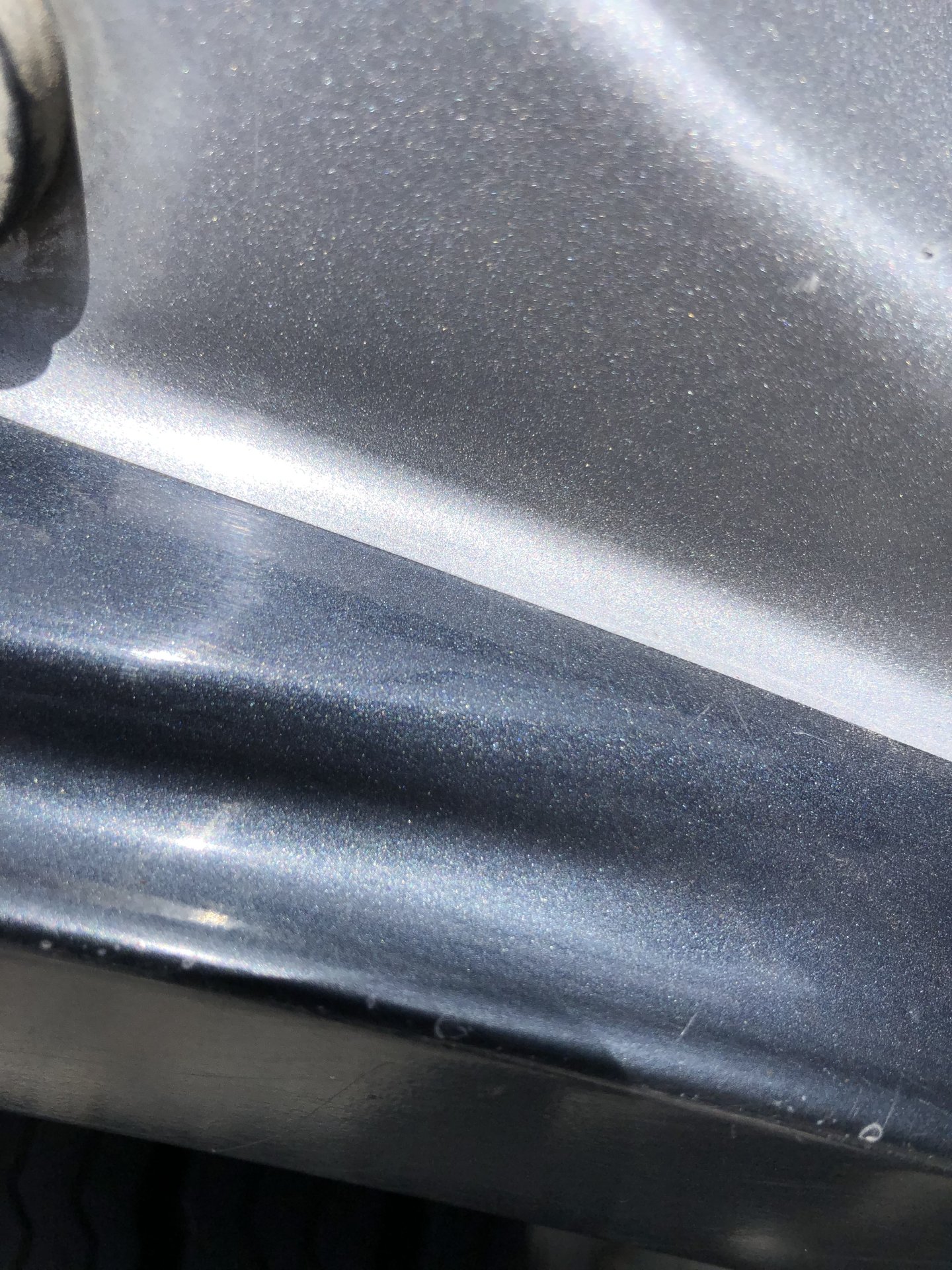

Next in order is paint. Part of me wants to paint it the original silver without the lower color. But cleaning off a section in the door jam you can see how cool it looks with the lower color. Either way it’ll look good. Picking up paint next week. Now to find OE window rubber so I can do a window out paint job.

Did you get just 1 mudflap, or the whole set of 4?
I have all 4 NIB if you need them.
