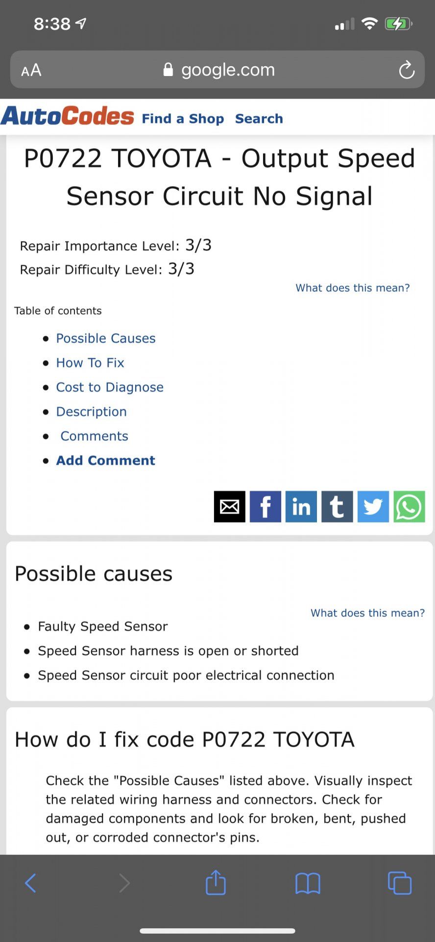

Great news on this one, kind of. It has done it again. Same return trip from Fort Smith and coasted to a stop within 11 miles of where it stopped last time. Wrecker hauled it in, wife is PO'd, and the dealer called and said it actually threw a code.
P0722 Output Speed Sensor Circuit No Signal - Permanent
The service tech did say that code renders the vehicle undriveable and requires an unlock code from corporate to reset it. He said the sensor is likely bad and must be replaced. He said if they clear it now it will just come back. Hopefully this leads to a path of it really being fixed.

Here is the one thread on that code specifically I could find, though it's not the 8 speed. Certainly not common.
