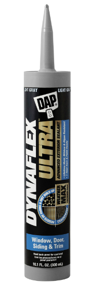

I have a Gamiviti rack and it was recommended to use DAP Dynaflex Ultra...no leaks and super easy to use!

On your website, you recommended PL Loctite Polyurethane Roof & Flashing Sealant. Do you still suggest that product? Or should I stay away from loctite to reinstall factory roof rack?
I have switched to Dynaflex, which is a little more readily available than the product made by Loctite. But both products are very similar in being a non-hardening polyurethane, window and door type sealant.
don't confuse that with the thread locking Loctite, which is what is being discussed here. totally different product. I don't use the thread locking stuff, just the window and door stuff. There's confusion created when folks call thread locker "Loctite" as if that's the only product they make...
Sweet! That's exactly what I needed to know.
