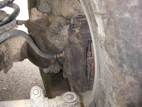

You made me second guess myself but yes, I found a picture so it is true. This was a line I borrowed from Clutchee at GSMTR. I replaced it asap with a new banjo line when I got home, but it worked for a week or so. definitely easier for a field repair.
WHy replace it? Banjos are notorious leakers. Gotta have the perfect sized brass washers at like 12 ft.lbs or torque or they leak...

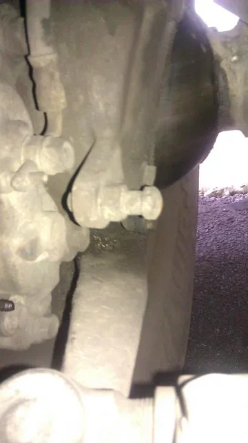

just snapped a picture of mine, looks like banjo:
I'm a little confused then. Not all ABS lines to caliper are banjo.... are they?!
