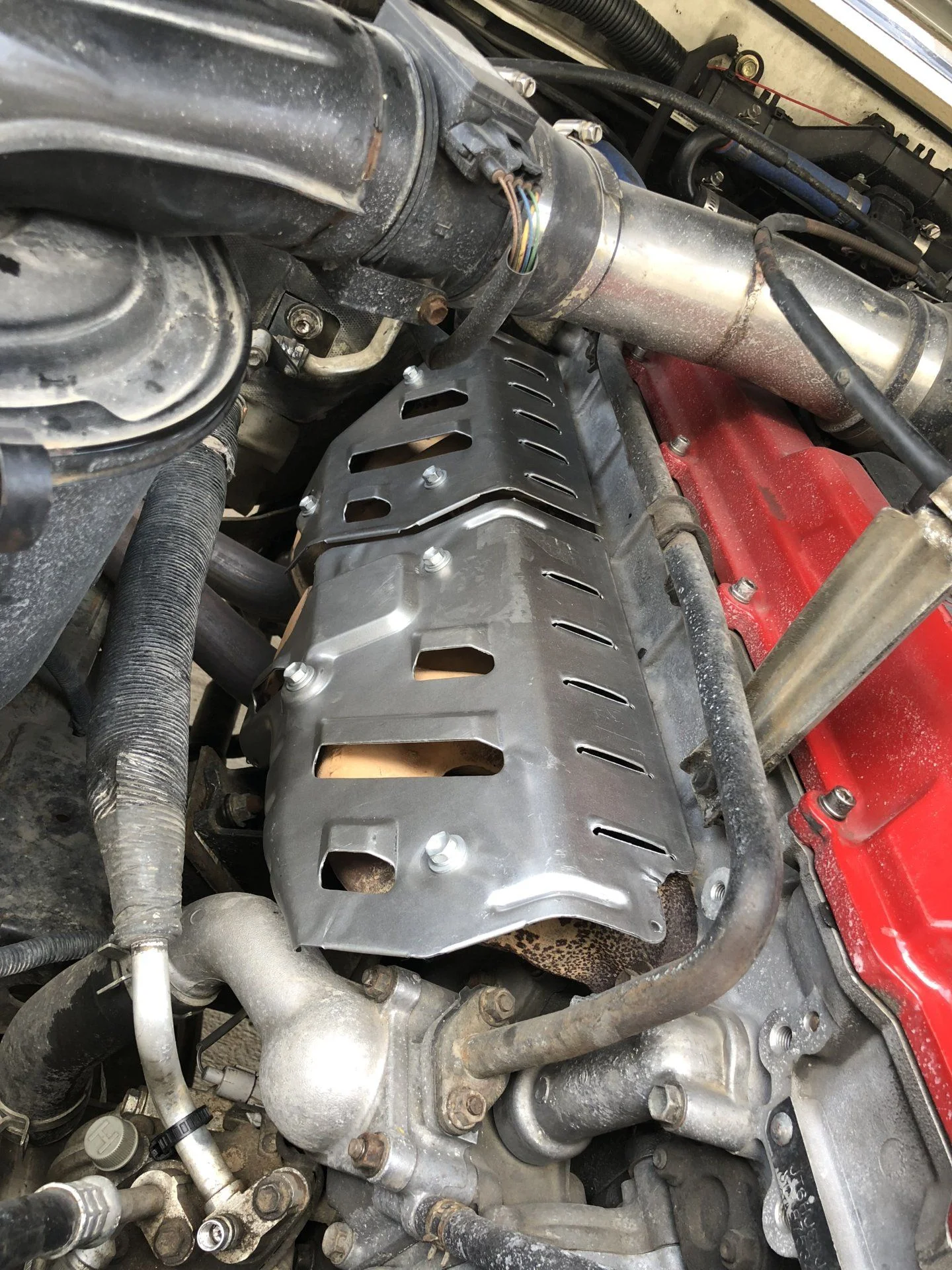

Nothing exciting but replaced the hood insulator that was hanging down into the motor and also put exhaust insulators on. Neither one was cheap by the way.

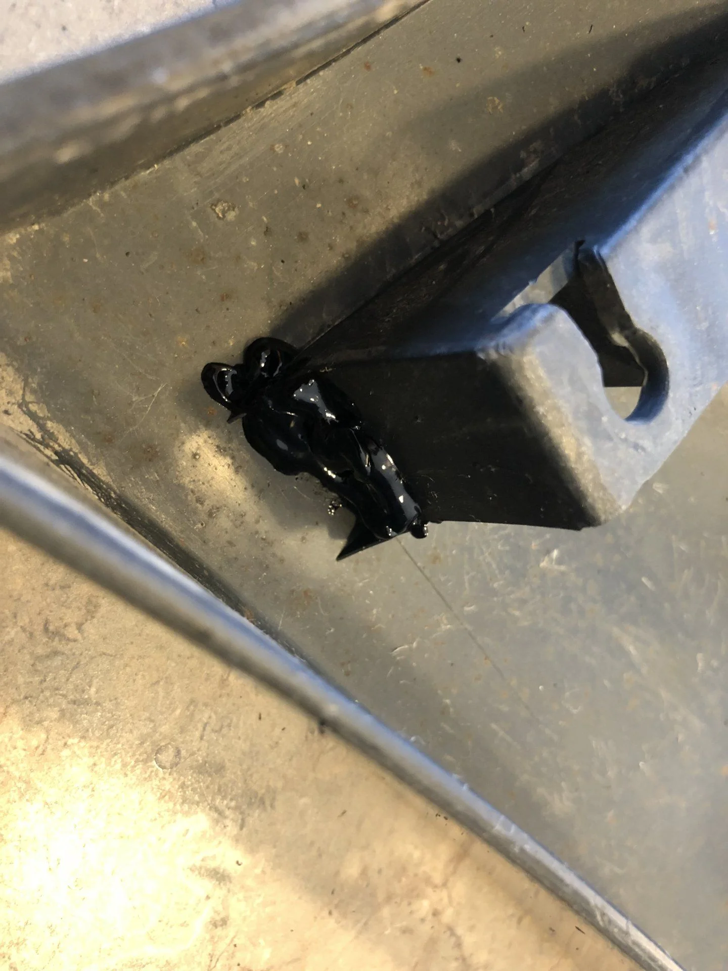

Been working on the fender flares. Had a couple of broken tabs. Read about a 3M Plastic Repair glue and thought I would give it a try. Sanded the areas and applied a couple of coats to build it up. The repairs are strong and seem like they will hold good. Easy fix so far.

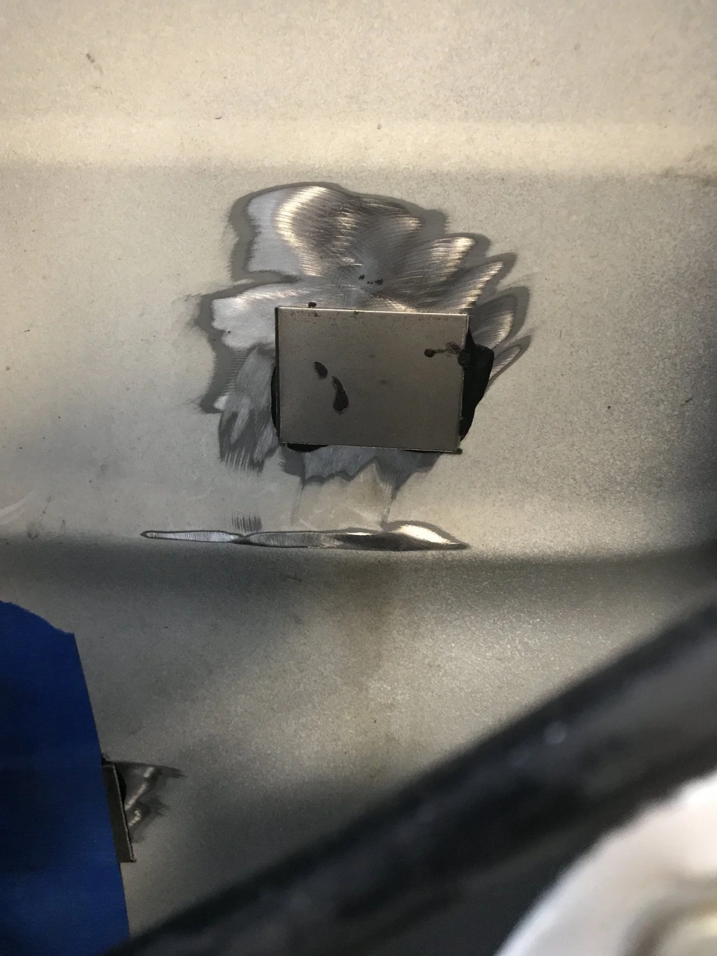

Posting this here too as I have referenced the process we used to fill the holes left behind from removing the cladding on a couple other threads.
We used a 3M Panel Bonding adhesive and glued stainless steel squares over the holes from the inside. Once cured, we sanded down any of the 3M product that stuck out the hole and then put body filler over that. Worked really good. We also ground down the nutserts on the roof for the roof rack and filled with the 3M product and then sanded them flush and applied epoxy primer over that.
