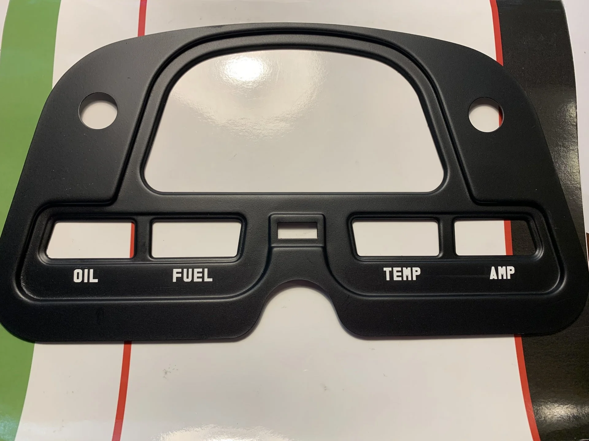

I've searched for an hour in FAQ and trying to use the filter to no avail. Can someone tell me who the resident expert is for gauge cluster restoration?
I need the labels for OIL TEMP FUEL AMP and the old school Letraset dry transfer method was a miserable fail. Anyone have any advice on a solution that looks OEM?

I tried for a while and gave up trying to find something I could purchase premade for this.
I have been working on this custom solution for a while and have found a way to print these onto the bezel. It is a custom printed dry letter set that look like paint when it goes on.
Its tricky to put on but looks fantastic. I am hoping to sell these restored surrounds.
Let me know if you interested I can make you a deal since your my first customer. 😁
Looks great. My Bezel is painted and ready to go. I tried doing the Letraset dry transfer one letter at a time and that was a disaster. How much for the dry transfer printed set? I want to use my bezel as it took a while to find the ultra flat black paint to match the gauge cluster. Let me know what you are offering.
If I recall, I used Helvetica Medium and compressed it, I don’t remember how much, just til it looked okay. I used a basic 3M white vinyl cut on a plotter.

Many Thanks to @JVZii for the lettering kit. Very pleased with the result and his letters are spot on. His kit is the only way to go in my book! 🙏:cheers:
