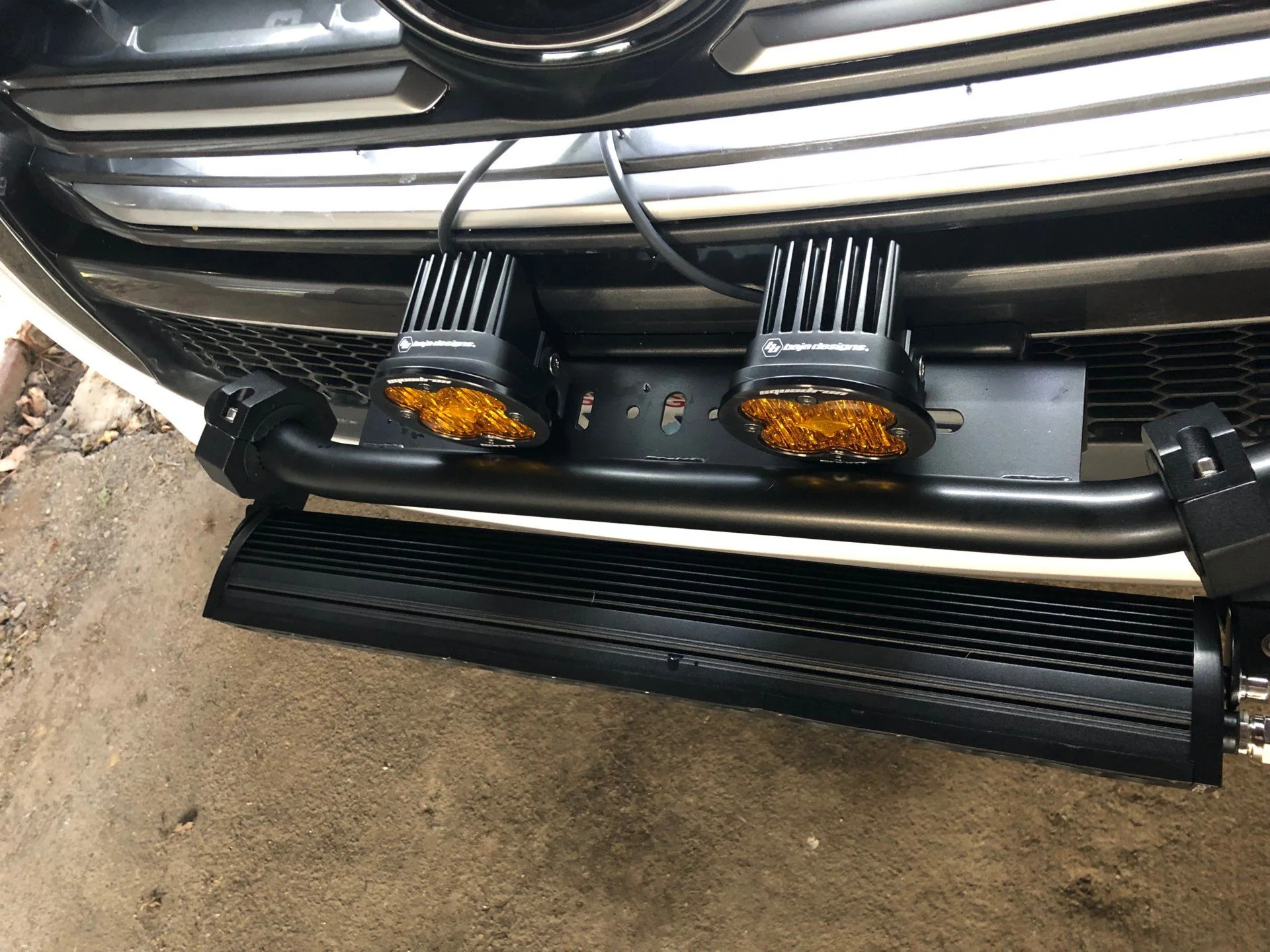

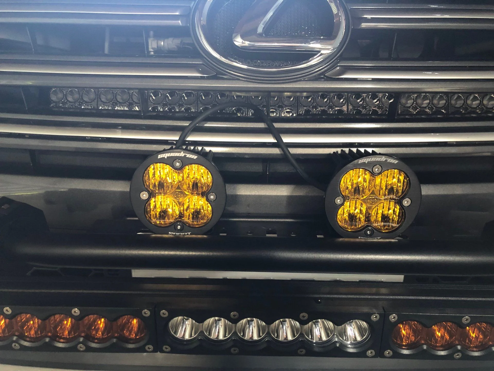

I will be using the set up I had in my GX460 for now (pics attached).

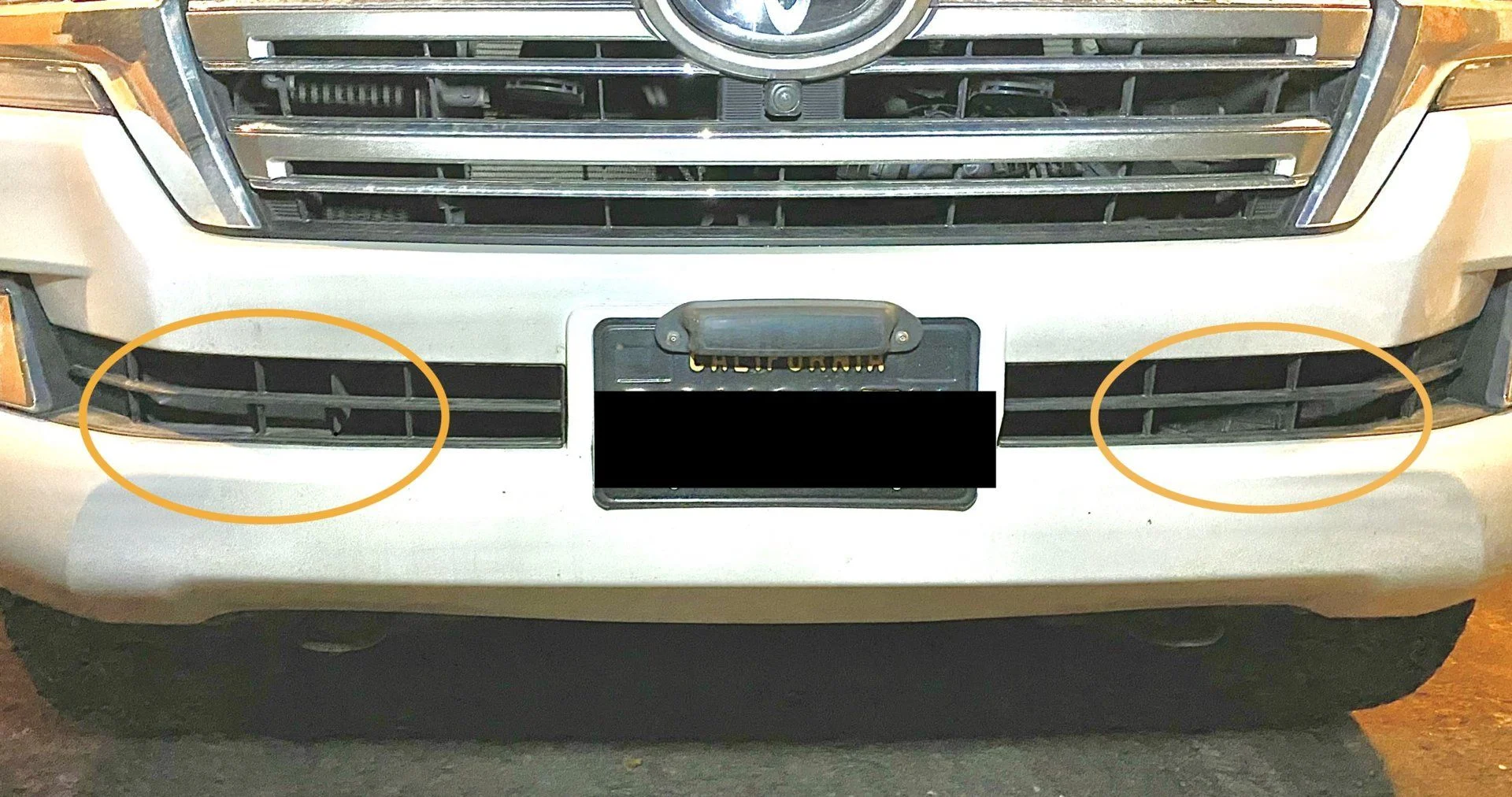

But looks like the 2008-2015 200s have a bigger fog light area to work with. I love lighting so will be figuring something out for fogs and other aux lights too.

And here is my current solution, will be replacing with amber ones when they are delivered:
Oh wow, that looks sweet from RIGID but I also prefer amber for my fogs. I also like the set up you have now as well on the grill. Thanks for the info.

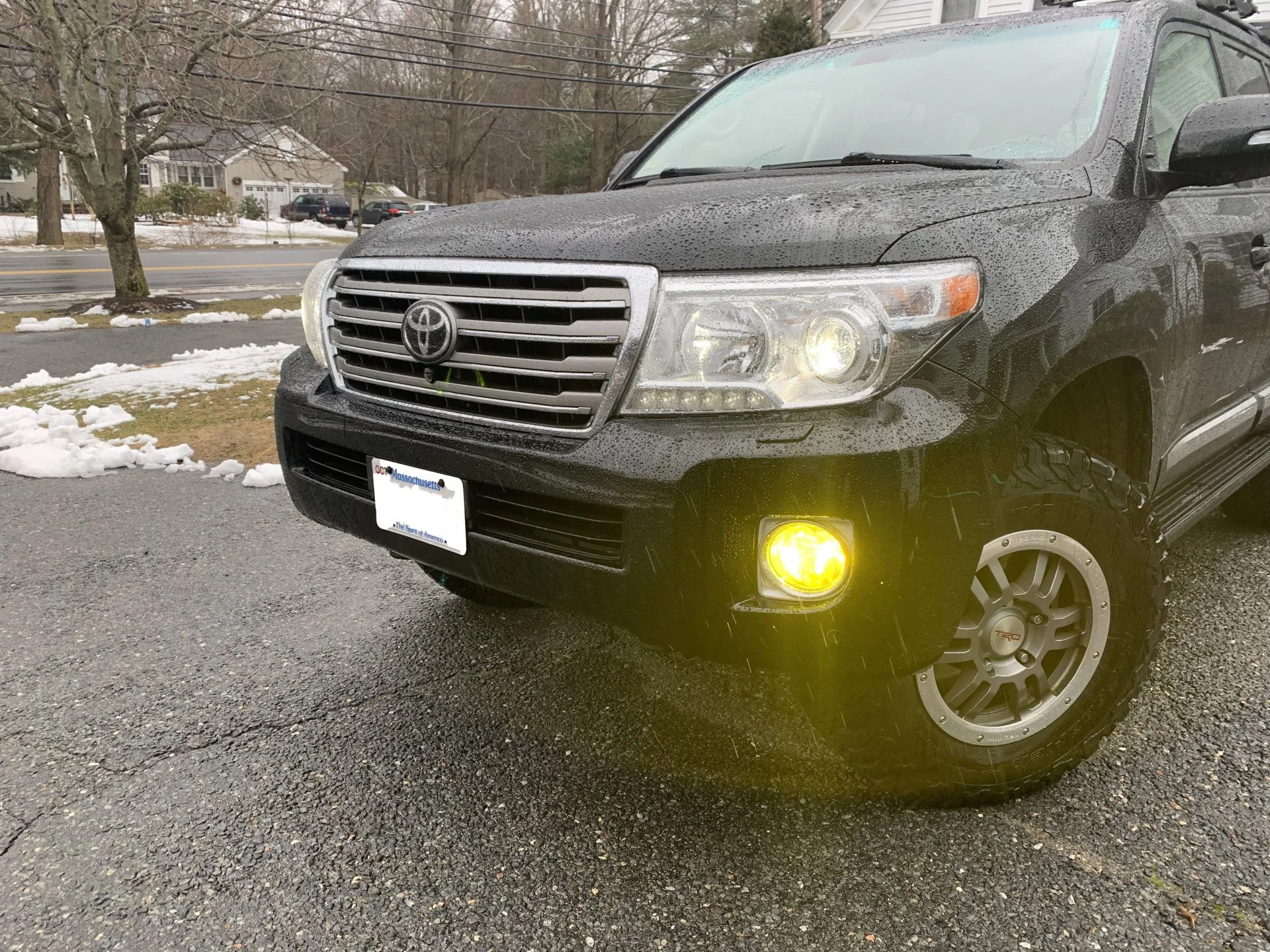

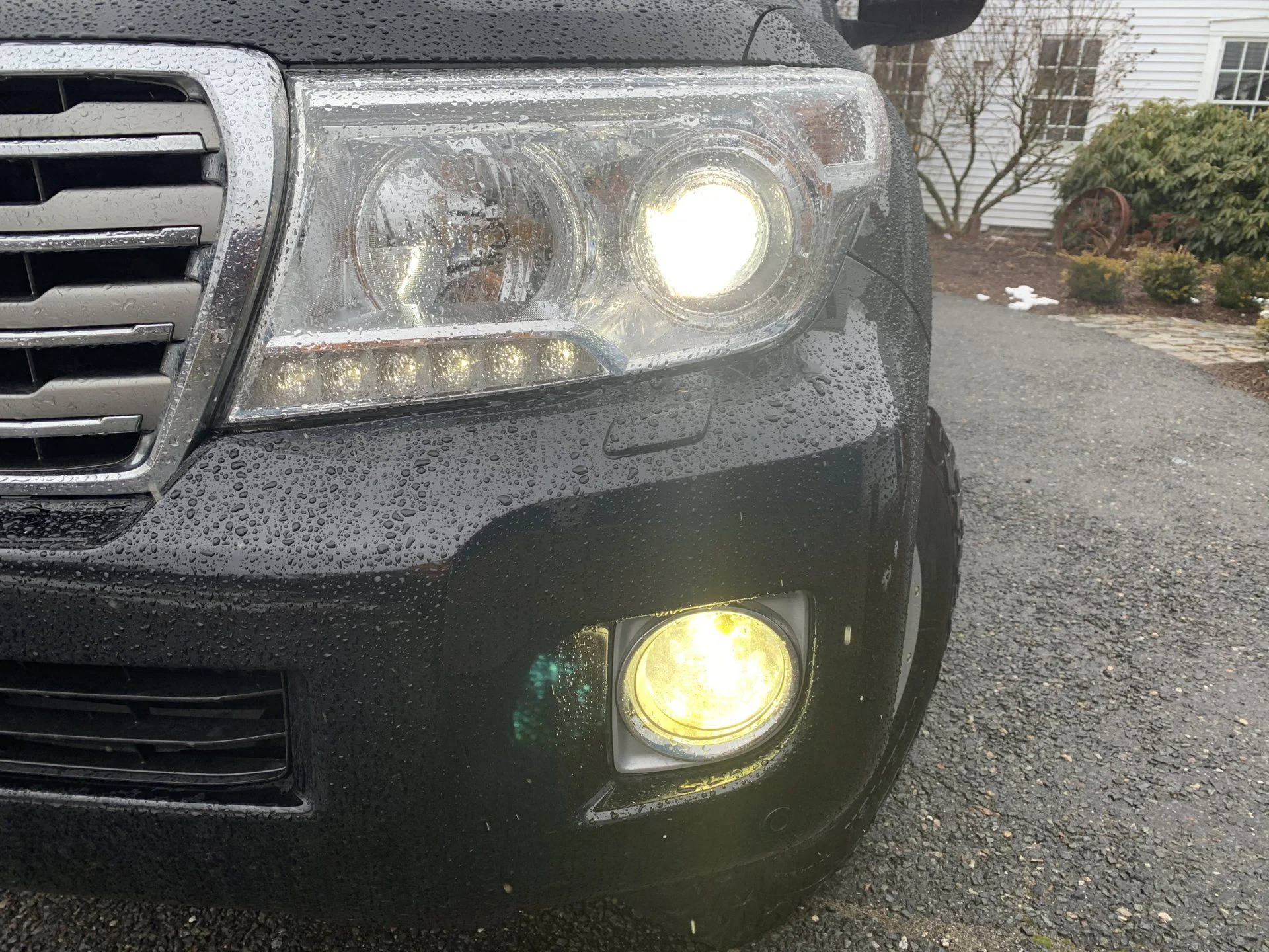

UPDATE: I got the CaliRaisedLED's and took the day Sunday to get these installed. I can tell you that getting inside the bumper and changing the bulbs is a serious PITA. Not sure who at toyota desired to make this such as task, but it isn't much fun without taking a bunch of screws and body clips out on the driver side. the passenger side is easier by far. To be fair, this is for any Fog bulb access, not just for this kit. These fit on my 2015 LC based on the fitment notes above. I cross-referenced the 2015 Fogs on the LC with the 2015 Tundra. As noted above, they call for the same H16 fitment, despite the kit being marked an H11. From my reading, the H11 and H16 are the same physical fitment, just a difference in wattage. the H16 fitment calls for 55 W and that it what this kit is.
Ok, but on to what you really want to know:

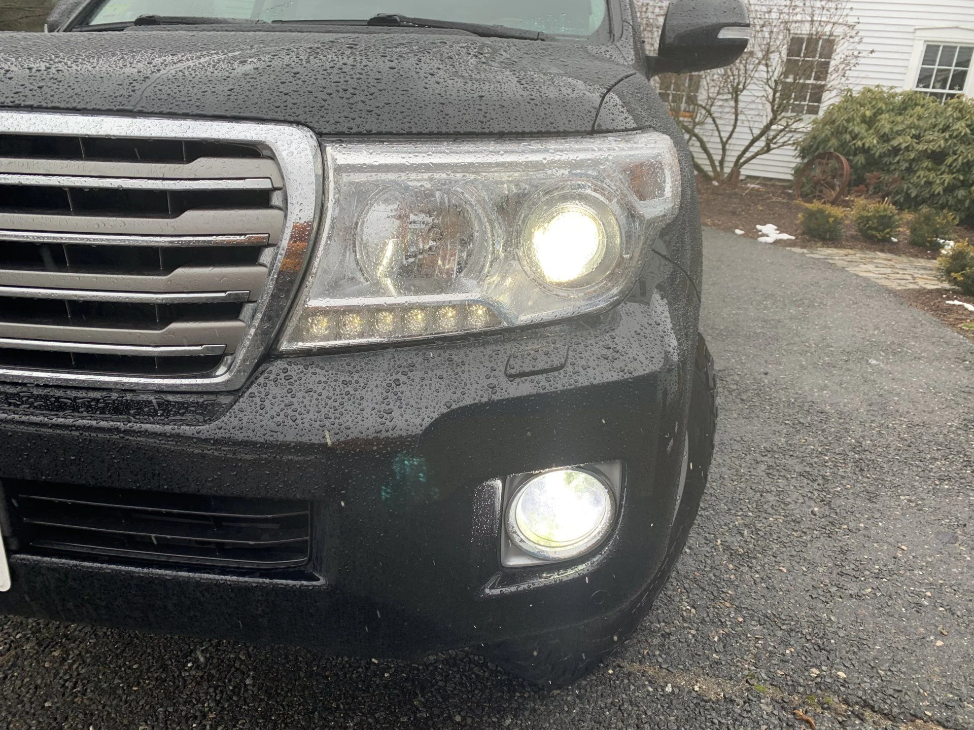

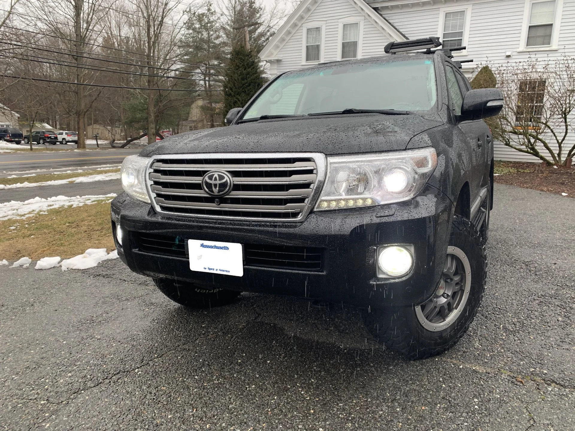

THEY WORK. Yep, they work great. The white color of the first setting is a match to the LED temperature of the Low-Beam projector on my 2015.
I had an opportunity to test drive them yesterday coming back from skiing in NH, and they did great lighting up the sides of the road, past the lines - in fact well past the lines and into the sides of the road on both sides, which for me is critical for spotting wildlife making a run into the road from either side. This has been a principal concern for me driving back country roads in the darkness of the early evening here in the winter. I didnt get flashed by anyone on the road in my tests and I ran them on the highway as well and paid particular attention to the vertical cut-off of the light on the vehicle a stopping distance in front -- which appears to be about the same as the Low-Beam projectors. So I don't think that these are throwing too much light up. I recognize this is a function of the lens and not the bulb, but with the increased brightness, i though perhaps this might be a factor. doesnt appear to be an issue.
Here are the lamps in the daylight in all three modes.
(Yes my plate has 570 in the number, but it's a pure coincidence. It's a Land Cruiser.)

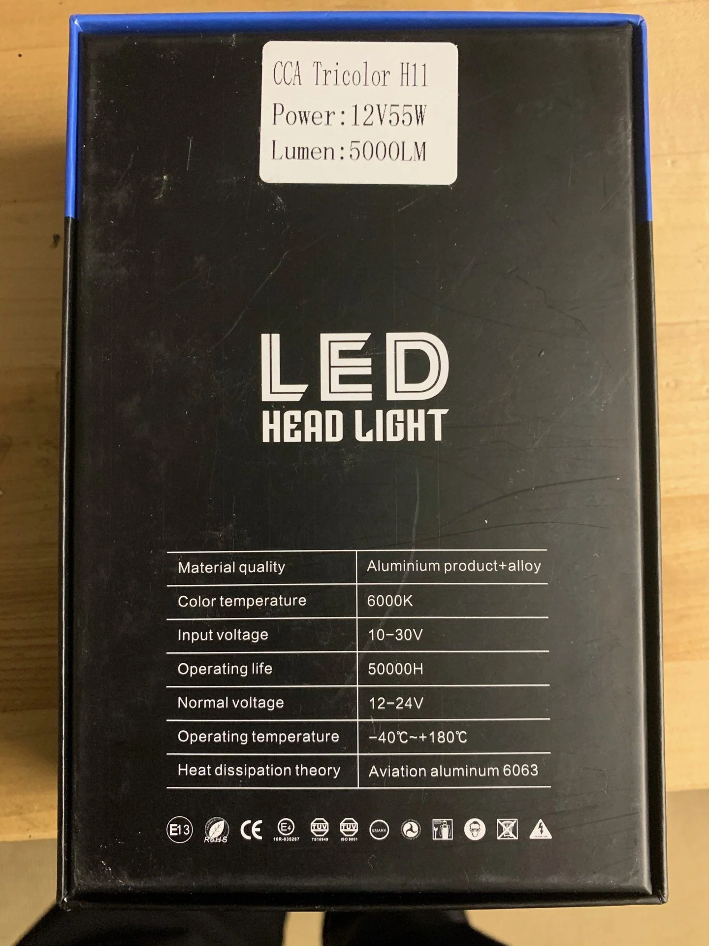

The kit is advertised on the website as 7000 lumens, but the paperwork I got said 5000 lumens. the Box shows the following: CCA Tricolor H11 / 12V55W / 5000 Lumen. Here is a picture of the back of the box with specs:
OPERATIONS: Having the ability to swap to yellow on the fly is really cool... the yellow on snow-covered roads add good dimension and depth. I am sure this will be the same for gravel and dusty roads too. The 3rd setting of a combo yellow/white might also be good as compromise for both, and seems to be a bit more dim than the plan white alone, which might be useful if you do get some oncoming flashes. this color seems to be a bit closer to the factory bulbs I had, maybe a tad brighter, but even if the same lumens as the pure white, seem dimmer (likely with the addition of the yellow).
