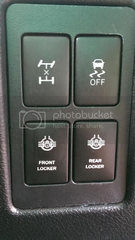

Anybody found an OEM Toyota switch that fits the factory URJ200 dash blanks? I've seen a variety of aftermarket options but I could swear I've seen an OEM one but can't find any record of it in my notes?
Fwiw here are a couple, pretty sure these are the same:
imageuploadedbytapatalk1375022365-957854-jpg.225485

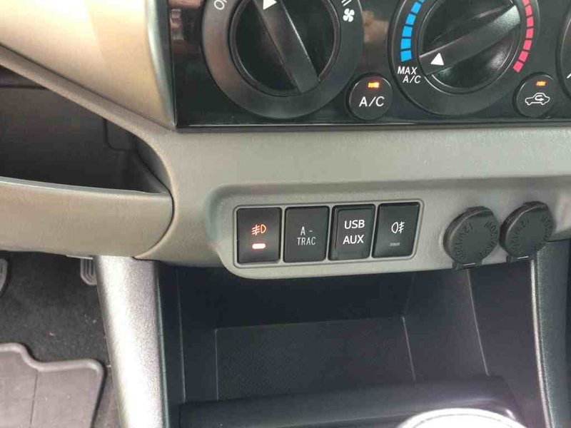

My TJM front bumper fogs came with one. Try looking at what they have to offer. Looks just like the switch on the far left of your pic.
I agree that the 23mm x 33mm appears to be right. I'd love to get a rear fog and a DRL switch of the same and wire up the rear lenses and front LEDs...
I've seen the Slee one, and that will be my go to if I can't find an actual OEM option. There are some Toyota dealers in the SE region that have a fog lamp kit which includes the switch and a harness, I can only assume it's an OEM option they are able to source from over seas. Fwiw there are a grip of options on eBay, different logos, etc. The Slee option comes with a nice harness and we can be assured it's a decent quality switch which can't be said for the eBay variants.

The switch you need Kurt is: 00016-32230-02 This is the SE Toyota regional accessory switch for all truck fog lights.
These are only available from SET Dealers (So basically, GA/AL/FL/SC/NC). About $25 or so.
Looks exactly like the one you are looking for and will fit with the 200 series interior scheme.
