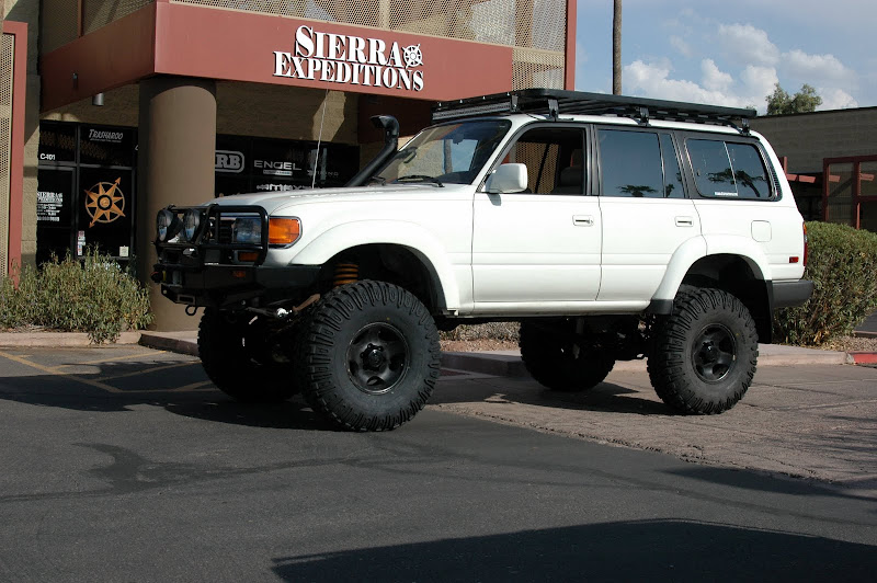

Here it is all installed:
While the 80 was on the lift we did not see any major rubbing issues to be concerned with... so out to the lot we went to see where it would rub. The rear hits just slightly.
that is a super clean looking rig. the same suspension setup i am looking at. good work.
^Yes of course.
Looks good, and I like your taste in mods, but man that thing sure needs some wheel spacers and longer control arms!
Looks a little off with the wheels no longer centered in the wheel wells. Do you have any plans to correct for that?
