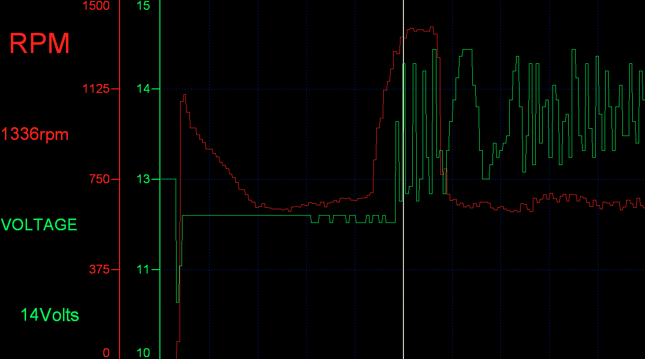

This is a reading from the OBD2 port (above voltage reading are all from a multimeter directly at the battery)
The strange thing from this reading is that the alternator seems to do nothing at idle. Only when the RPM is raised the alternator kicks in at around 1250rpm. After that the alternator stays on even when the engine is back at idle. (but it is fluctuating)

I'm very happy with my Denso remanufactured alternator from RockAuto. I'd replace the alternator and test the battery. A bad battery is hard on an alternator.
Or you can just replace brushes and voltage regulator and save a boat load of money, that is what usually dies VR and brushes
Sounds like the bearings are noisy too. You will need to replace those. I would rather get a reman Toyota or replacement Denso alternator.

Bad bearings making you lose constant contact with the brushes
I just went through this. A reman Denso unit from RockAuto with 1 day shipping was $158, including the core fee. A new Toyota voltage regulator and brush holder without shipping was $160. Easy decision.
I went to a local Auto electric battery place and got both for about $30
I've got the alternator tested at a shop and it was indeed the culprit. Because it was the original alternator i've got it remanufactured and I just put it back in. A steady 14,5 voltage, no more battery discharge light and no more flickering lights!
