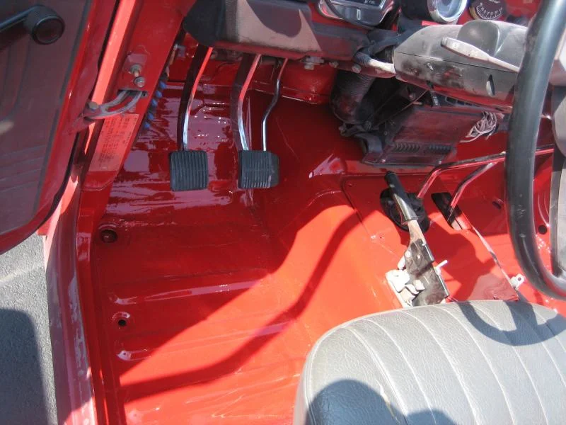

Delayed followup here, now that I finally got around to replacing my rotted out floor pans. We used a combination of spot welds and a continuous bead of 3M adhesive, which according to the specs is stronger than the traditional weld-only procedure. That adhesive is expensive as all get out, but supposedly lasts forever. I think it was $60 a tube. A couple of pics...
