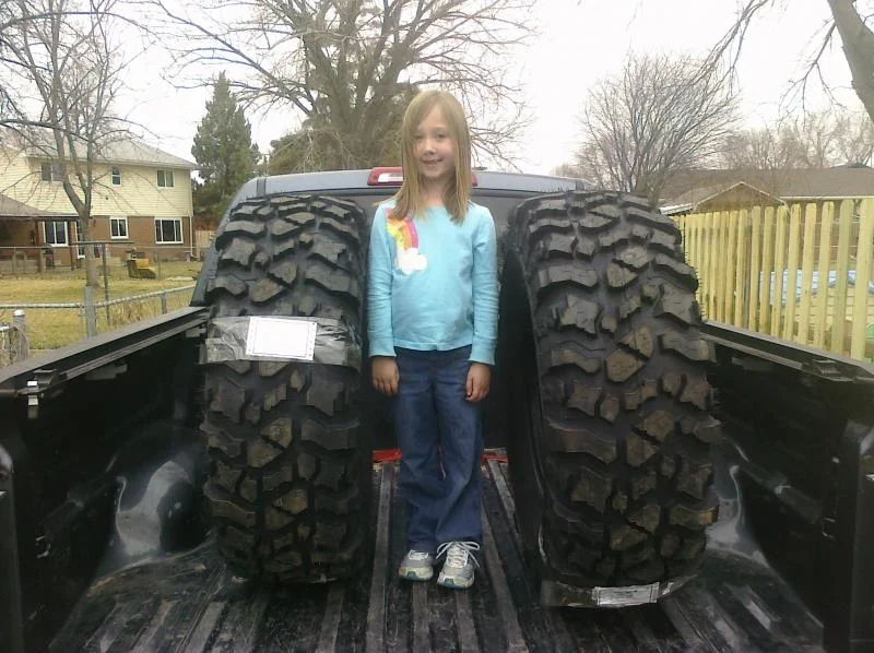

Poor boy are talking about the Rockers or the Iroks? I have heard that about the Iroks but not from the Rockers. Anyway doesnt matter now me and the helper made a trip to the shippers dock. Up close and personel these tires are badass. The tread pattern is awesome and all the stuff that is wrote on the sidewall is pretty cool, they even have an american flag on the sidewall really what else do ya need. The lugs are pretty soft so they may wear faster than some. Owell totaly worth it. IMPRESSED
