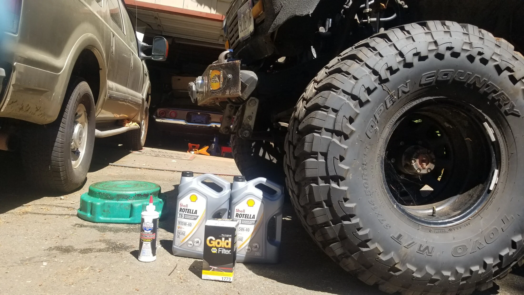

Oil and filters are cheap, change often. I like Energy Release. I run Shell Rottela 15-40.

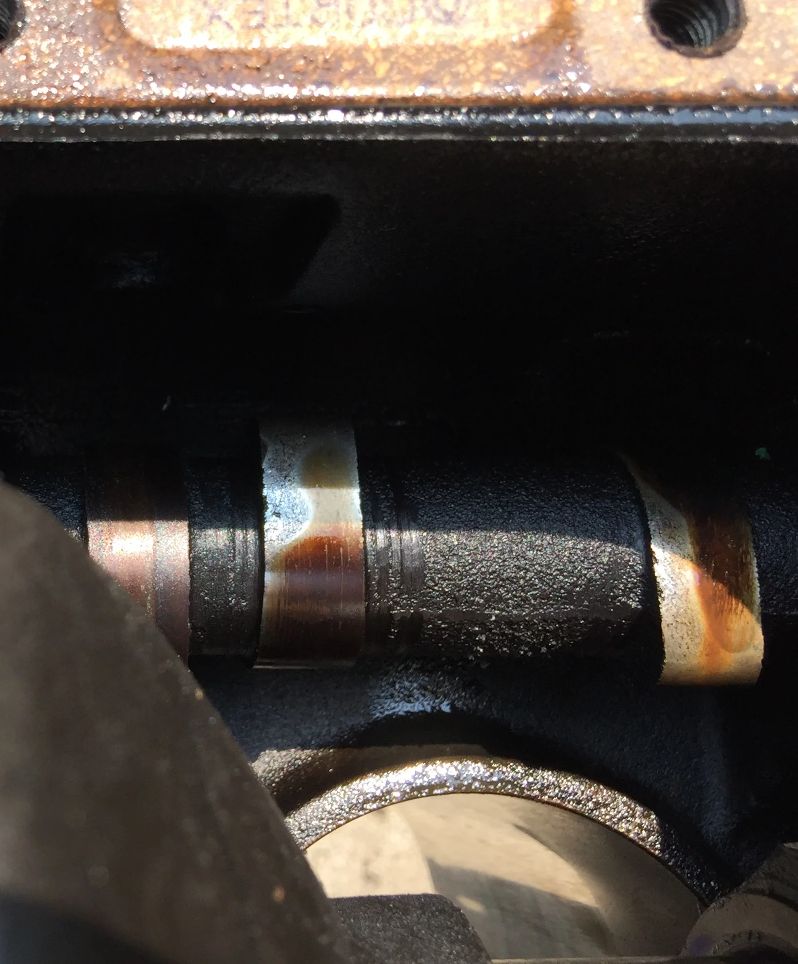

Here is what a 68 F ‘bump stick’ looks like with over 100k miles. Note the ‘galling’ on the ramp side of the lobe….this engine let go due to a broken piston in 2000. There were no valve issues, everything stayed in adjustment from what I remember. Oil used back then was straight 30 weight Dino blend….whatever was cheapest. I think that was my Pennzoil period, I liked the yellow bottles.🤣🤣🤣
So 25 years ago there was no issue with ZDDP, or it was an unknown issue. Maybe it was known, and at that time, I just didn’t give it much thought.😎
