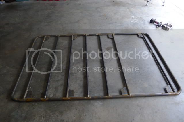

Do you have a weight and other dimensions? What about close up pics of the mounting locations?
What mounts did you use? What did they charge you?
Weight - I'd guess to be around 60-70lbs?
dimensions - I can get exact ones if you want but 20" for the moon roof and 10" btw the other support bars. I think 4" for the front support bar and 6or8" for the rear support bar from main hoop.
I used the Groucho mounts from Gamiviti.
I can get pics of mounts tomorrow. If anyone wants one near Houston, lmk. My buddy can make more but I don't think he wants to deal with shipping/freight etc... Especially if no changes are required.

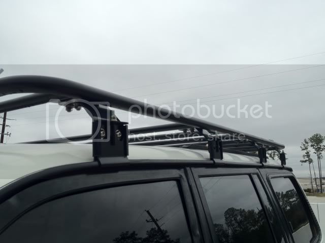

Here are some pictures of the mount:

I believe the mounts you used had to degrees for the angle of the mount (with a factory rack and without). Which ones did you use? You removed the factory cross bars but left the center strips?
I ask because I am trying to build a setup that is as close to the roof as possible (without building it from scratch) My truck is my DD so I need to fit in underground parking when in the city (most are 6' 8" - 7").
Thanks! The rack looks great!
Those are 45degree mounts. Correct about the center strips being left in place. Currently, with the heavy/med combo and 285s, I fit under the 7' garage at work. it still makes me duck my head though. a 6'8'' garage might be pushing it...
Even though it looks like it sits high from the sides, the middle of the roof to the bottom of the rack is roughly only 1.5".

Total coincidence, but I had another member here contact us about making him a custom Gamiviti flat rack with a sunroof opening, in fact he turned me onto this thread after we'd already started the design. I just picked it up today and took some pictures, here you go:
It's the exact same rack as our flat rack, but with the 2nd cross bar cut out, then two new cross bars put in at 90° to box in the forward mounting plate, and frame in the sunroof opening.

And hey couple comments on the above comments as long as I'm here: the 30/60 towers are about 1" lower than the 45° towers, and each have about 3/4" of up and down travel to them. The 30/60 towers will only work if you don't have a factory rack, but the 45° towers would allow you to mount something above the factory rack. We originally made the 30/60's to get a wider stance, so our same racks that fit the 80's and 100's could also fit the 60/62 series, but then later realized they could also be used on 80's for a lower profile rack.
The upside of the 30/60's on the 80 is you get more clearance for garages, a little less drag, etc. The downside is it can be a pain to put your arm under there if you have to reach all the way to the middle for a u-bold for a box or something. You can usually get past this by mounting the inside mounts first with the box or tent towards the outside, then sliding whatever it is over. there are 80's running 4" Slee lifts and 315's, running 30/60 towers and Expo racks (basket upwards) and driving inside standard 7' garages. it's tight, and every garage, and every ride height is different, but it's definitely possible.
