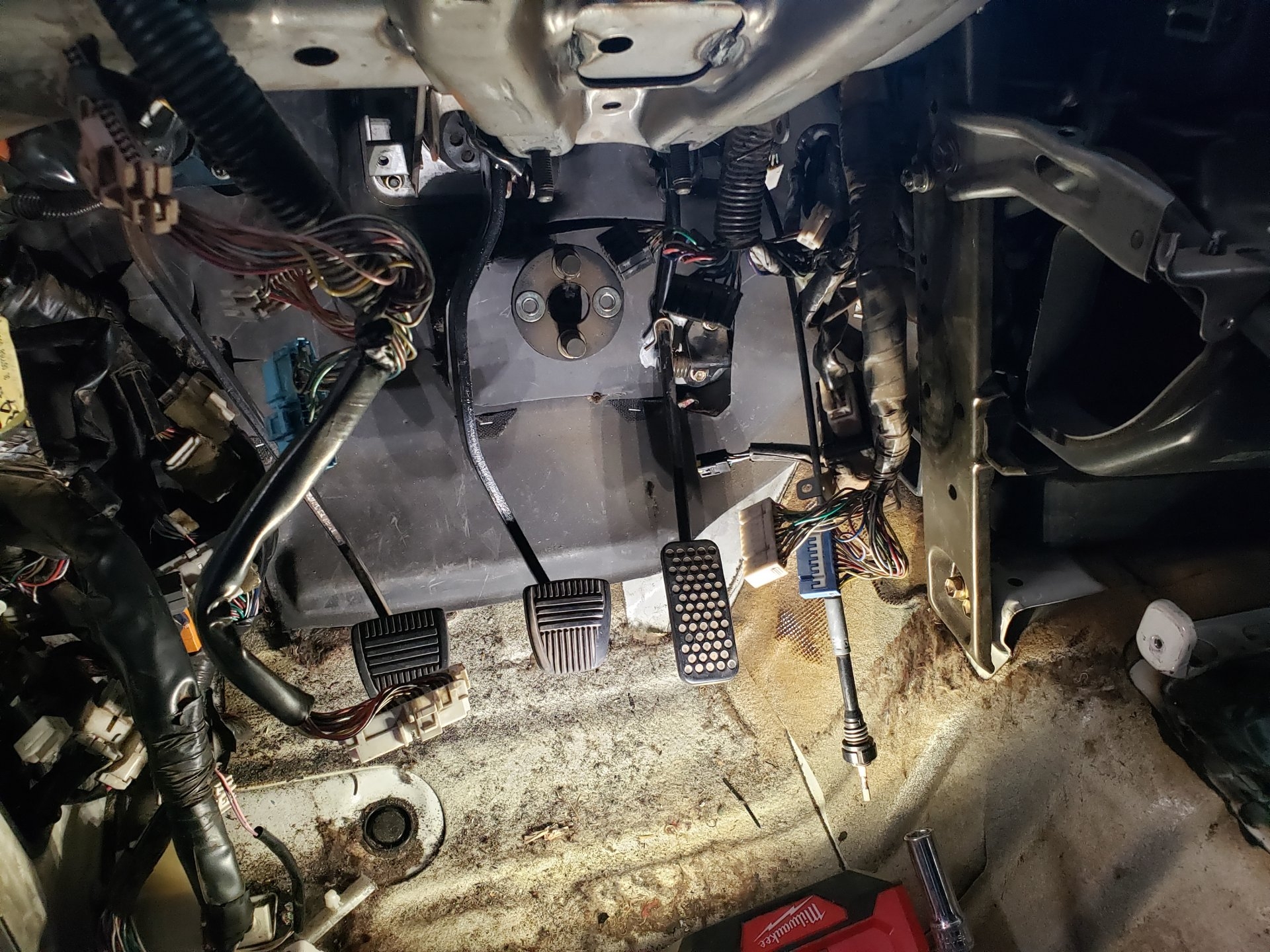

With the clutch in place it is time to make the shifter fit. The Auto Tunnel and the manual tunnel are not the same and come off the production line as either manual or auto.
As luck would have it though the HDJ80 had a perfect manual tunnel and the FJZ80 didn't so I just cut off the top of the HDJ 80 and welded it into the FJZ 80
You can see the holes drawn for the manual setup don't have a lot in common with the Auto Holes
Thats ok we can make it work
Welded up, quick coat of paint and walla one FJZ80 with manual Tunnel, also put the clutch pedal in while I was there.
