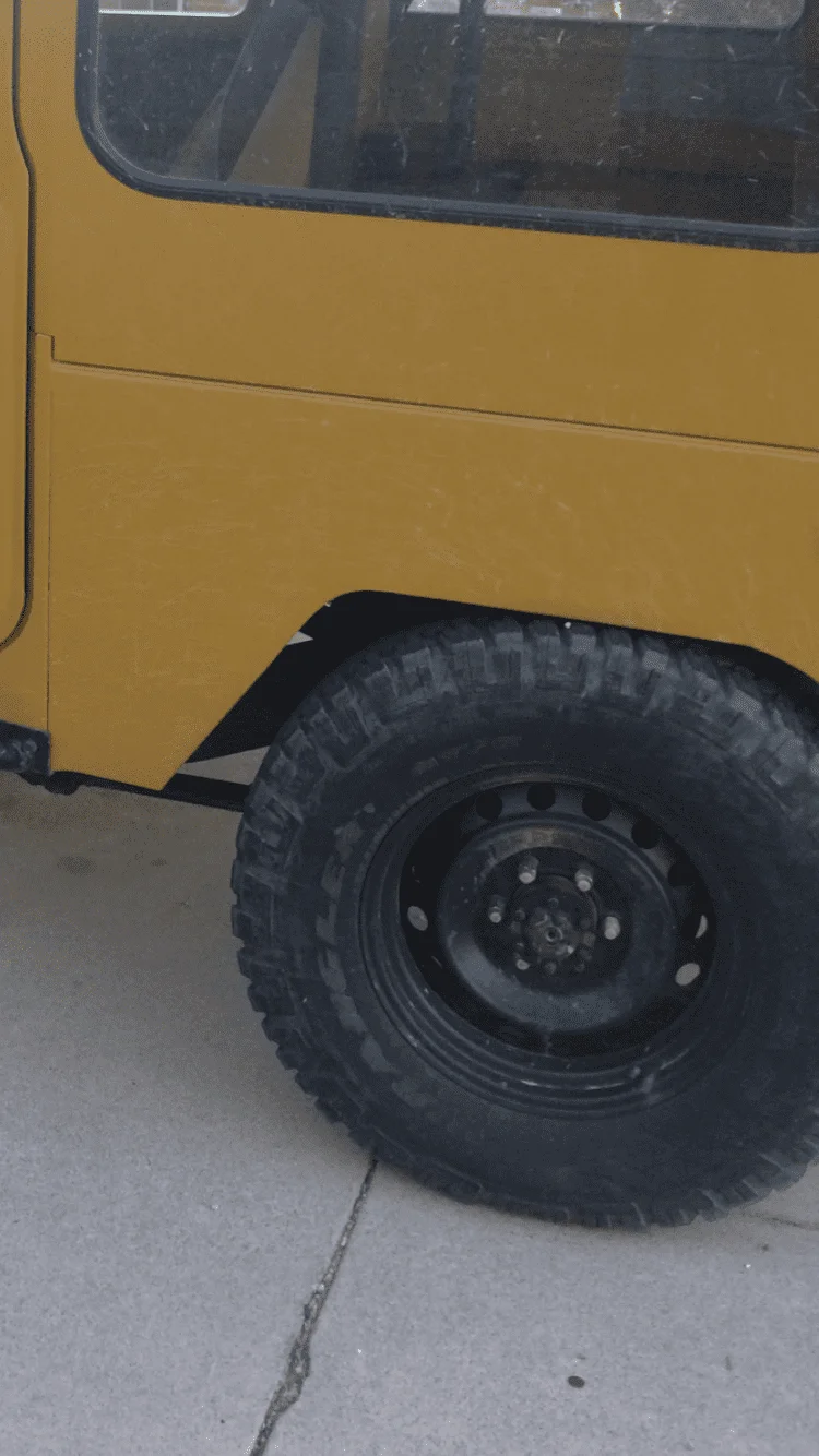

I'll have a set in hand tomorrow...they are 17x7.5 with (edit: 4.75) inch backspacing / +15mm offset.
They are for my FJ60 (with spacers), but I could test fit on the GX, if necessary (?).
- Brian
I'll have a set in hand tomorrow...they are 17x7.5 with 4.5 inch backspacing / +15mm offset.
- Brian

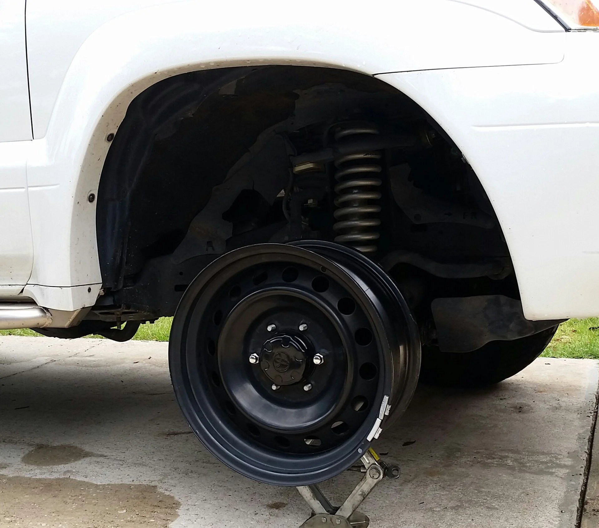

Please post a pic mounted on the GX, would love to see how that turns out. Aside from the weight, steelies are darn cool.
No tires on 'em...but they bolt up fine, clear the calipers, etc...
I was wrong on the backspacing above - FJC steelies are 4.75" BS, as measured by me today. +15 offset is still correct.
Stock wheels are also 17x7.5, but closer to 5.25" backspacing (+25 offset).
I'd say the steelies would look great at around -10 offset on a GX, using a 1" spacer.
- Brian

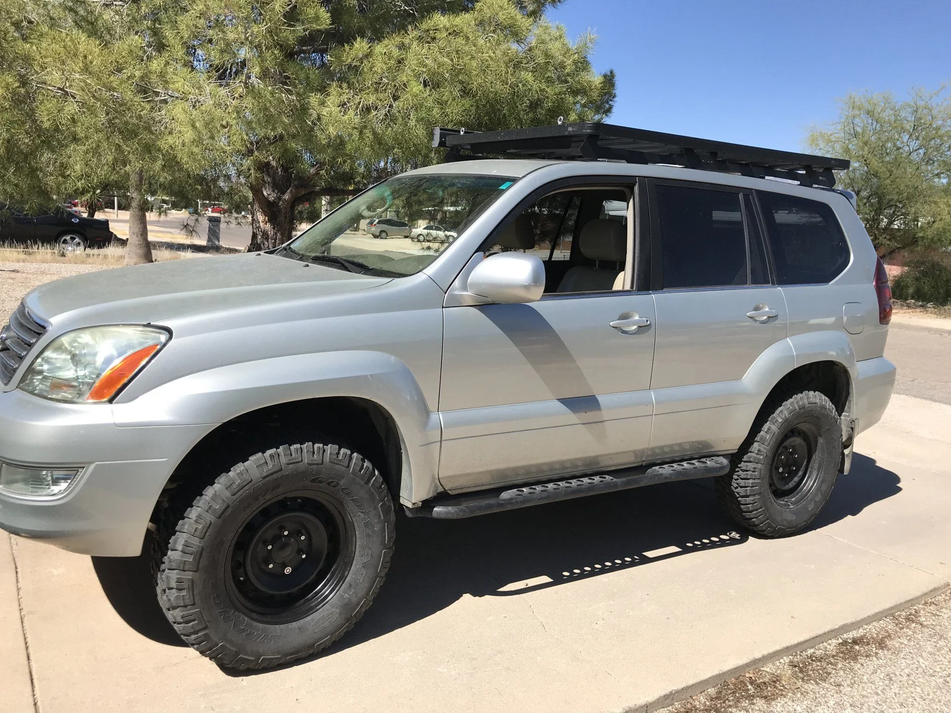

They fit with no rubbing! OME 885/895 with SPC UCAs
Love it, looks awesome. What is the weight on those steelies compared to the stock aluminum?
