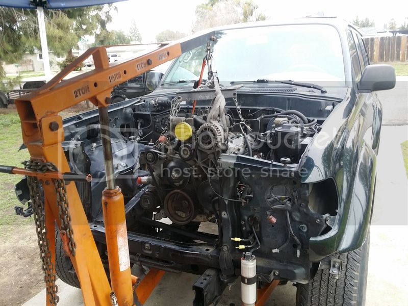

Got some work done this weekend. Got the broken Exh manifold bolt out of the head and the bad freeze plug.
I also just hung the 5.3 in the 80 to try and clear up the manifold mess.
I must say it is encouraging, to get it in there and just look at what I'm dealing with.

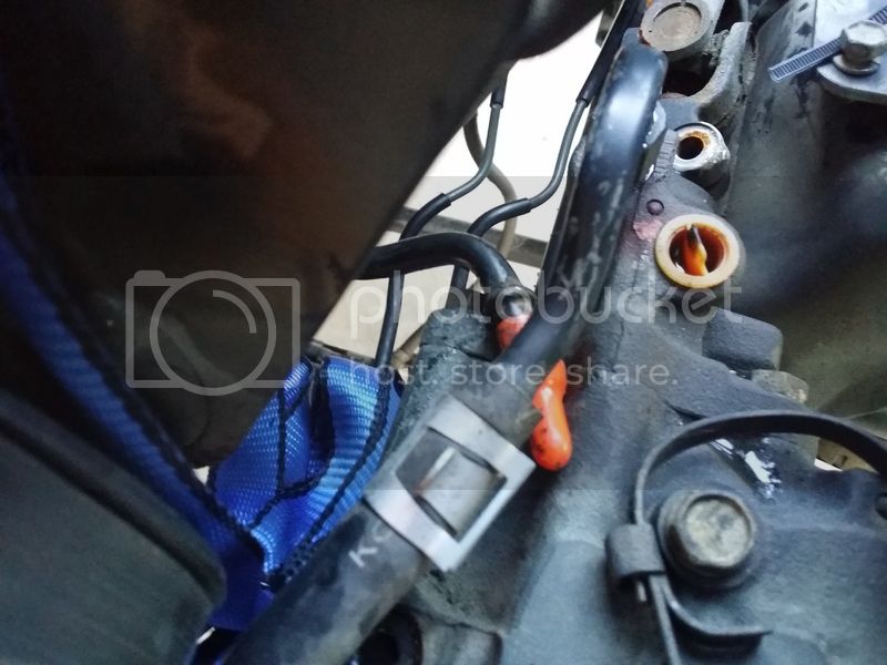

There are some small issues, I need to bend the P/S pump fill/return line so it will clear the steering box. Also need to cut down the AA motor mounts, as they are stick out about a 1/2" past the frame rails, while the motor still needs to come down a few more inches
But on the most encouraging note, I think The exhaust manifold question is now answered. The Truck manifolds really are not as bad as I had thought. But seeing how close they are to working makes me feel like the 2010-2015 Camaro manifolds will work. Im finding them on ebay for 160 a set. I hope to order them by the end of the week.

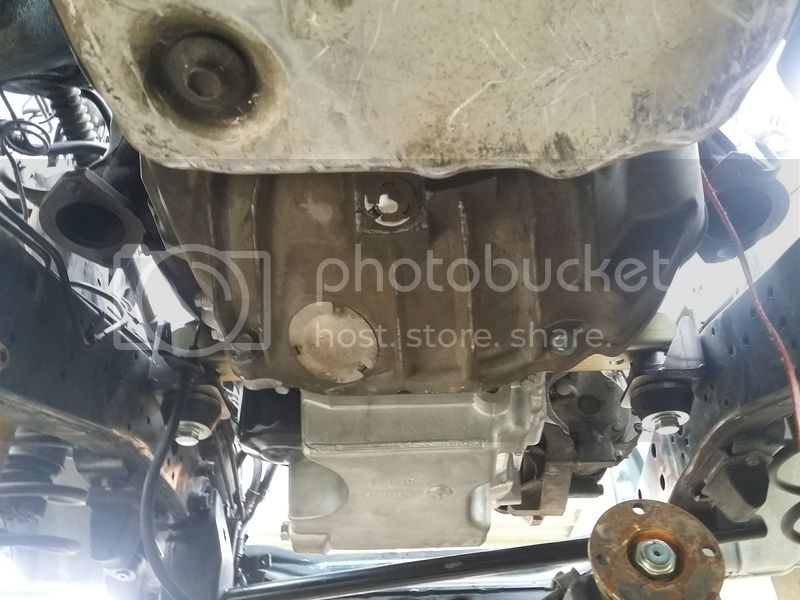

As for the Oil pan Yes I bought the Muscle car oil pan kit from Summit racing. It was 149 & It came with the oil pan, oil pickup tube, dipstick, & windage tray. Very common for an LS Swap.

New pan gives me a lot more clearance mostly as its offset to the right away from the front diff! :bounce2:
Manifolds are still a little close but not the end of the world. I hope :worms:

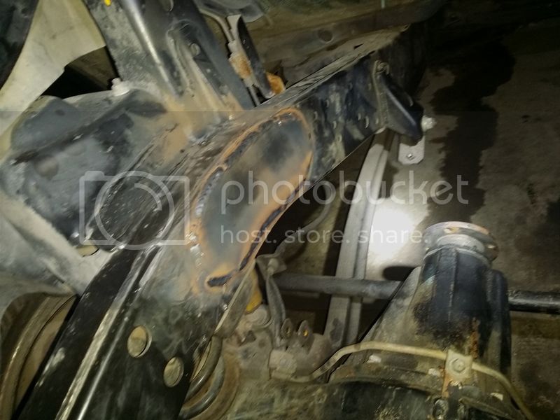

Then I yanked it out and clearance the fire wall with a BFH on the pass side. Gained about a 1/2 of clearance.

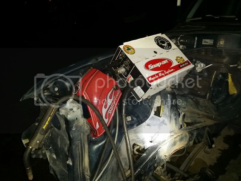

I also fabbed up some scab plates, & burned them in place.
I love my welder, the wire feed is detachable and has 8ft leads. So i can set it up in my garage & set the wire feed by what I am working on. :smokin:

At first I was unhappy with the pan but used it anyway as i diddnt see as much of a benefit until I had it in the rig!
