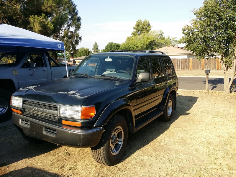

Well About a month ago i found out that me and my beautiful wife are expecting our Third child.
Little one.
So i Now have a 4 year old, a two year old, and third on the way. No way am i fitting three car seats into the vw or my Pickup.
I tossed around The Idea of a second gen runner, but thats a tight squeeze in the back. So The search was on for a FJ80
And i found one!
Its A bit rough, as you can see the bumper is bent and paint fading. Its A 1993 W/ the 4.5, disk brakes all the way around and full float rear.
All the windows work and sunroof does too!
Needs the seat gear the always falls off on the drivers seat, and the drivers seat also has some rough spots.

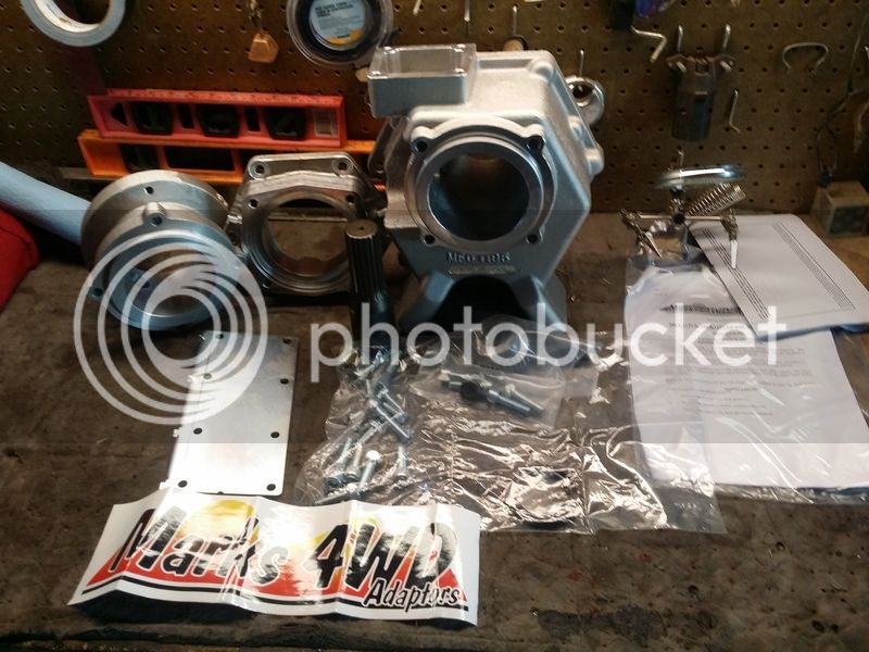

I will be using the AA Adapter to go from the 4l60e to my H2fa case. 1500 OUCH!

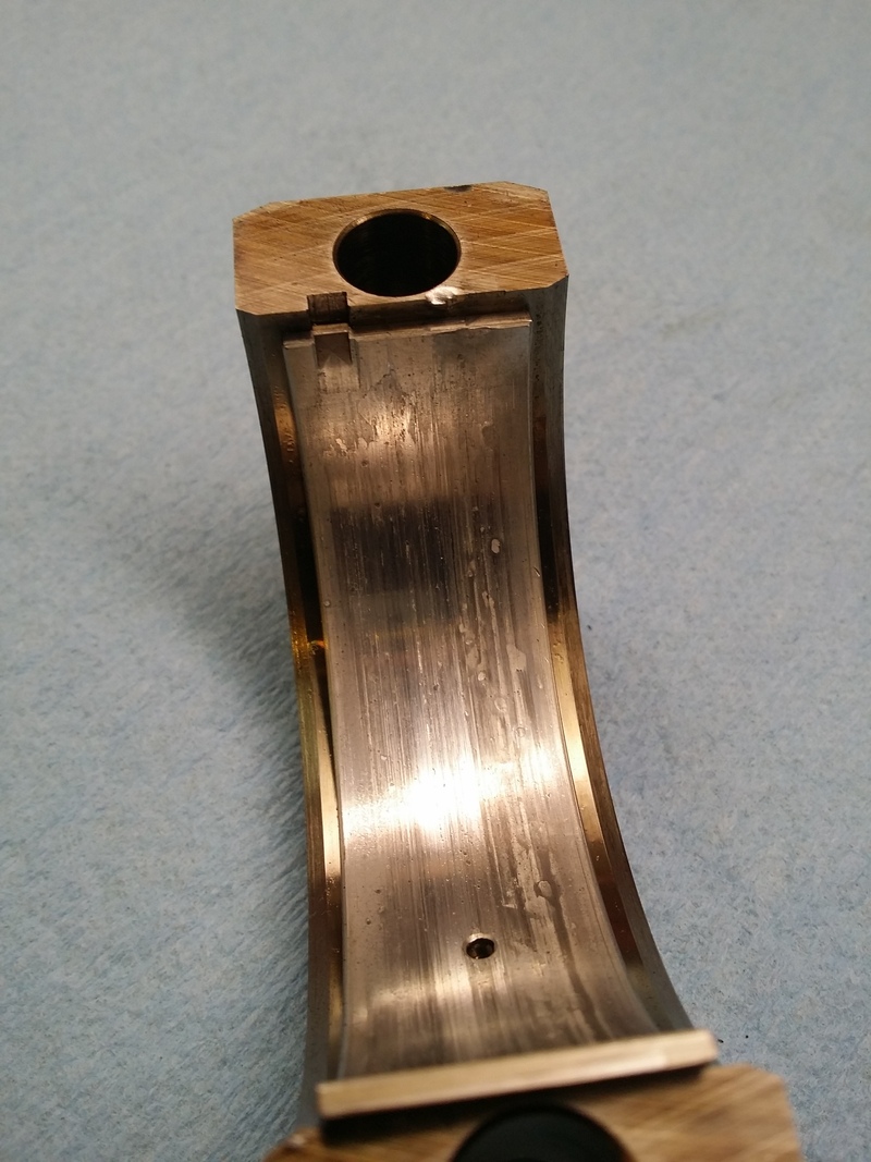

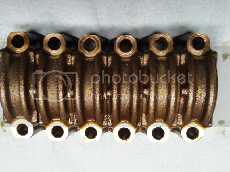

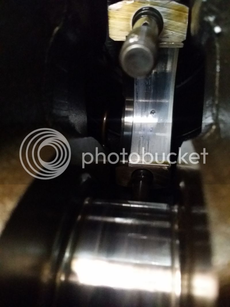

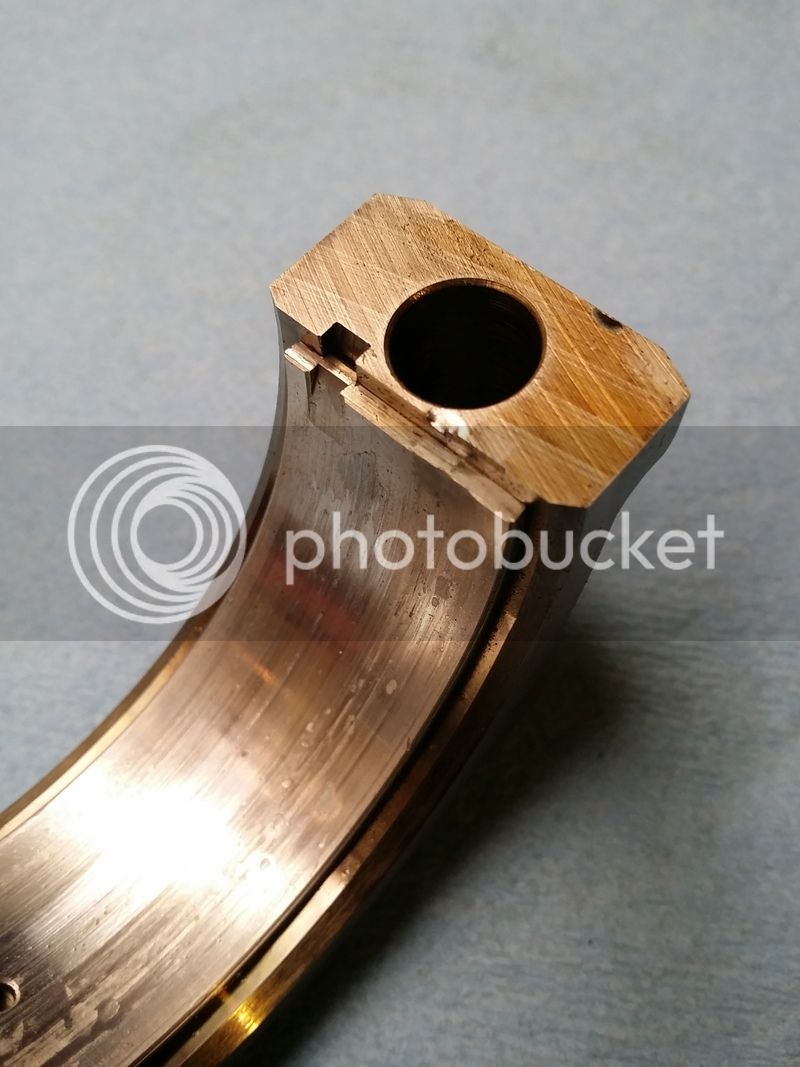

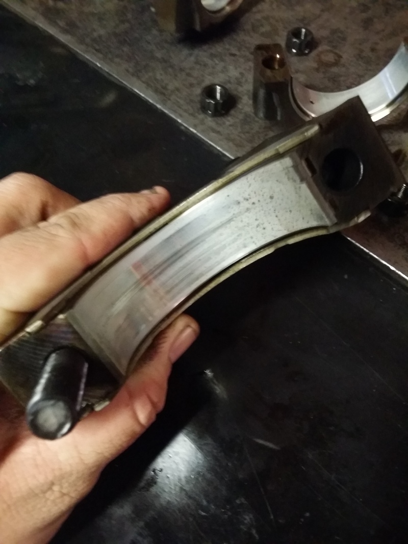

So i Also pulled the rod caps an mains last night. The results were not good. # rod bearing spun about 1-4 of an inch the tang wedged between the block and cap.
I would assume that all that kept it from spinning all the way.
Is this an evil trick by Toyota? Or have these been replaced from several engines? The rod caps are numbered 2,2,2,2,3,3

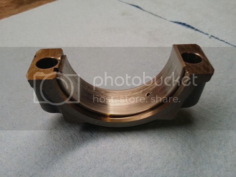

The Mains are bad too. All the black specs are debris that can be felt to the touch. They feel sand paper!
Look at the top bearing on the #5 Rod

2)AA Adapter kit to H2fa 1500

I have committed to the 5.3 swap at this point\, thanks for the thoughts though check it out the adpater showed up today!

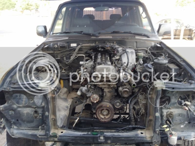

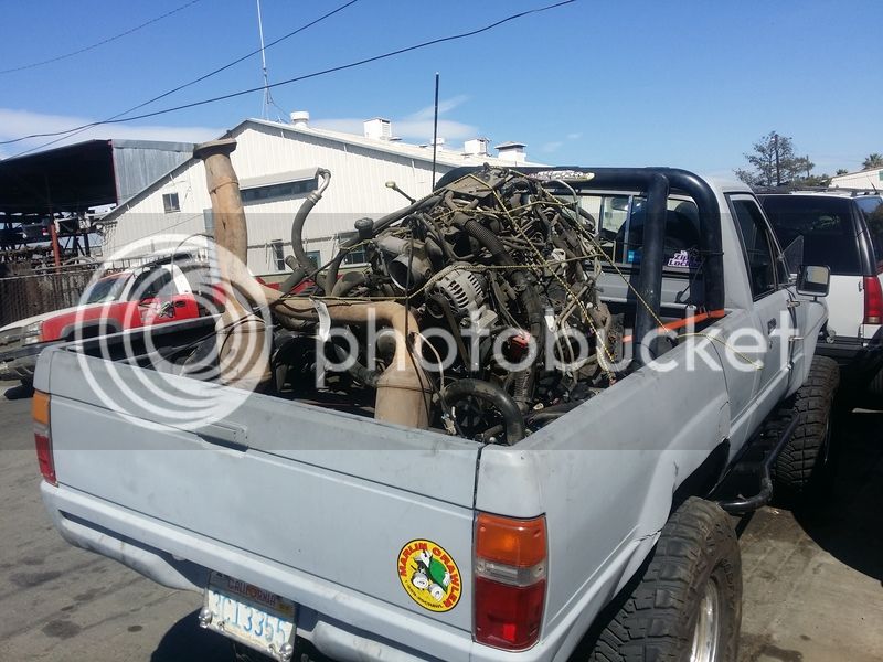

I also Got the engine trans and T-case pulled, and pressure washed the engine bay.
The FSM says to pull it all at once the engine, trans and t-case. As the oil cooler lines are so tight to the block and trans, along with the wiring harness. That was not a fun pull, next time the get separated!
Sure those bungie cords will hold? :flipoff2:
Hahahaha What you don't see in that pic is the engine ratchet strapped the pallet and the bed hooks!
The bed net was for all the little stuff i had stuffed in with the engine, wiring,hoses,fan and shroud,airbox,ect
:lol: Figured as much. :cheers:
That's quite a load for the little one!
Congrats on jumping in both feet!
Yea she did well on the way home. Pulled the hills at 55, Not bad for a 22r!

Pulled all the hoses and accessory's off the motor and caped every hole for install.
