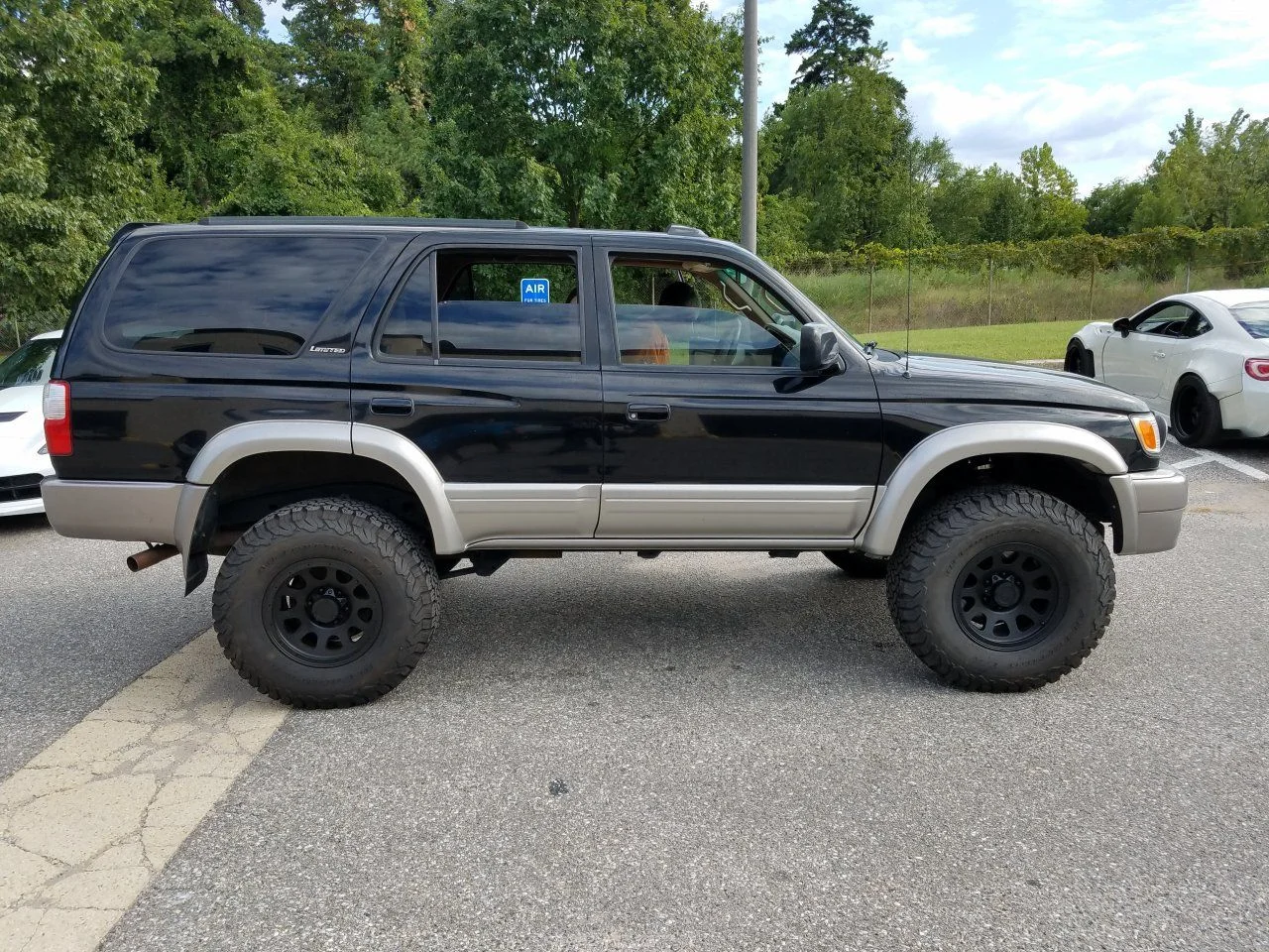

Check out Sonoran Steel 1.2 kit. i just put it on my 01 Limited. You can buy the entire suspension kit, or you can buy a kit and get your own springs and struts. i just put mine on and it was super easy. i went with radflo coilovers in the front. you can get the kit for just the back though.
META_TAG_FACEBOOK
back only
META_TAG_FACEBOOK
the lift looks awesome, rides awesome and it is really flexy
Than you @HERF0318 , the coils were becoming hard to find as I couldn't find the ones I took off my land cruiser, and having a good friend at the dealership in the parts department, my buddy ordered new coils. They'll be a little high, and stiff for a few weeks but that's fine. We're going to build him a panhard drop bracket out of tubing and weld it to his factory bracket, with the necessary gussets/bracing to keep it stronger than stock. Do you have pic's of yours since putting the kit on? Itll help me convince my buddy to lift his a bit more! Thanks for the info!
yes i do, here you go. the front is about 3.5 over stock and i think the back is 4-5 over. it has settled a little and looks perfect. i will be throwing some bumpers which will level it out as well.
This truck looks great. What size KO2s are those?
