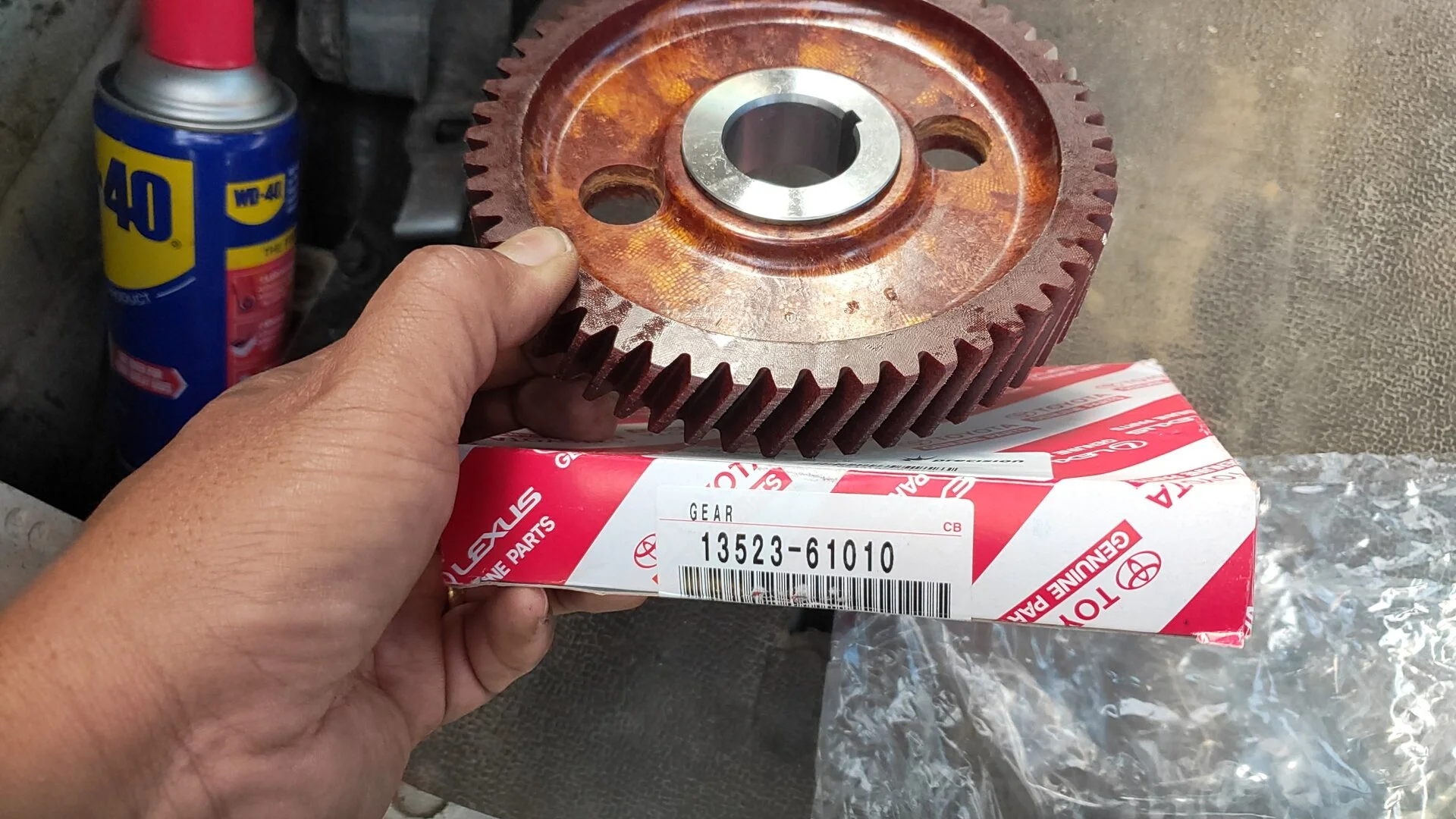

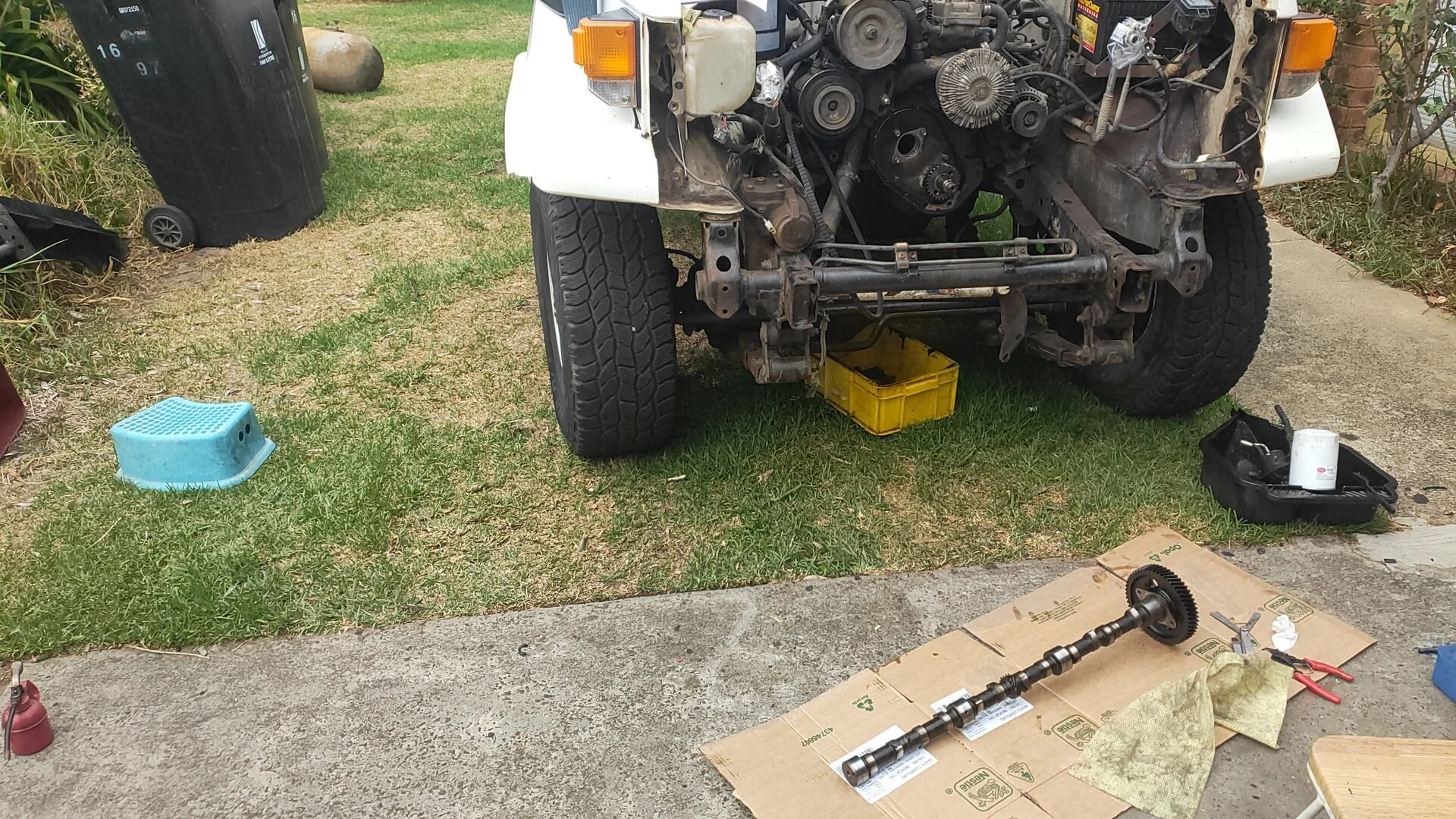

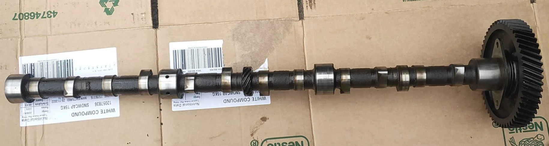

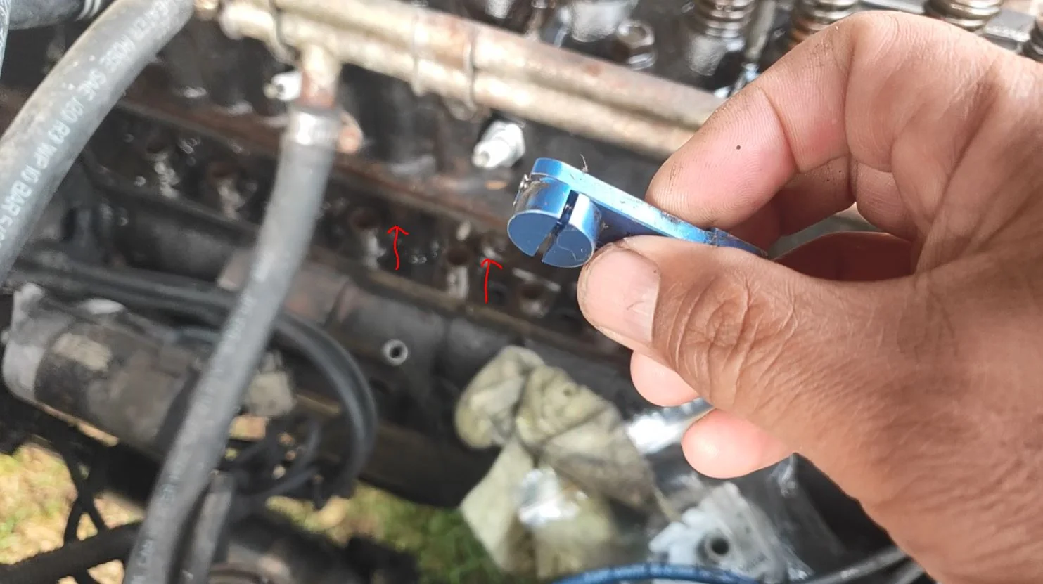

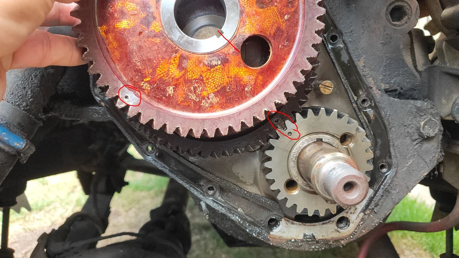

Lost all compressions suddenly. Checked and timing was off. 516,000km on the clock. Bought oem fibre gear and cover gasket

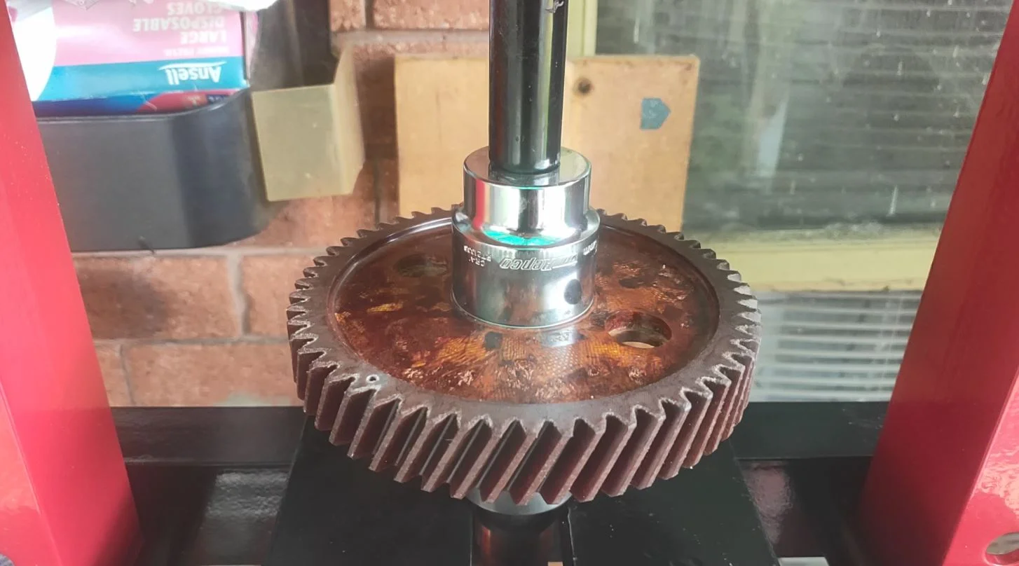

I initiallly suspected this issue after reading the forum post here:

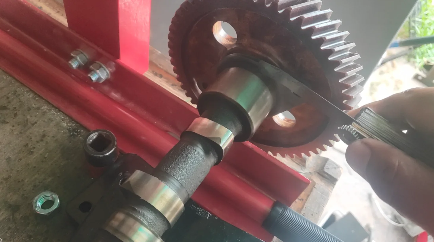

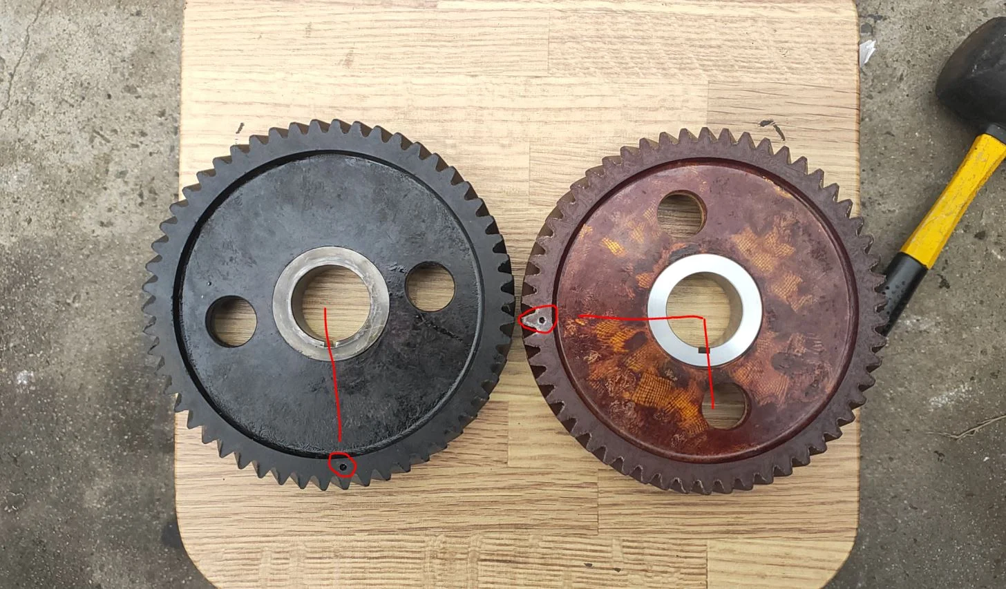

I'm not crazy... 3fe cam gear slipped 10 degrees
forum.ih8mud.com
Mine is not bad as his, as he could wiggle the fibre part by hand. Mine was still tight, just out of alignment.

so i ordered a timing gear !

Is it fair to say, this is a “interference “ engine? No bent valves, pushrods or piston damage? The crank had to have made a few revolutions before it stopped running.
