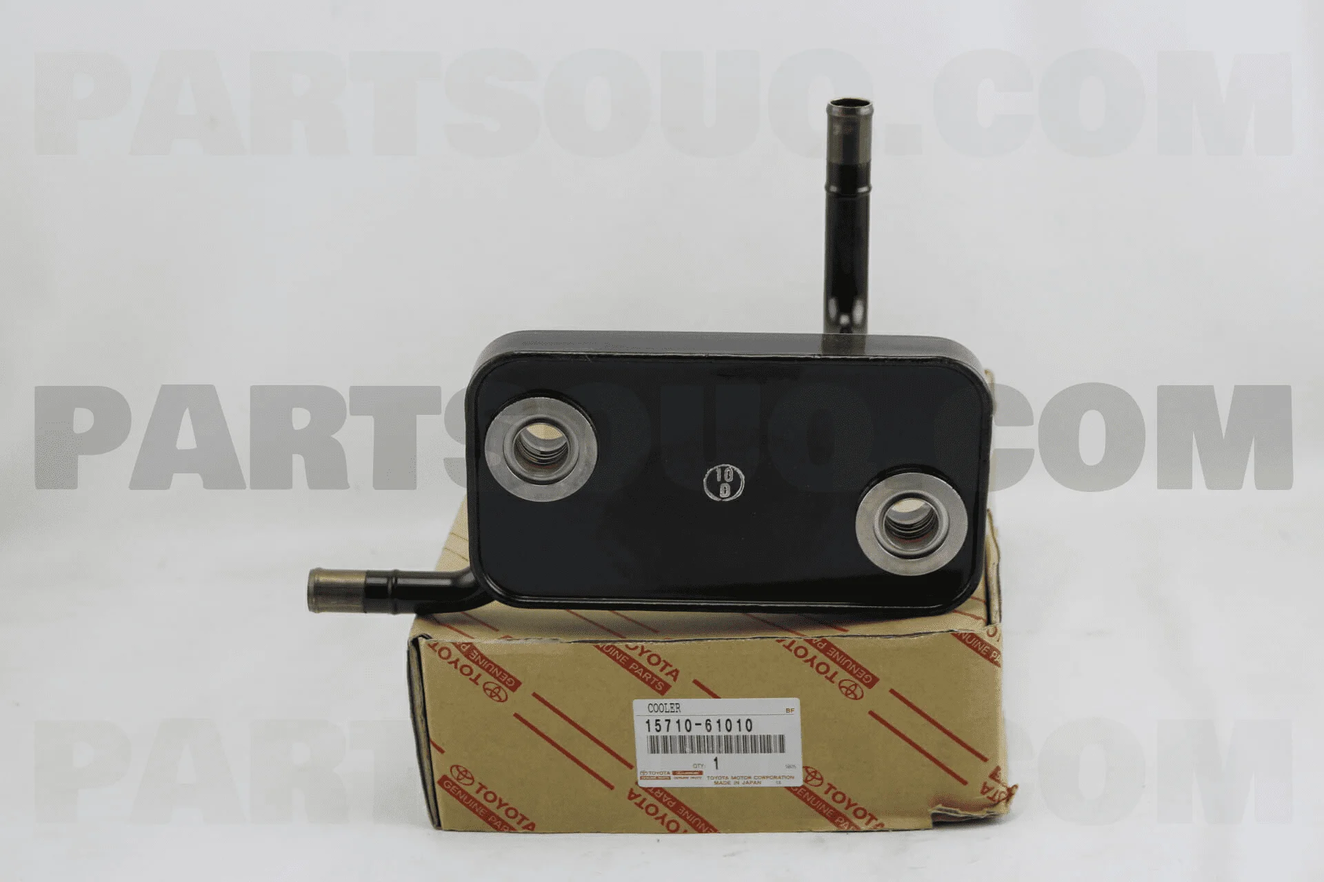

This looks like a pretty old thread but maybe someone can help me. I am looking at the CSF radiator for my 1989 FJ62. Earlier in the thread it says the correct model number is the 2708 for the FJ62 with the transmission oil cooler. On CSF website it lists the 2709 as the correct part for the 1989 fj62 but both the 2708 and 2709 say "without engine oil cooler" can someone verify which one is the correct one?
Your 89 should have the Engine Oil Cooler.......i installed the CSF 2708 on my 89....
The oil cooler tank in the CSF radiator is not for engine oil. Its for transmission ATF. As described above the engine oil cooler is a separate part. I think CSF stopped making the FJ60 radiator without the ATF cooler tank such that both radiators they offer for this era of LandCruiser has an ATF oil cooler in it. I don't know why. 2708 is a 4-core radiator whereas 2709 is 3-core, just FYI. CSF 2708 should work fine. HTH.
