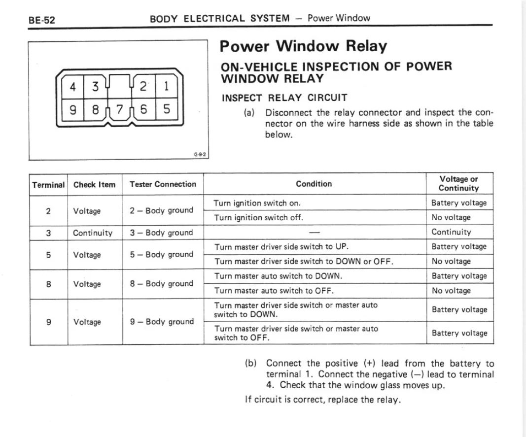

The problem is more than likely in your Power Window Relay ( small green box in drivers door ). See red square in wiring diagram.
There are two small relays in there that need to be changed.
It seems like you have done some of this testing so far, but test (b) seems straight forward. Apply battery voltage to terminal 1 & 4 and see if the window goes up...If the window doesn't go up, then it's probably something other than the relay.
