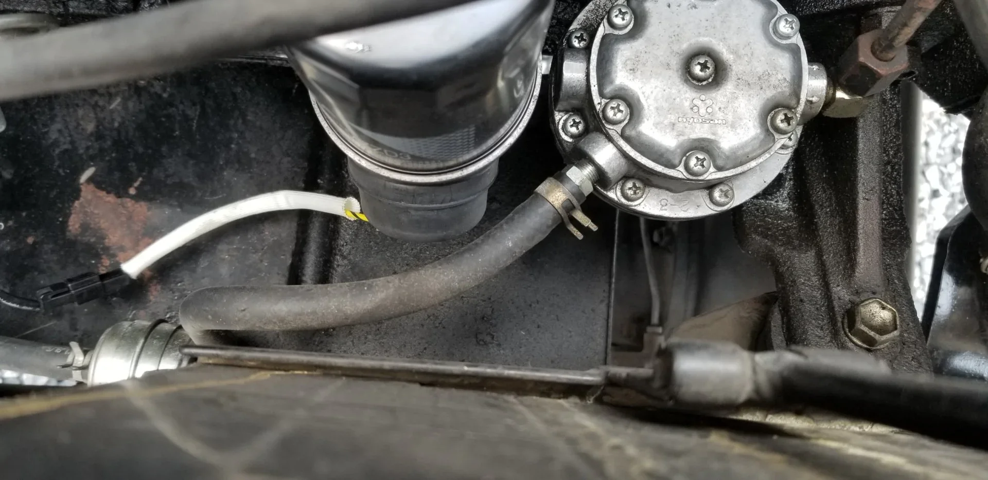

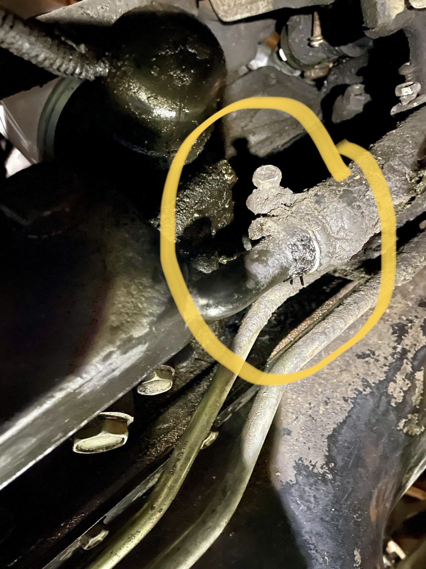

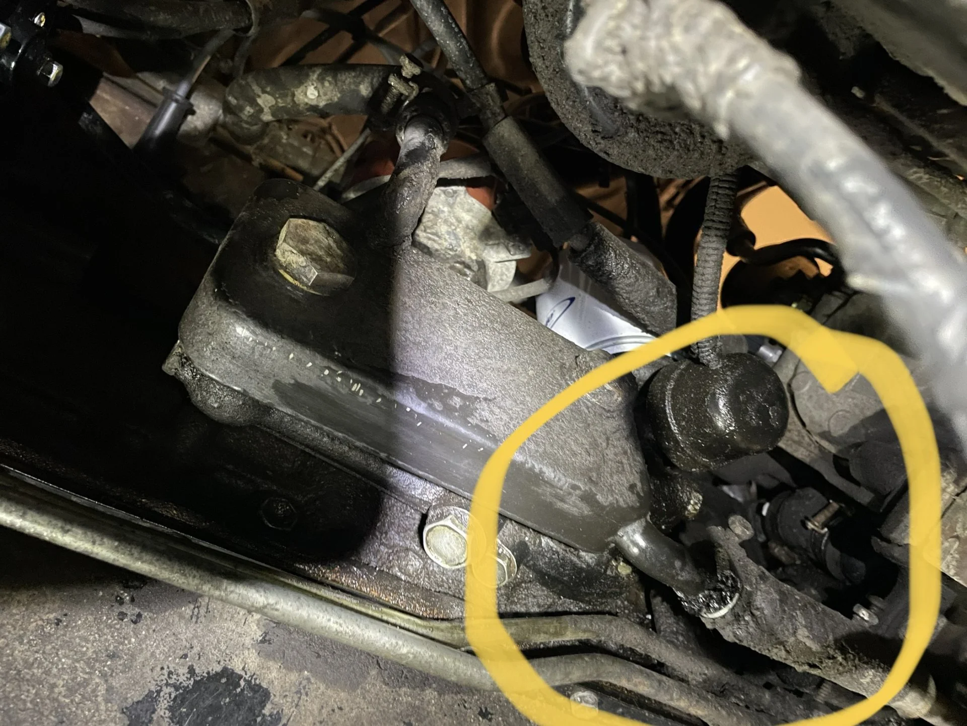

Curious for thoughts about how sketchy this rubber coolant hose looks that is going to/from the Oil Cooler in attached photos. The hose is kind of crumbled on the edge outside up to the clamp as you can see in the photo looking at the cooler from underneath the vehicle. The hose also seems kind of gummy, swollen, and crumbly on the exterior coating inside of the clamp heading toward the front of the vehicle. I'm a novice, learning a lot, and I don't know if:
a) this is fairly high pressure once the vehicle is warm
b) it's high risk of rupturing at any time / don't drive it until fixing
c) medium risk / may rupture but be careful driving and watch it closely until fixing
d) medium/low risk

my WAG is that is an original hose
I would plan on replacing all the hoses, there are alot, maybe 15+ hoses on a 3FE
if not using the OEM style clamps and using worm drive clamps be cautious as you can crush the heater pipes
I agree.

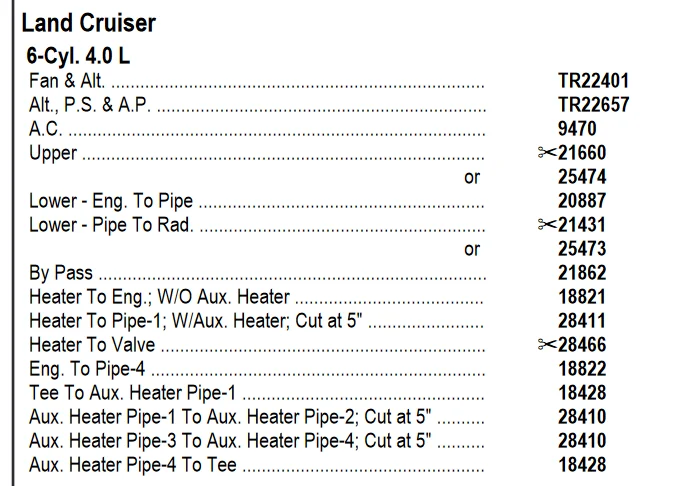

These are the Gates v-belt and coolant hose part numbers for the 1989 Land Cruiser. I counted 23 hoses on the Toyota Parts Diagram for radiator, oil cooler, front and rear heaters, so the Gates list is not complete.

Im going to be real honest - Im very confused by that last post.
Im also interested as Im about to put in a new radiatora nd have new Toyota coolant (not oil cooler) hoses ordered.
I asked Toyota about the oil cooler parts...they were WILDLY expensive. HUNDREDS for one. And there were several.
oil cooler hoses are not hundreds of dollars, the parts guy was giving you a line
all the hoses you'll need should be $200??? total
if you are going thru the trouble of draining the system, and the rad is out, change them all.
what Matt was trying to say was don't cheap out, if you are changing them change all of them with quality parts.
some of the hoses are just straight pieces of hose others are formed.
avoid the normal work drive clamps, they will deform the heater piping

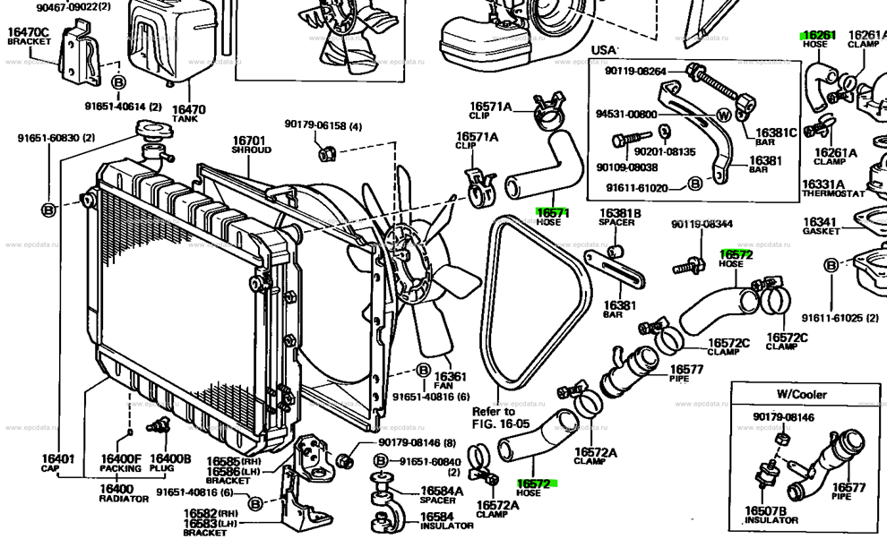

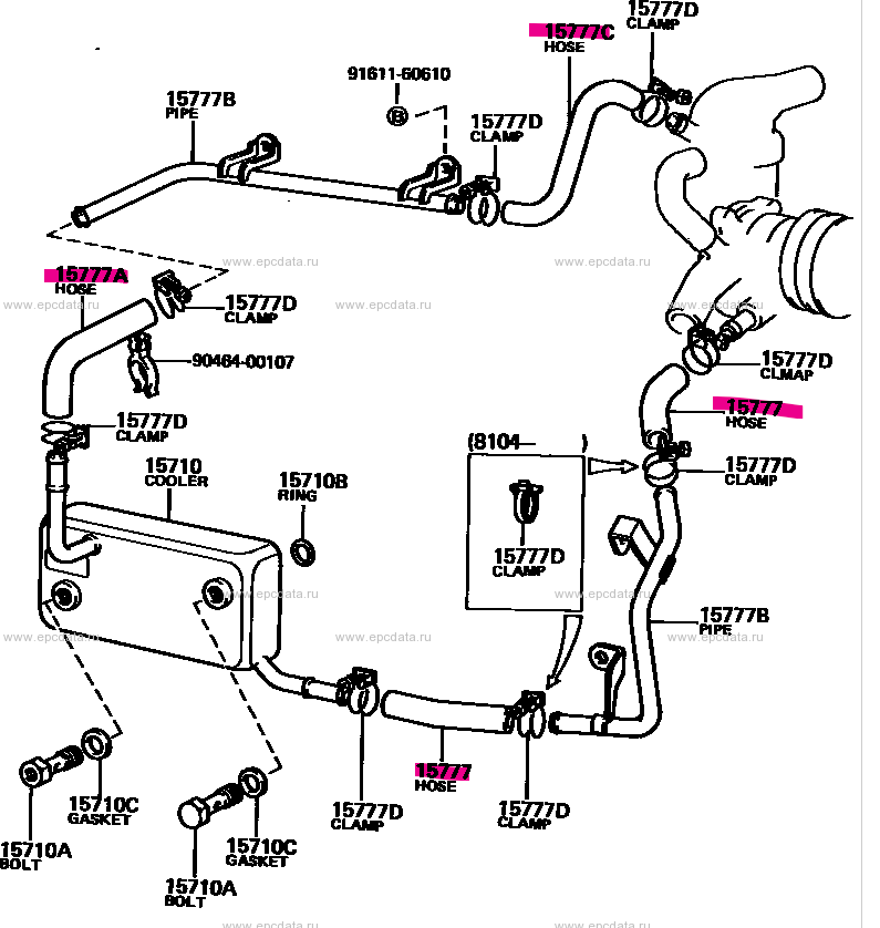

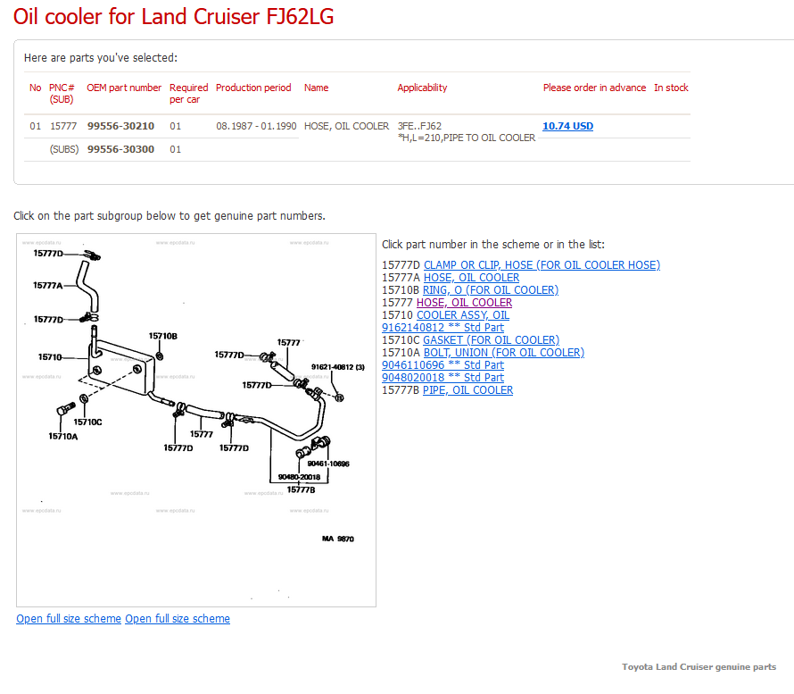

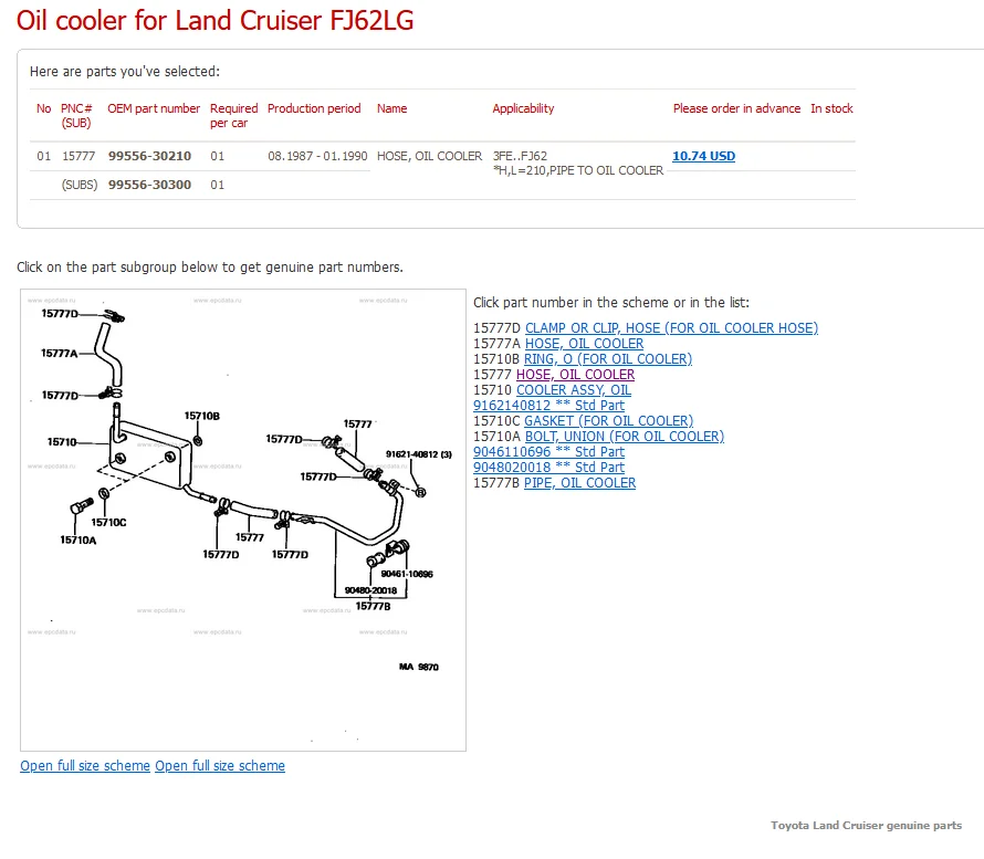

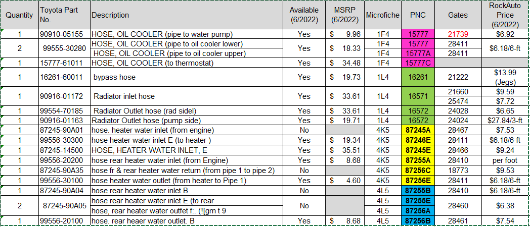

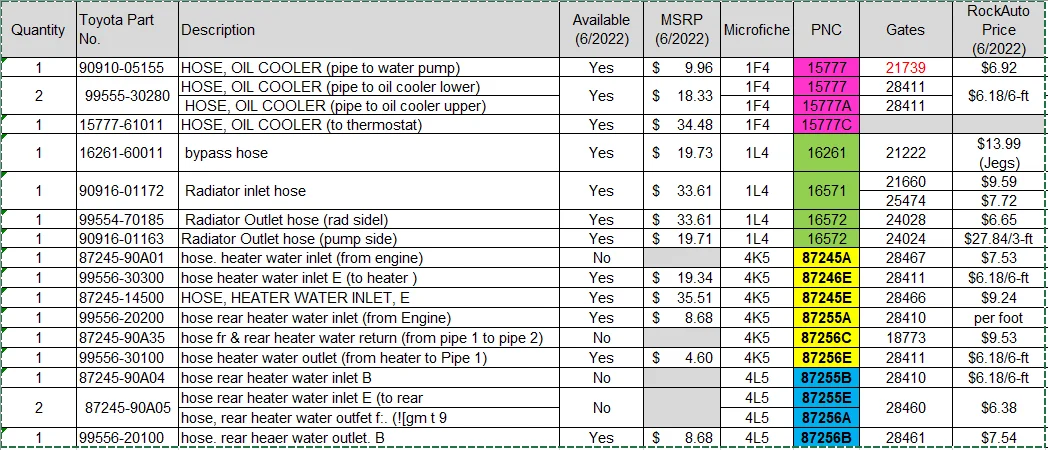

Have PN for the oil cooler hoses you got?
Got a new radiator the other day (aluminum one) and will be swapping it out soon and doing new hoses etc
gotta be honest... not 100% sure if I'm getting the right part now. The hose I ordered is 99555-30280. It's labeled as hose that connects oil cooler to coolant pipe (which describes the part I need accurately) but yet the years listed for this part only go to '87. Yet I have a 90. Further compounding the confusion, the schematic shows the exact same cooler I have, as near as I can tell. I guess I'll find out once I get it. May work out, or may be a learning lesson.

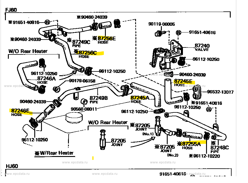

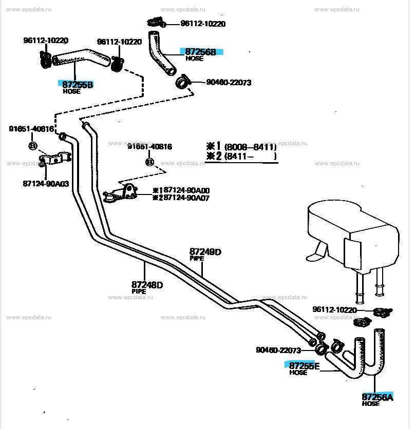

All good. Thanks for copying the table and diagrams above. MUD is so vast, I missed those. The first diagram looks like my setup for the 62, at least for the bottom half which is where my immediate concern lies. The "decoder" matrix is very helpful and leads me to believe I've got the right part 15777 = 99555 30280.
The toyota part number for the FJ62 hose is different, but I think that hose cross references to a 5/8" ID straight heater hose. I suppose the lengths of the hoses might be different from FJ60 to FJ62 since the metal pipes are a different between these models. Or maybe the FJ62 number is a standard length where you cut to fit ("L=210" is Length is 210 mm).
View attachment 3154985View attachment 3154986View attachment 3154987View attachment 3154990View attachment 3154992
those are for a 60 series, I'm thinking some of the heater hoses are different on the 62 series, plus the ones that go to the throttle body

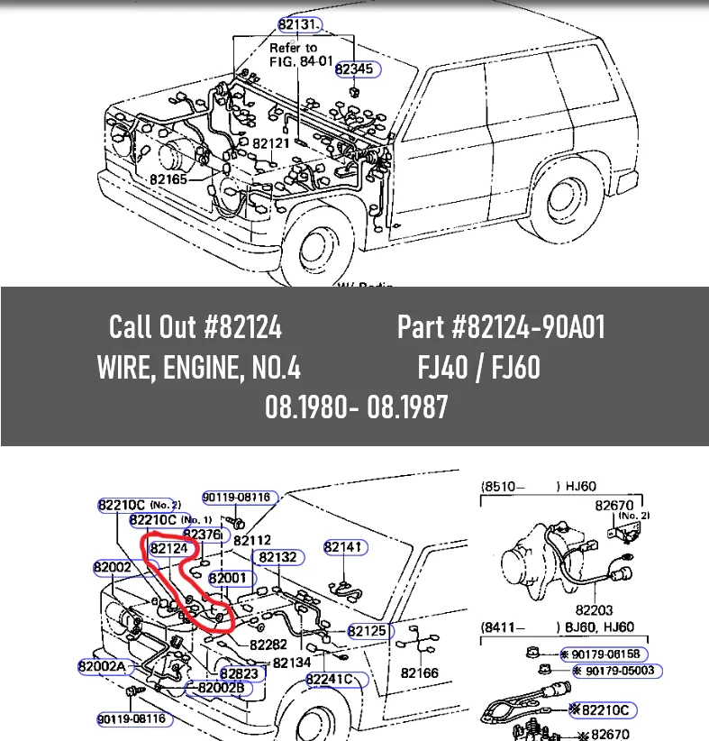

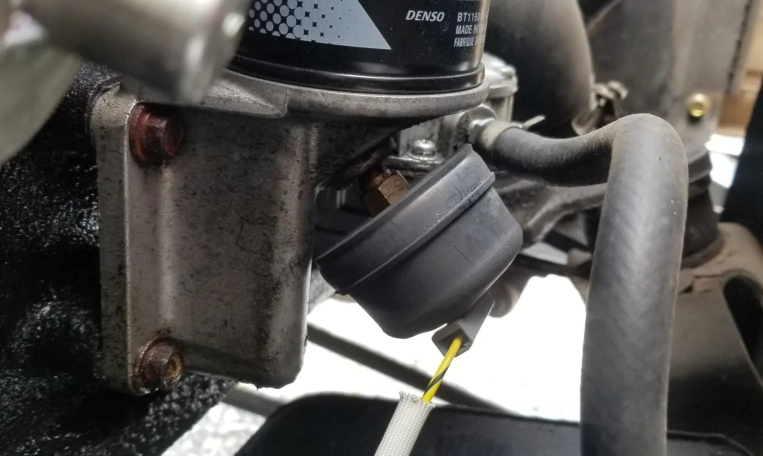

- i have Reproduced the complete ENGINE WIRE No. 4 , including the rubber sending unit cover / cap / boot ...
- see ,
- this is the main issue and cause here , look at carefully the
2nd TECH. photo posted in this thread , the OIL FILTER right above when removed for a regular oil change , when un-spun looses ALL its oil , 1qt almost down and out all over the ENGINE WIRE No. 4 and the OIL COOLER HOSE in question re; the original thread starters question ........
- Oil Pressure Sending Unit Sensor Rubber Boot / Cover Cap & Sub Harness Engine Room Wire #4 Part # 82124-90A01 Restoration & Repair Kit BJ70 HJ60 BJ60 FJ60 BJ42 Fj40 FJ55 FJ43 - VintageTEqParts.com - https://vintageteqparts.com/products/copy-of-water-coolant-temperature-sensor-sending-unit-union-harness-repair-kit-rubber-boot?_pos=1&_sid=94e030d81&_ss=r
