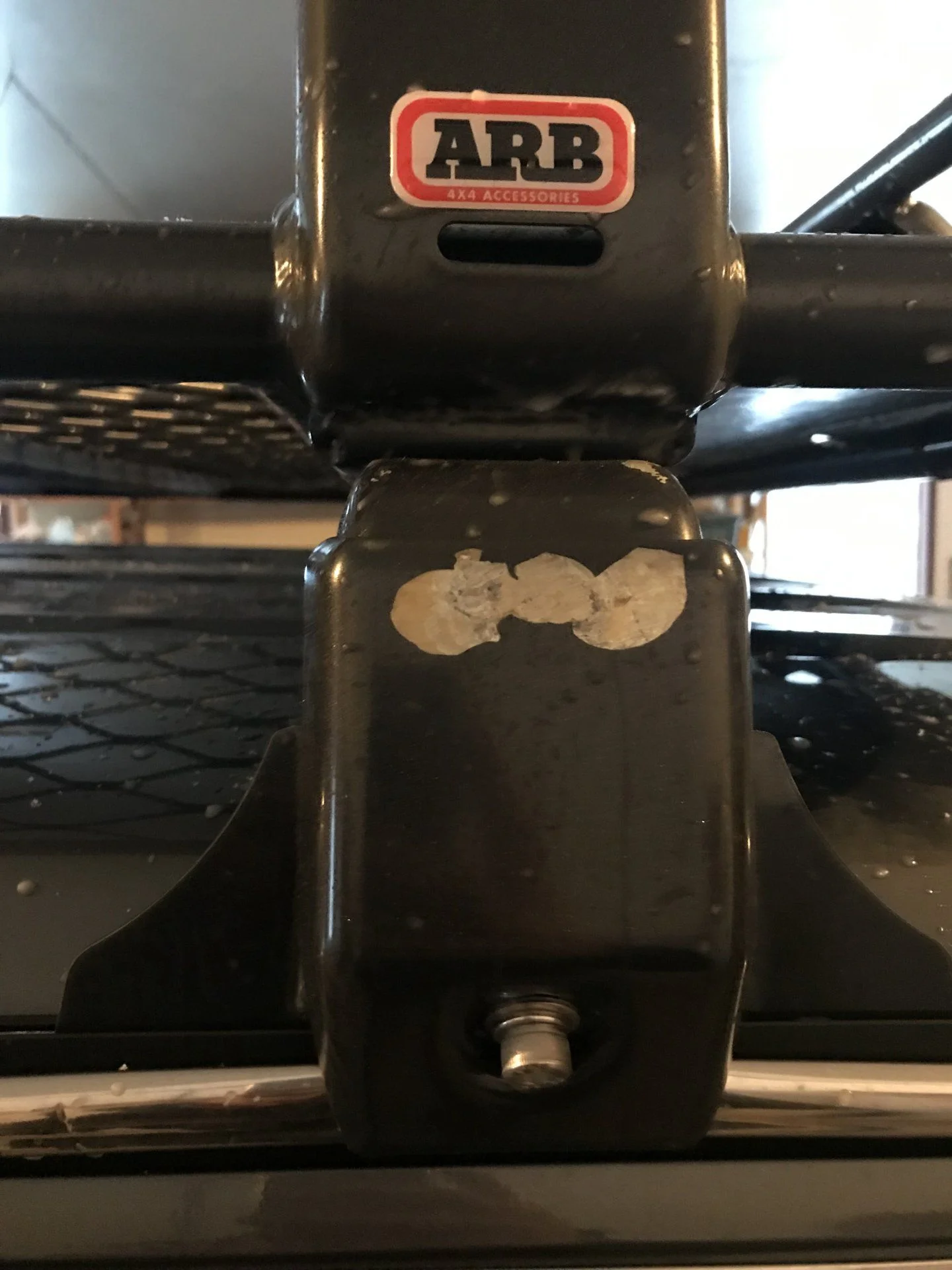

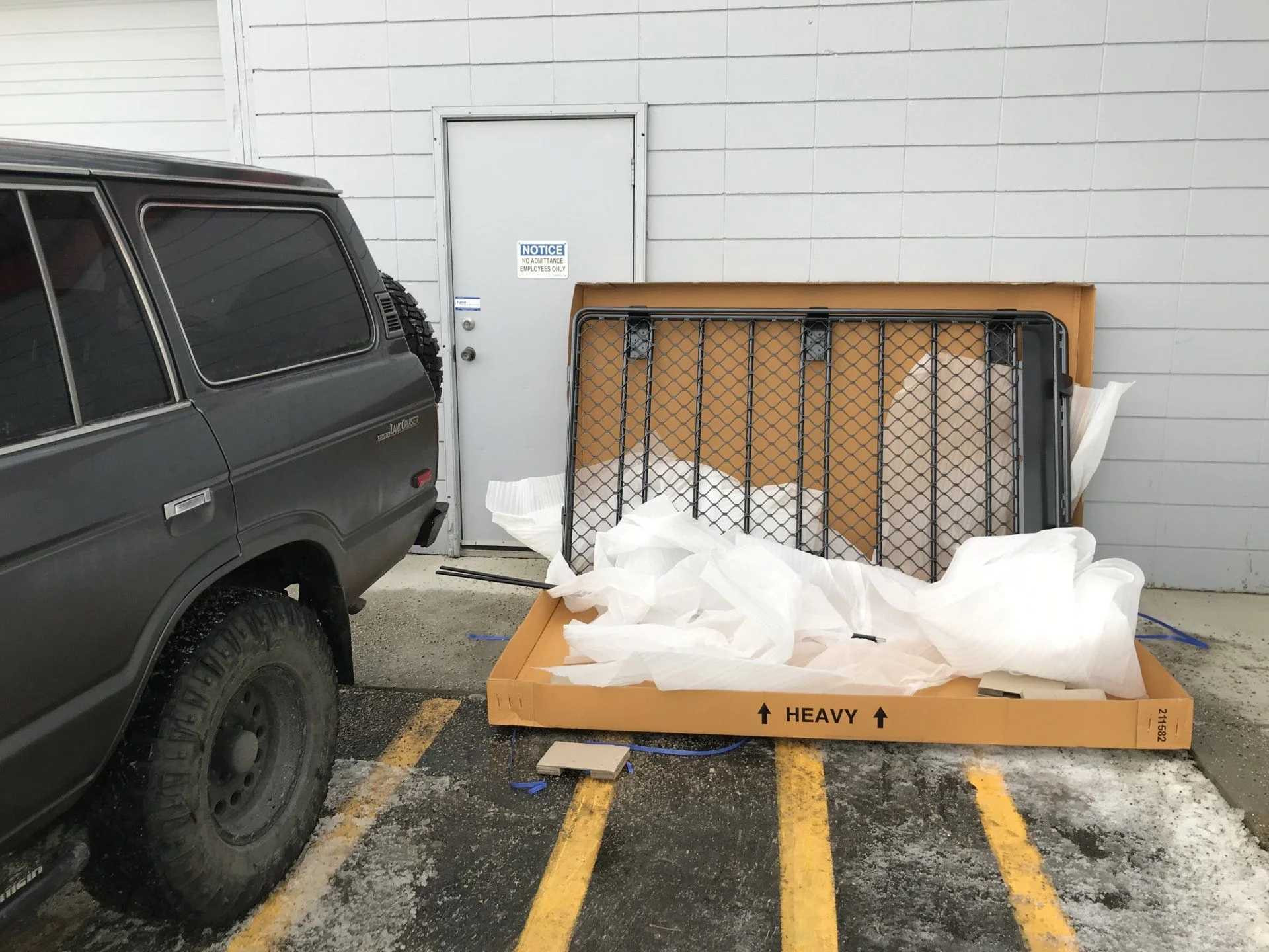

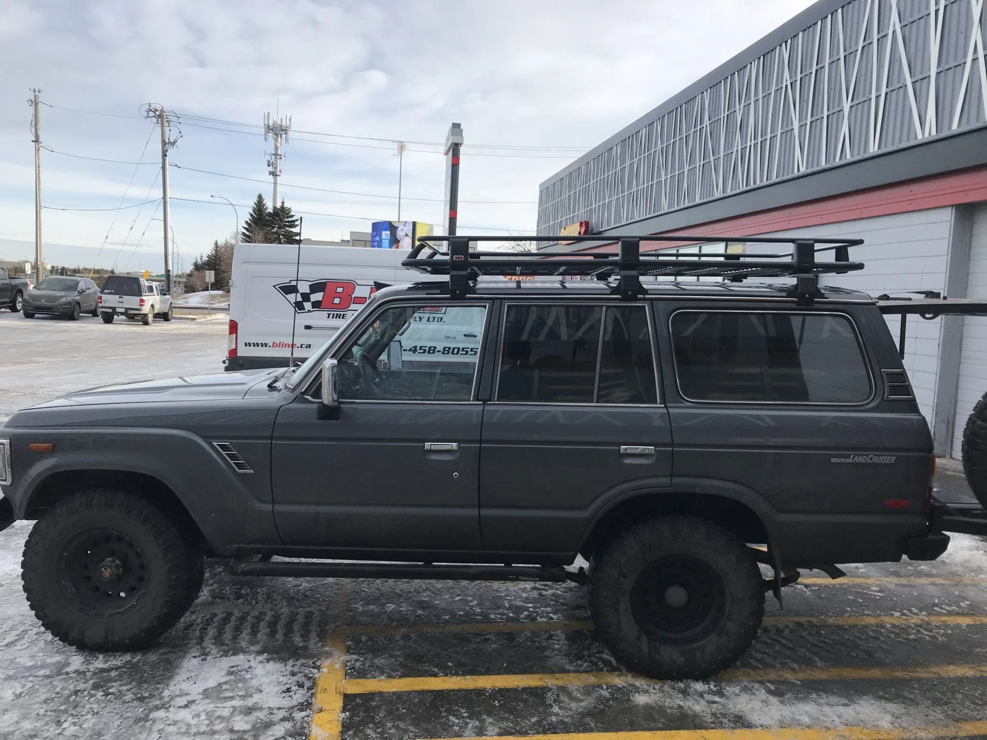

i need a roof rack though. i ordered it just before jason at trail tailor said that his rack might be back on the table. oh well. i like the arb one a lot too.

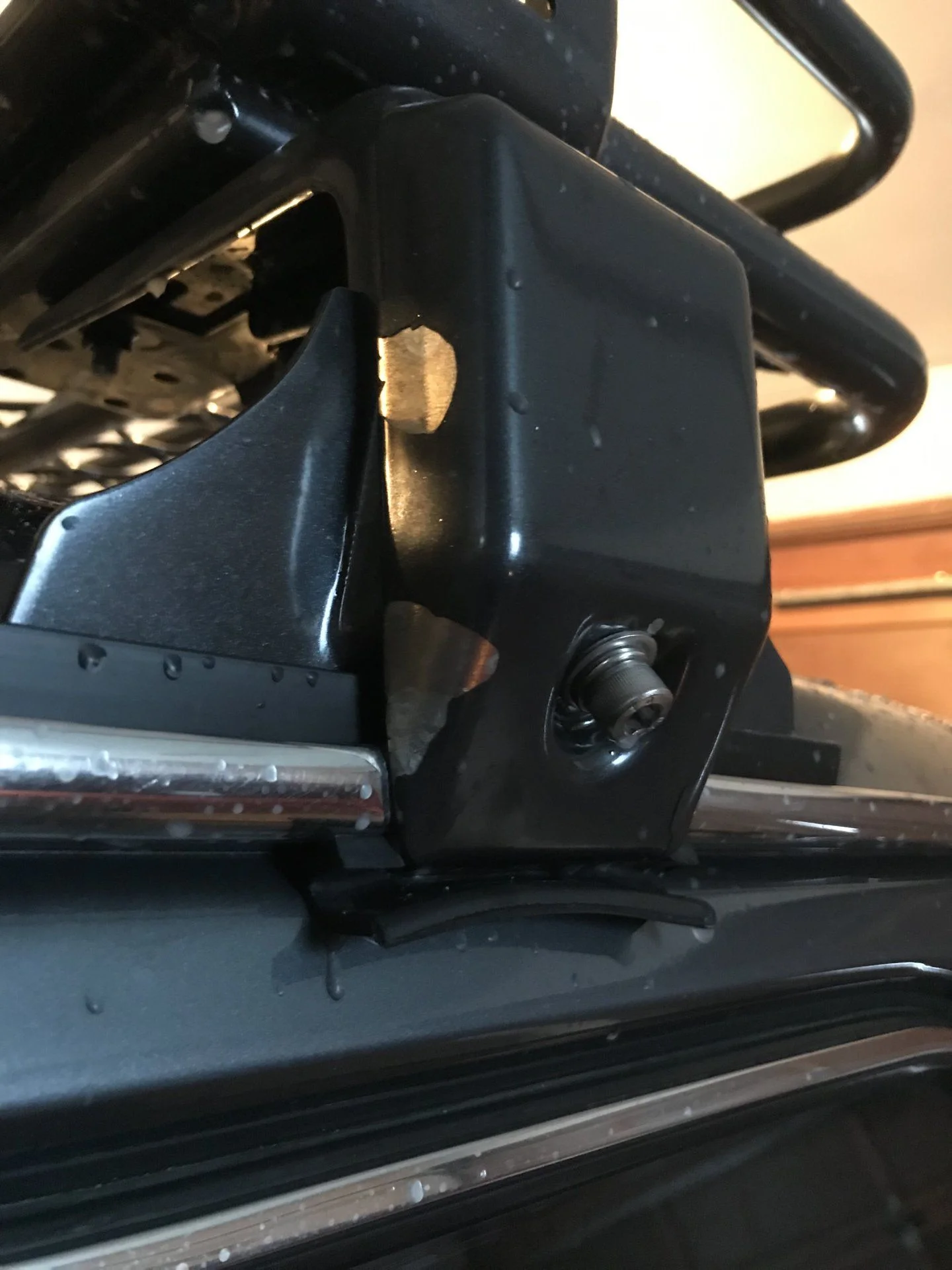

i will day it’s a pain installing in a parking lot by ones self. i did have a hand lifting it up there but it doesn’t fit in the trucks and i needed to travel a province away to get home so i made it work. might have scratched up the paint on the legs a little more than i’d like to admit but it worked out. now inhave to adjust it a little lower to make it more arrow dynamic:hillbilly:
i was in edmonton for an oilers game anyway but it was also $800 cheaper than in sask by the time i got it from a higher volume 4x4 shop, saved some tax and saved freight charges. so it was worth it

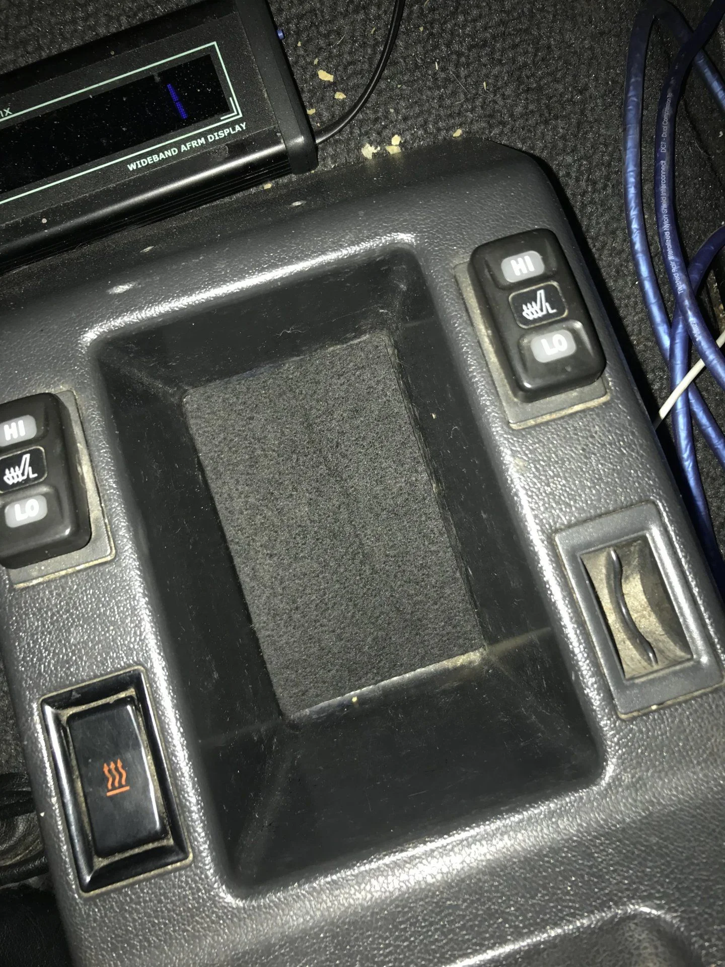

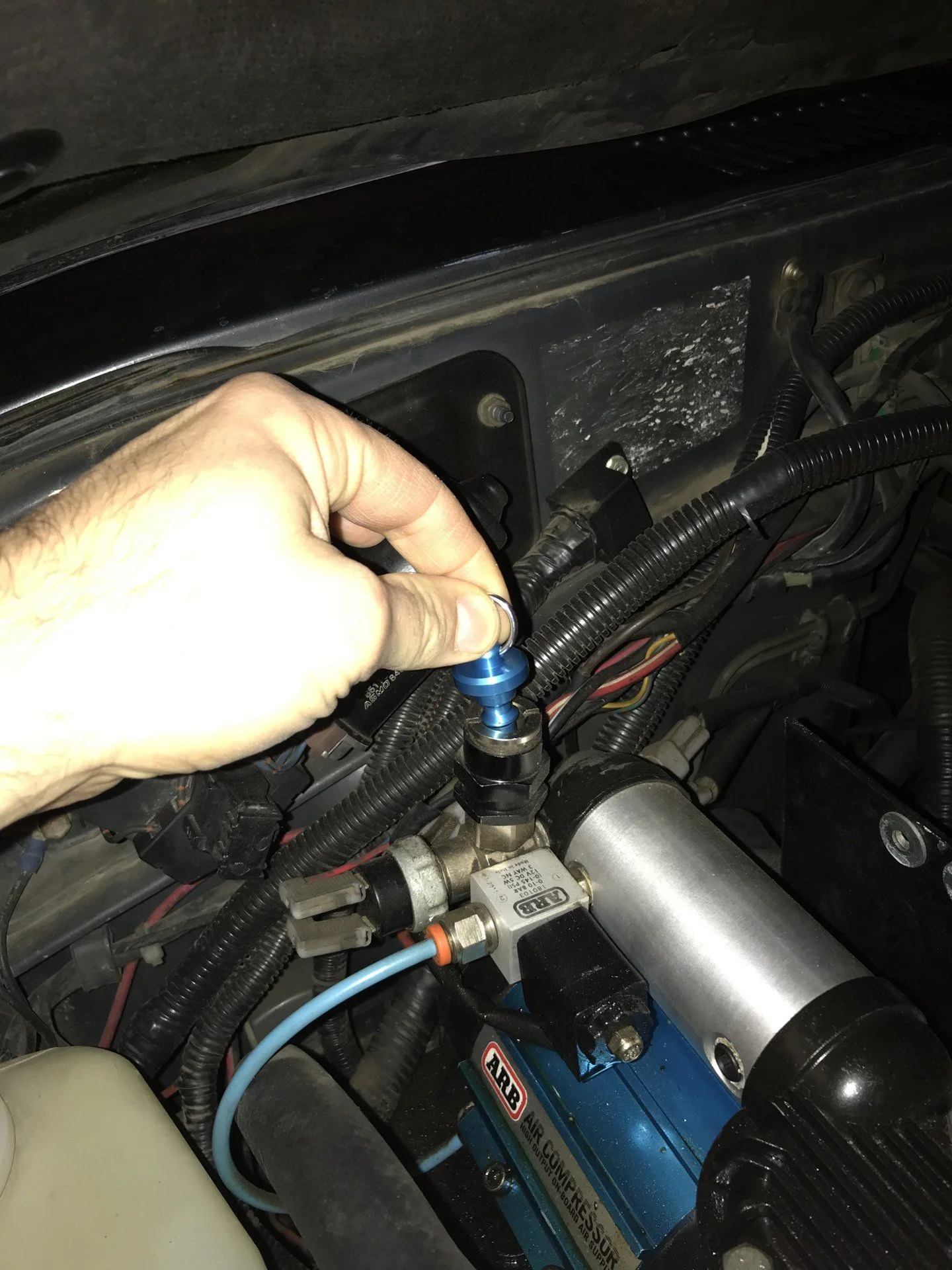

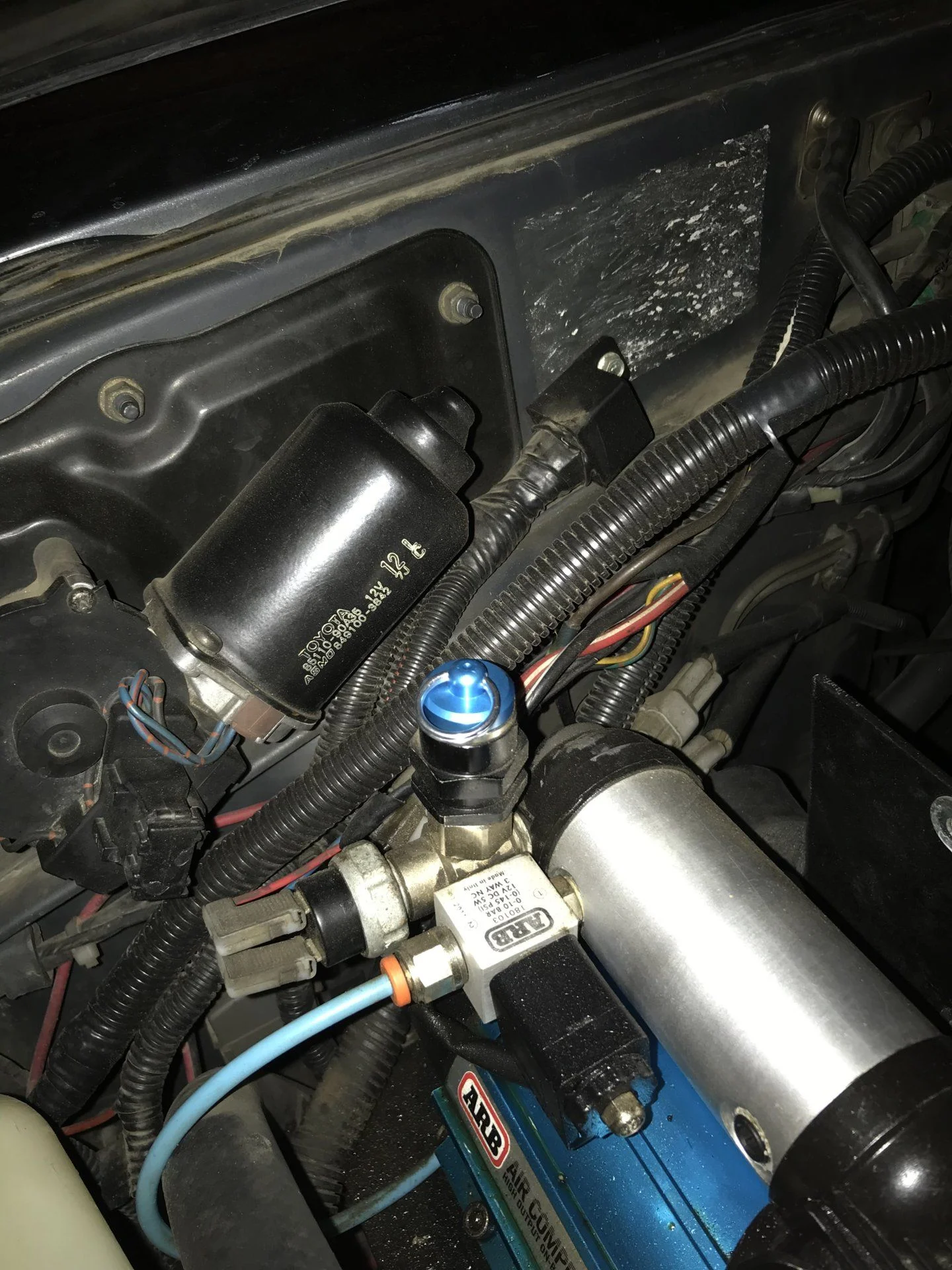

i few little items from witsend came today. arb “soother” to keep crap out of the air connector, a pad to keep stuff from rattling in the center console, a CB radio mic holder (not installed yet) and a poster to hang in my shop!!

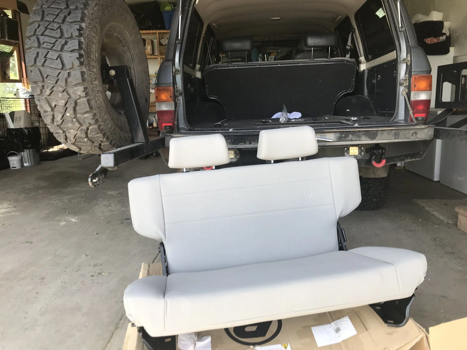

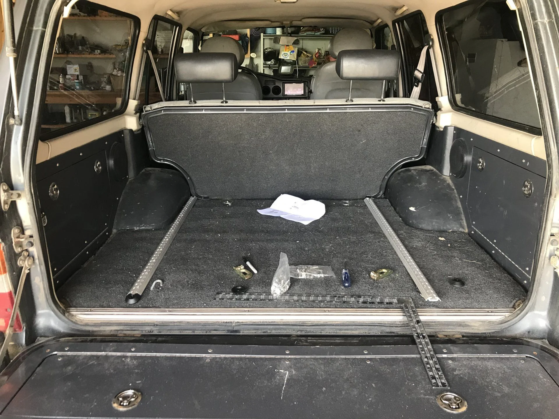

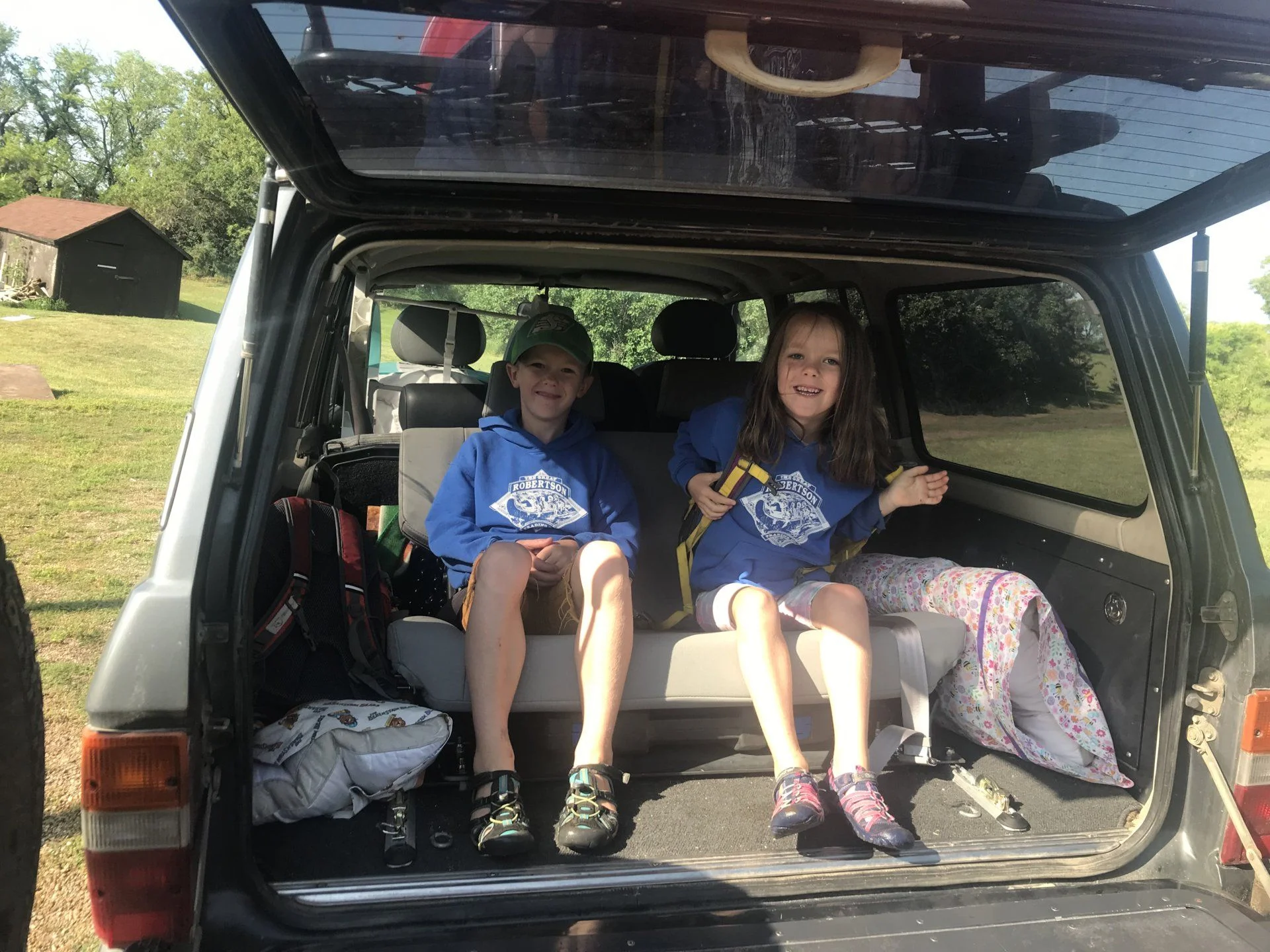

my wife and i also started fostering so we have another little bum to find a seat for. i’ve always thought a third row would be good for my kids anyway. it’ll also give me some more tie down points. here’s what i have in mind.

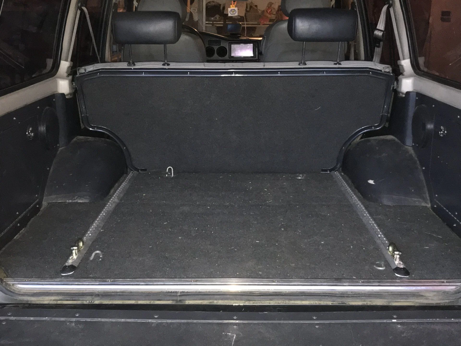

i’ve collected some parts. now just need to get some steel to build a bracket. i’m using super track (otherwise called L track i believe)
it’s a fold and tumble seat from best top. actually pretty comfortable. i’ve ordered some seat belts from seat belt planet.

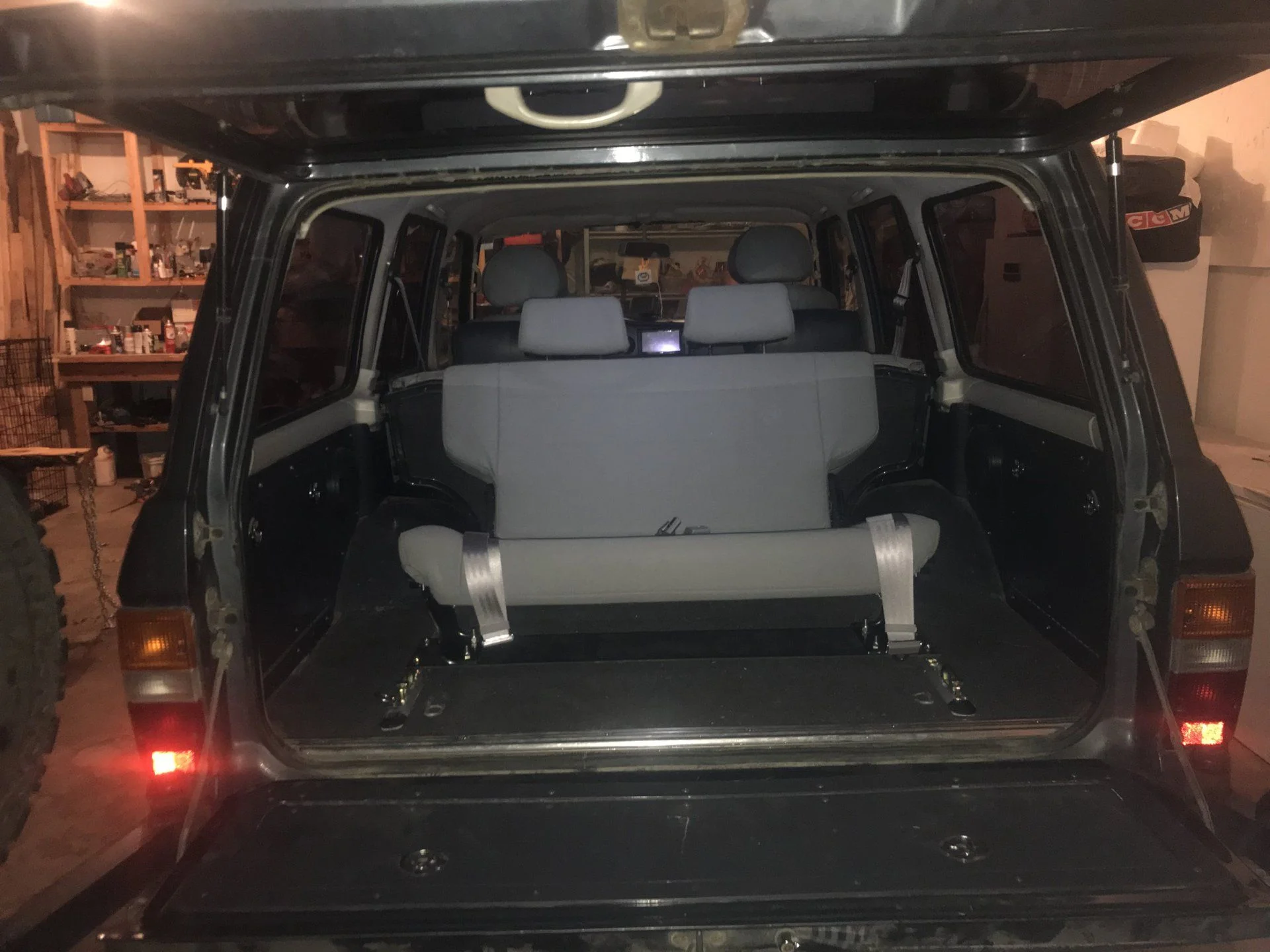

super track is in. i started cutting steel for the seat bracket but ran out of steam. hope to finish it tomorrow night.
drilling holes in the floor is not easy and i just kept hoping not to hit a cross member which i did twice. no way to get a nut on the bolt that way so i had to use a couple nut certs just to seal up the hole. i added extra bolts as i just don’t trust them to hold like a grade 8 bolt and big washer from up underneath. i then used a spray sealant paint over the bolt and nut to try to waterproof them
here’s the finished third row. ill tweet things a little when i pull it out. i have to paint the frames. over all i’m happy with it. it’s solid and i can even sit in it. i’m 6’ 2” and my head doesn’t quite touch the roof. i’d need more leg room on a long journey but it’ll work well for kids for now!!

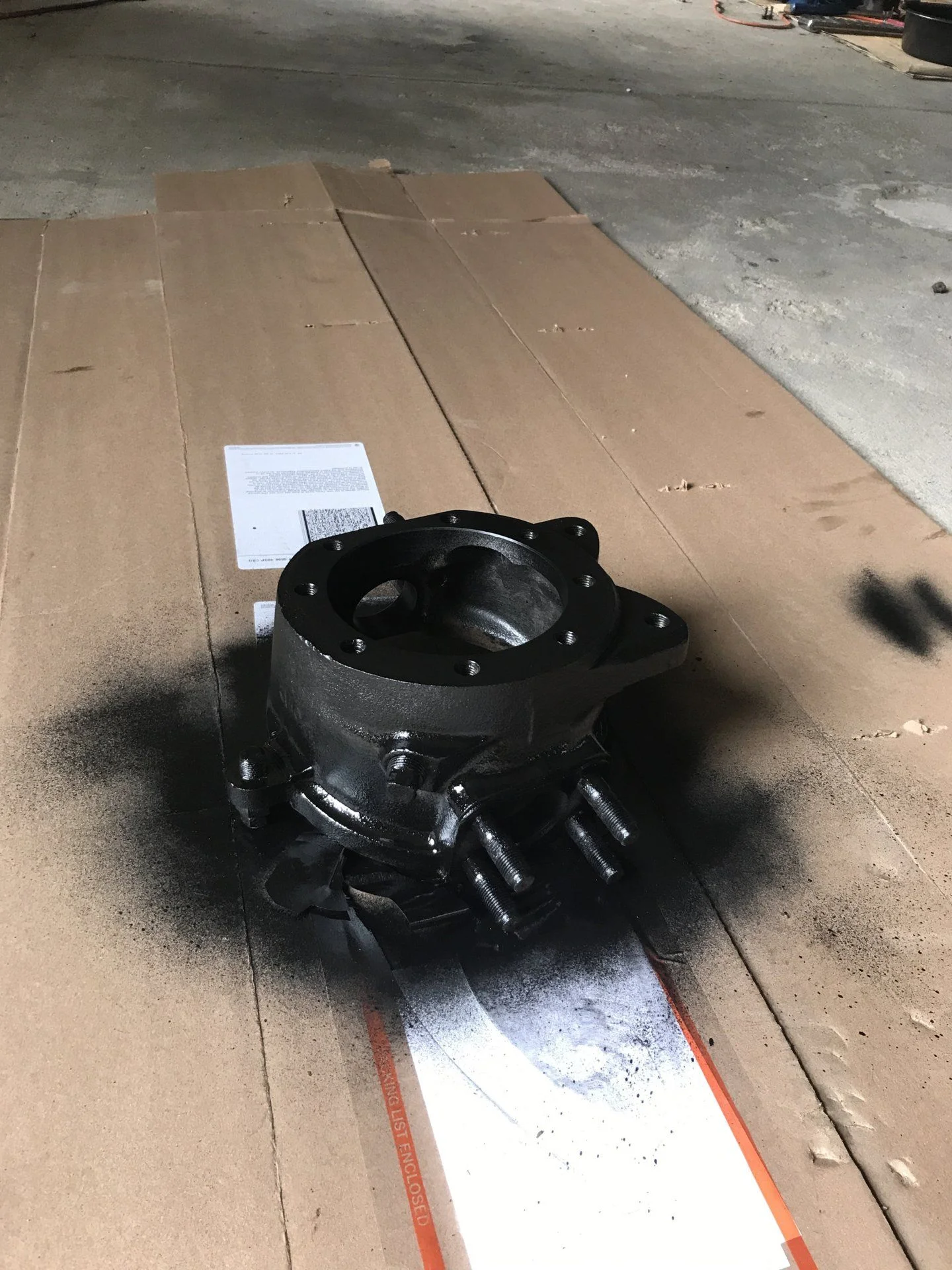

i got it all apart and new heavy duty inner seals from cruiser outfitters installed and new trunion races in. now i’ve lost interest in cleaning stuff for the night so i’ll pick it up again tomorrow. i’d like to get the parts all degreased and repainted before i put it back together. i also have to take my rotors to get turned. i’d like to get rid of the brake shake so this will take me a little while to put back together but hopefully it’ll go another 100k or more. new front shocks going it too while i’m in here

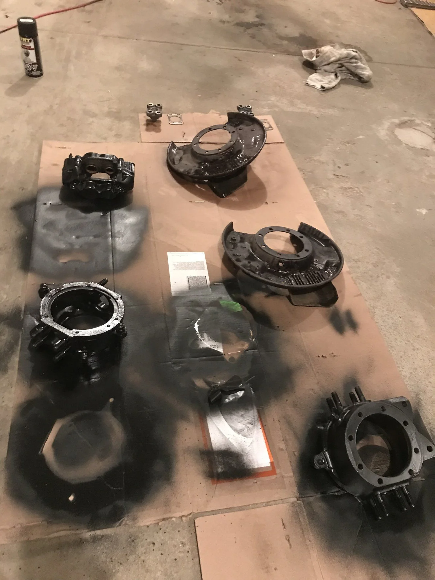

more blasting and painting. one calliper has a seized piston and three torn seals. probably just replace it next week. the other was replaced when i first bought the truck and still looks ok. that’s why i painted it. the backing plates have been blasted but are kind of rusty still so i used rust converter on them and will coat with a rubberized rock guard. i had to rivet one air scoop black on. so now we have to get a caliber and make some short hard lines and i don’t think my rebuild kit came with wheel bearings so i’ll have to get some of those too. otherwise i should get it finished up this next weekend
