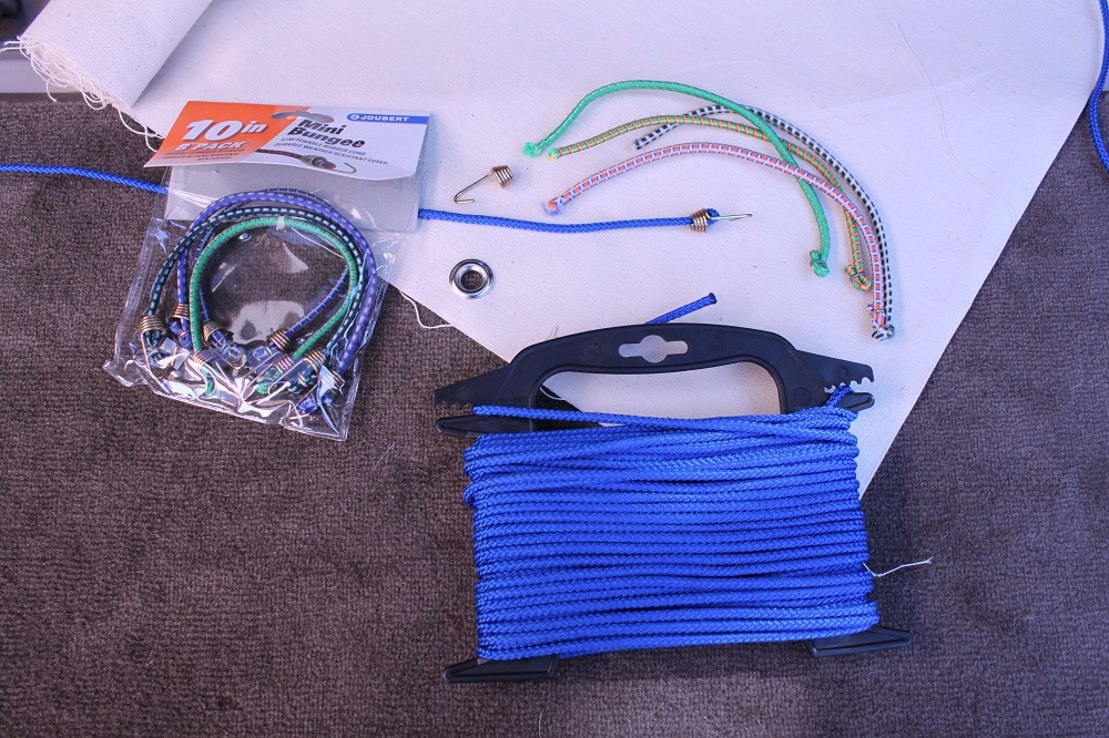

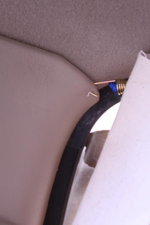

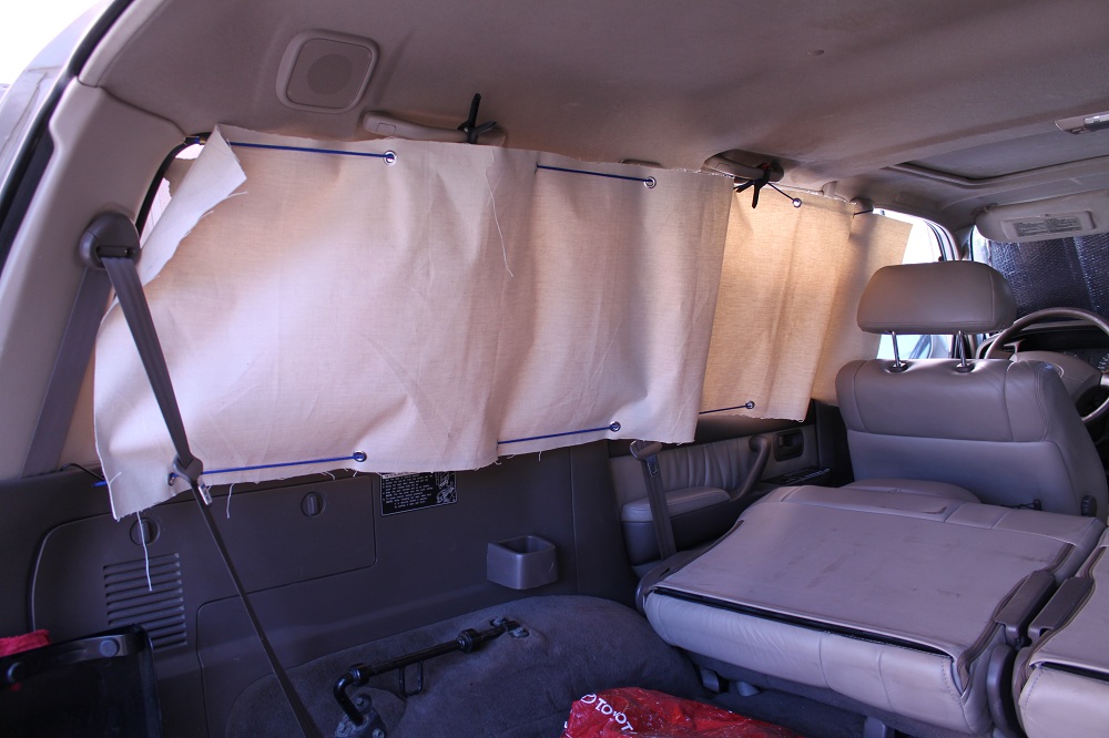

Great work with the snaps. Here is what I did in my 80
Nylon Rope and Bungie Hooks
Test Fit
Small holes in the plastic for the hooks
Final Look
And don't forget the screens to keep the bugs out. Magnets hot glued to screen material.

I tried bungee cord and the canvas curtains were too heavy for them so I bought the nylon rope at HD for $3 instead.

As for air gaps. It all depends on how you mount them. Using top and bottom cords it looks like there wouldn't be an air gap for the rear side windows in my 4runner. The tailgate window would take careful placement of the mounts and it would seal at the top and bottom. Rear passenger seat windows are a little harder. Adding a 2" extension to the bottom would allow them to seal. The best spot for the bottom line is a bit above the top of the molding below the window. ront seat side windows would take a bit longer extension, but still doable. The windshield ends up with a gap at the top, but the bottom could easily be sitting on the dash.
