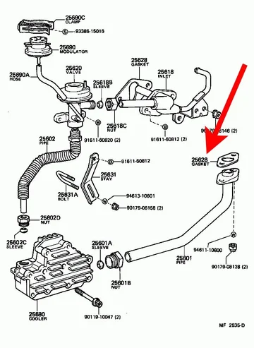

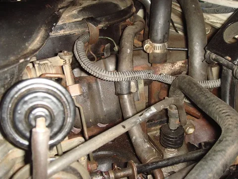

That loud snapping sound is an exhaust leak. An exhaust leak doesn't hurt anything but your ears... but you don't want to drive around like that. The exhaust manifold gasket or the EGR J-pipe gasket are the usual suspects.
Manifold gasket
EGR J-pipe gasket
Replacing the EGR J-pipe gasket is pretty easy. Might as well try that first. Otherwise the manifold has to come off to replace the manifold gasket. If you've never done it before, you can get it off in a day.... A few other things have to come off first before the manifold can come off. Everyone who has done it, had to do it for the first time ... sometime. So might as well join the club.
