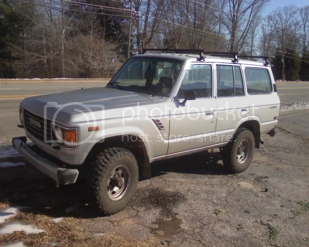

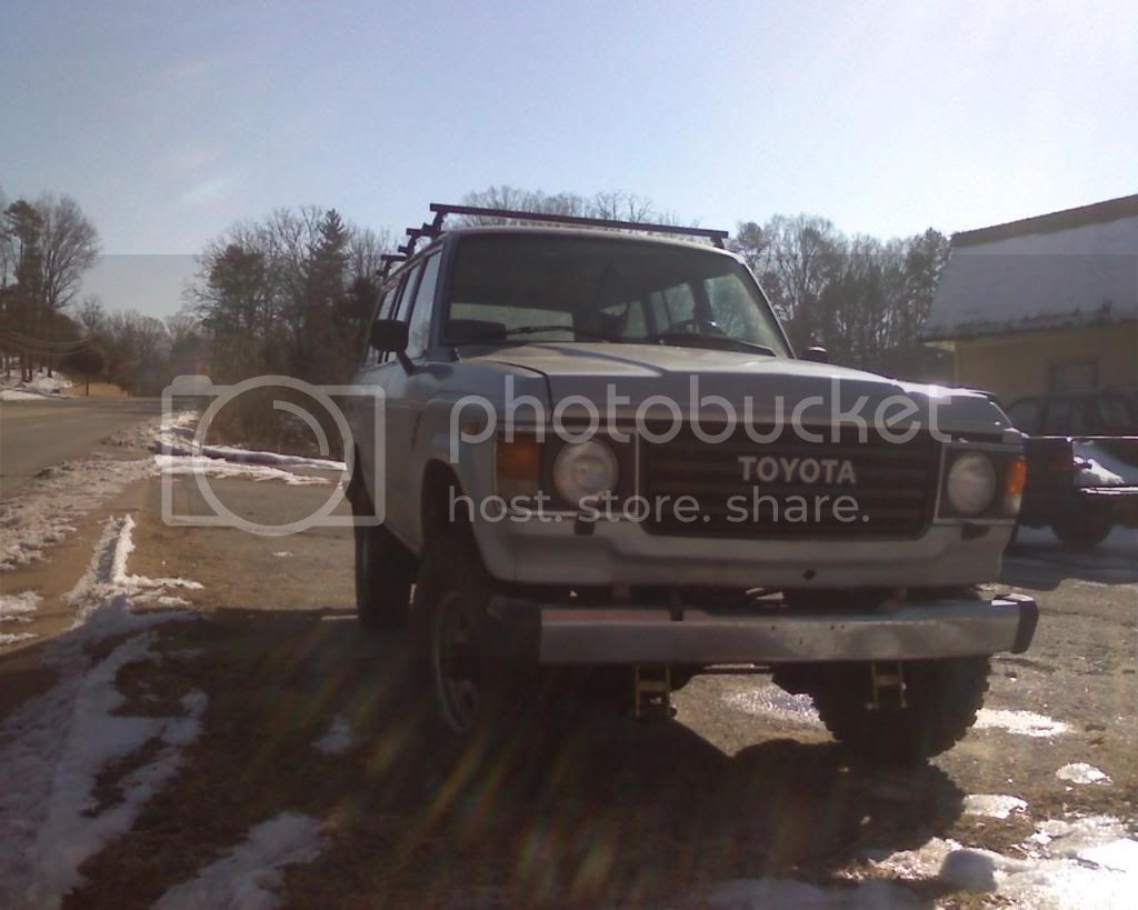

Thanks Gimpey for taking some pictures of this beast!
Glad to see it's coming together.

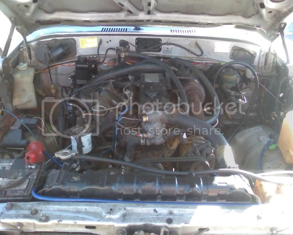

What did you end up using for a fuel filter on the firewall? I am still running just the one factory fuel filter, but I am looking at doing like you and Doug720 did with the filter/separator on the firewall.
Also, what is that black tank on the left of the engine with the screw top for?
Thanks,
Don
i used a racon style sediment filter for my pre injector pump filter.
The black tank is my power steering reservoir.

The engine is loud and shakes everything. I need to bring the idle up a bit more. I'm using the stock 2F motor mounts.

I'm using factory Isuzu motor mounts and I had to raise my idle speed up to about 800 to minimize the vibrations and it made a big difference. At 650 rpm I thought it was going to shake my windshield wipers right off the truck!
