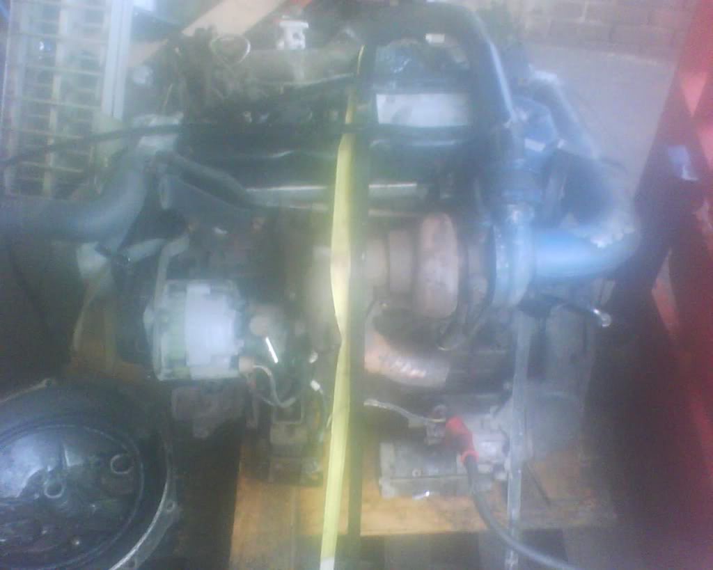

engine comes today

I'll start taking/posting pics when engine arrives today so long as i'm not knee deep in lawn mowers from all the rain we had last night
just pressure washed...sorry for the crappy pic
rigged up my old 2f radiator and got the engine running on the shipping crate today.
