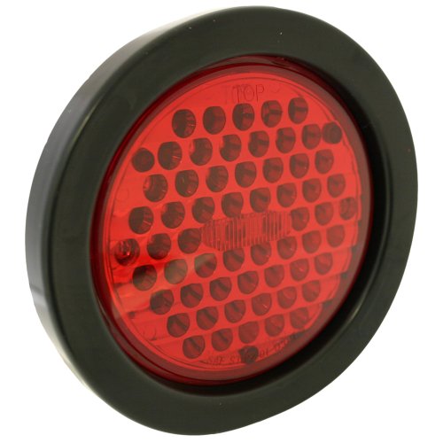

This way my departure angle is better, easier to open the hood, and the headlights will be converted to tail/brake lights. Plus I think it looks better this way, more double takes :D
I have some 7" lights to put in place of the headlights. We'll see what it looks like. I fear it might take away some of the 'look' with the head lights missing. Oy one way to find out.
That is exactly what I was thinking, What about just using Red bulbs with dual imputs for running/braking lights. I think it could be done and it would be AWESOME! :D

I like the idea of using the headlights as backup lights. You could put some really bright red bulbs in the white lensed marker lights. Then use the yellow signal lights as signals. Just a thought. Would keep the OEM look of the front of the 60.
