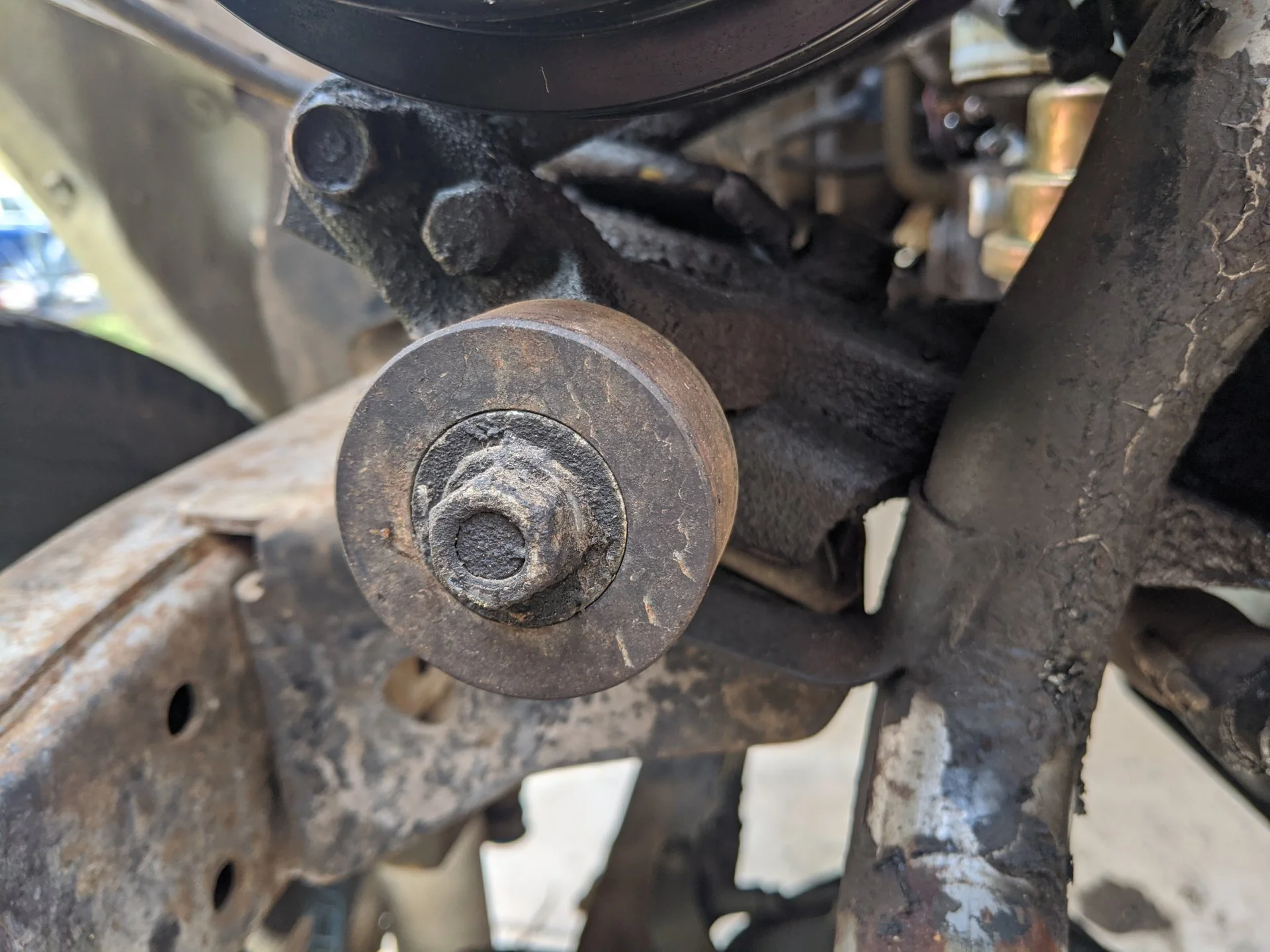

That short clip of yours sounds to me like bearing squeal from one of the accessories.
Typical exhaust leak will sound like a low-Tick-Tick-Tick
Does sound like high-pitch bearing squeal, from something exposed, like an Alternator or Idler. Best to isolate with mechanics stethoscope
Easy to check is the A/C idler bearing, if you have A/C.
