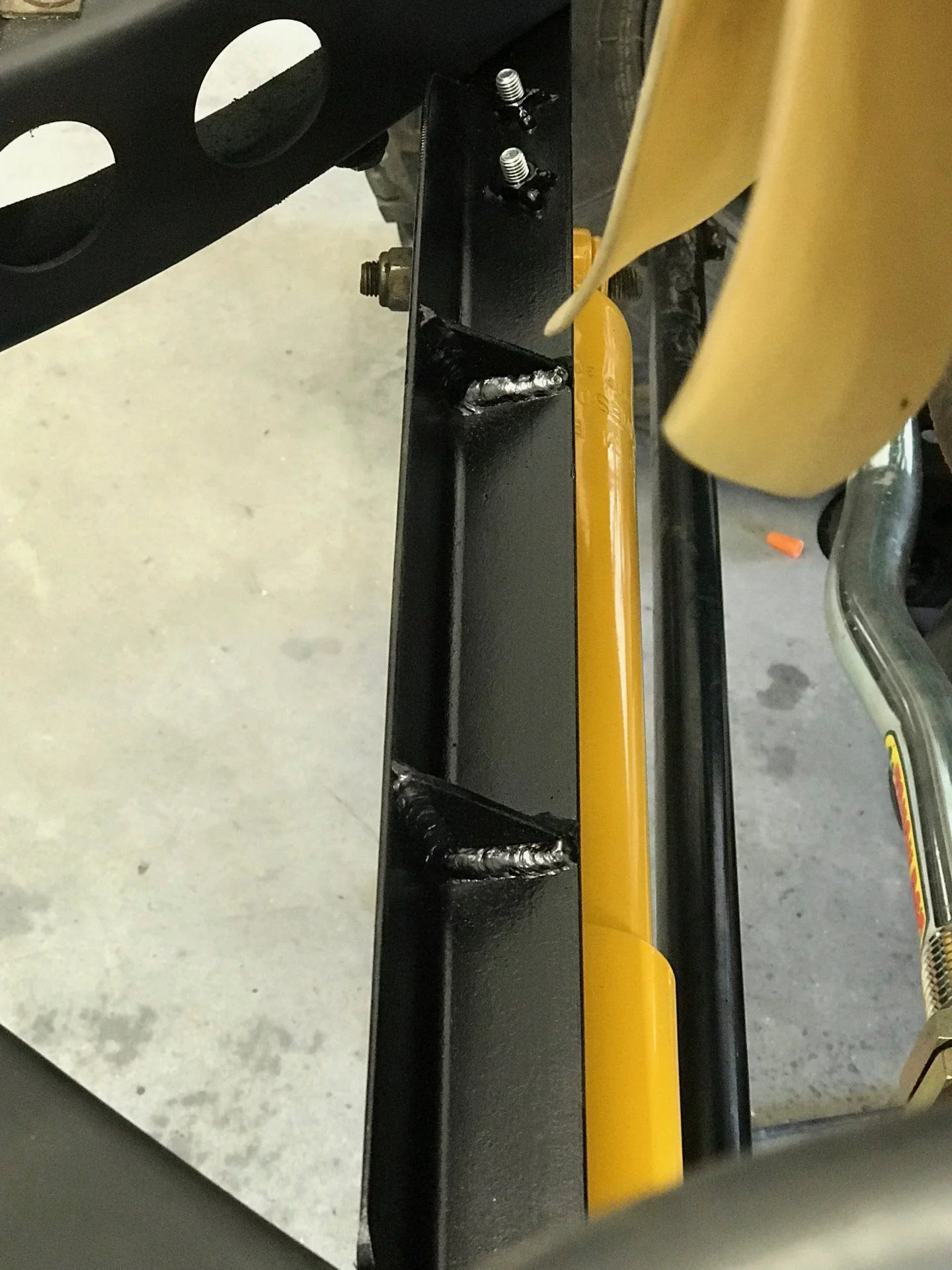

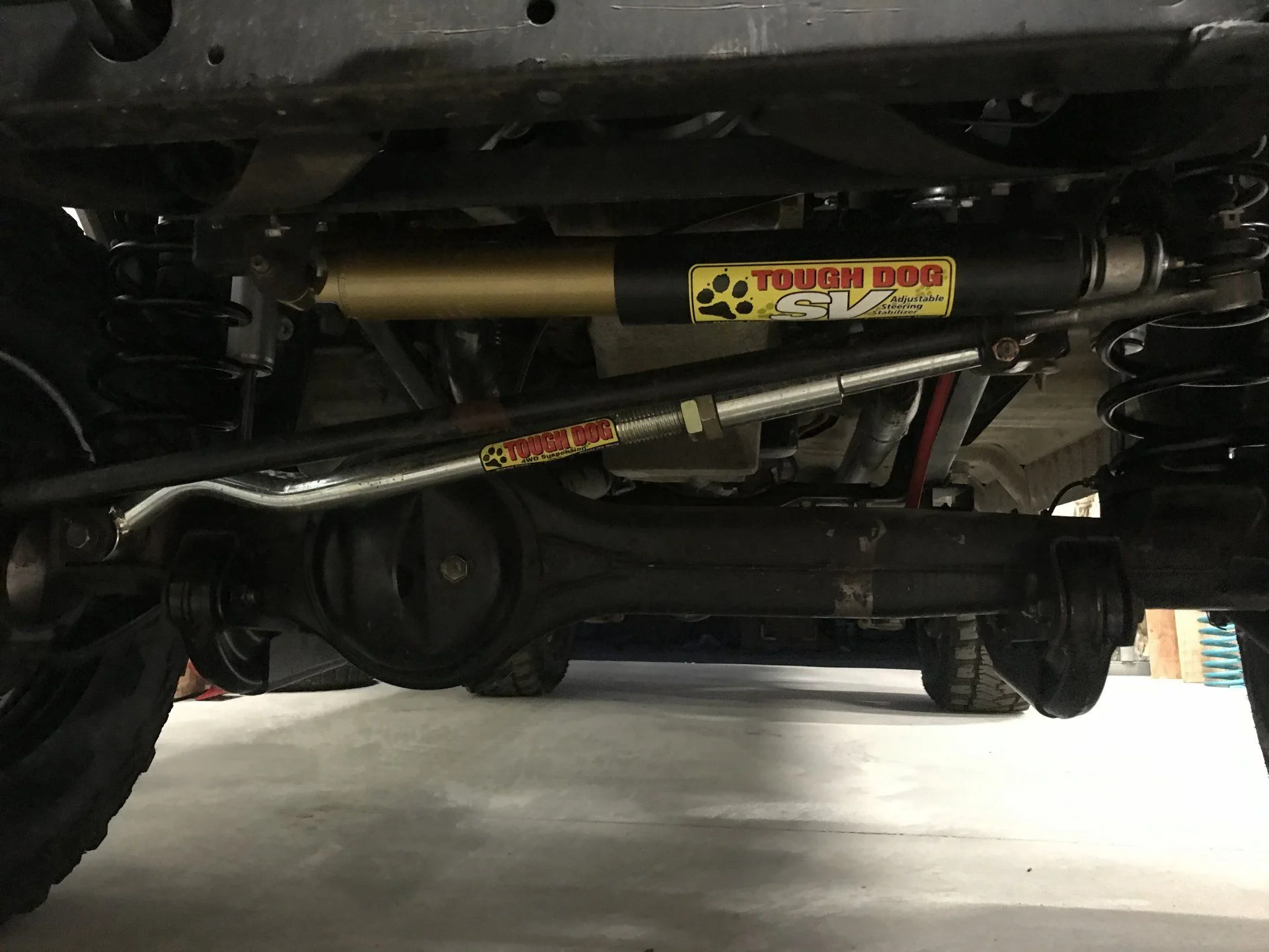

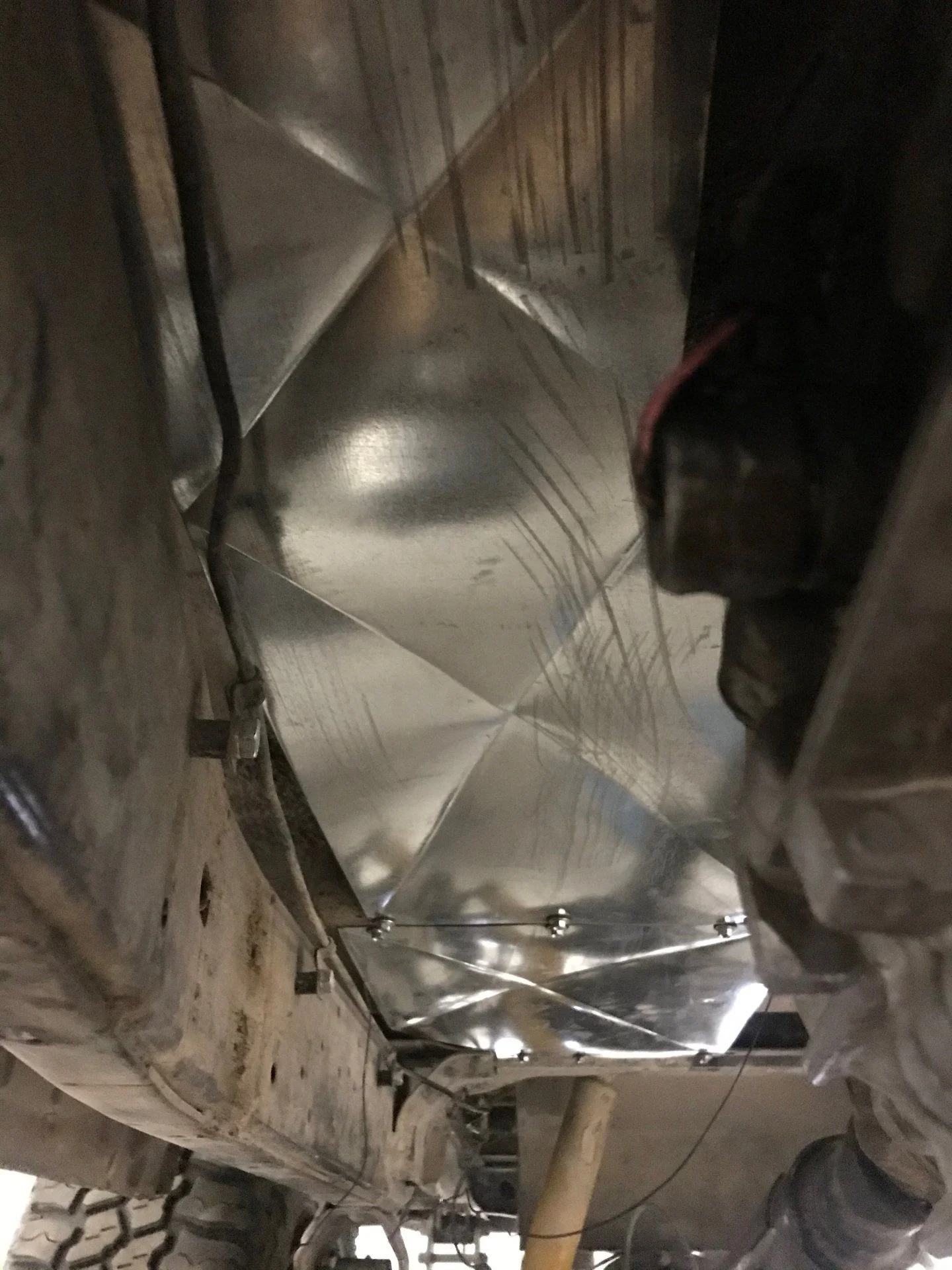

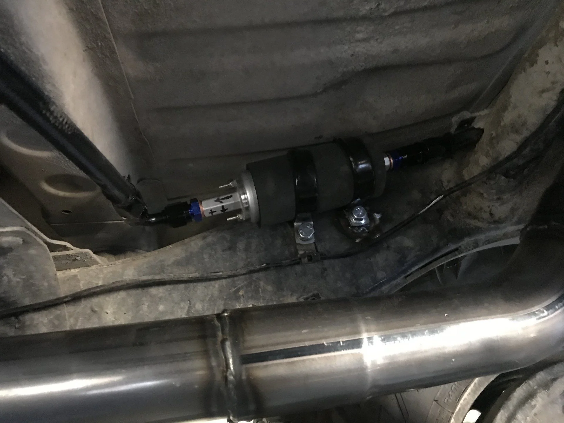

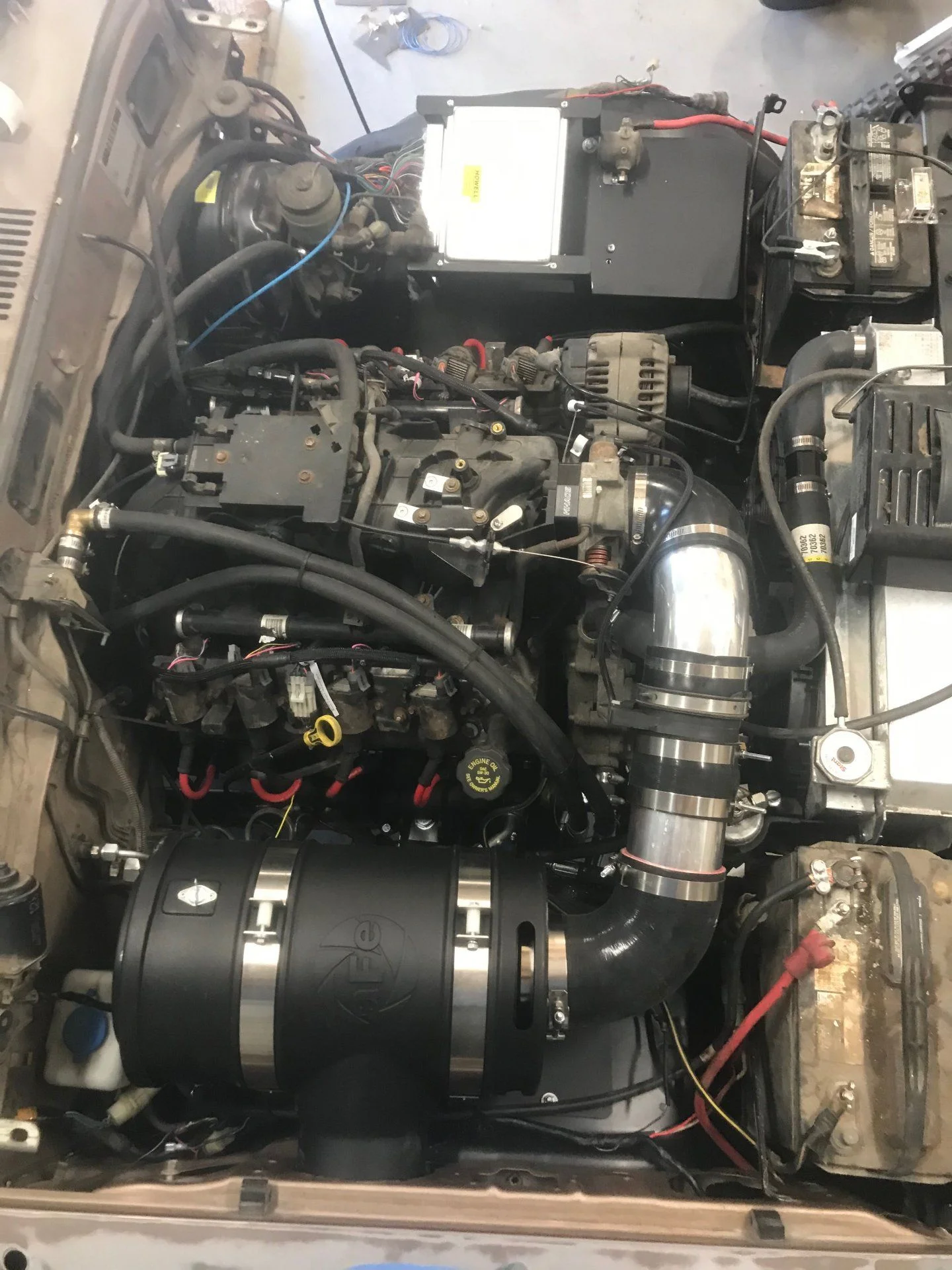

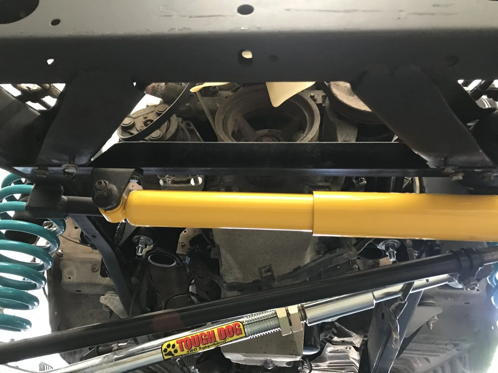

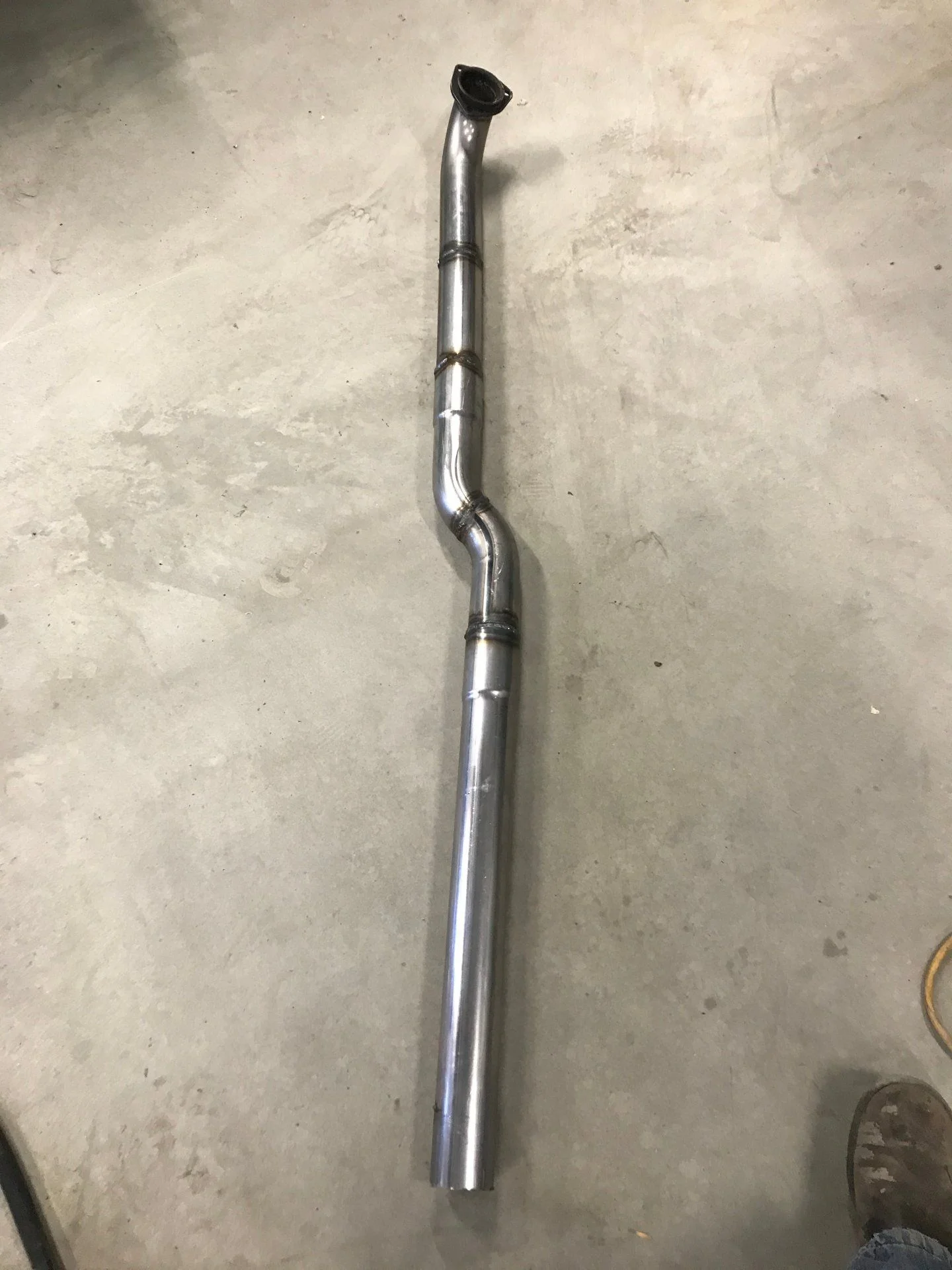

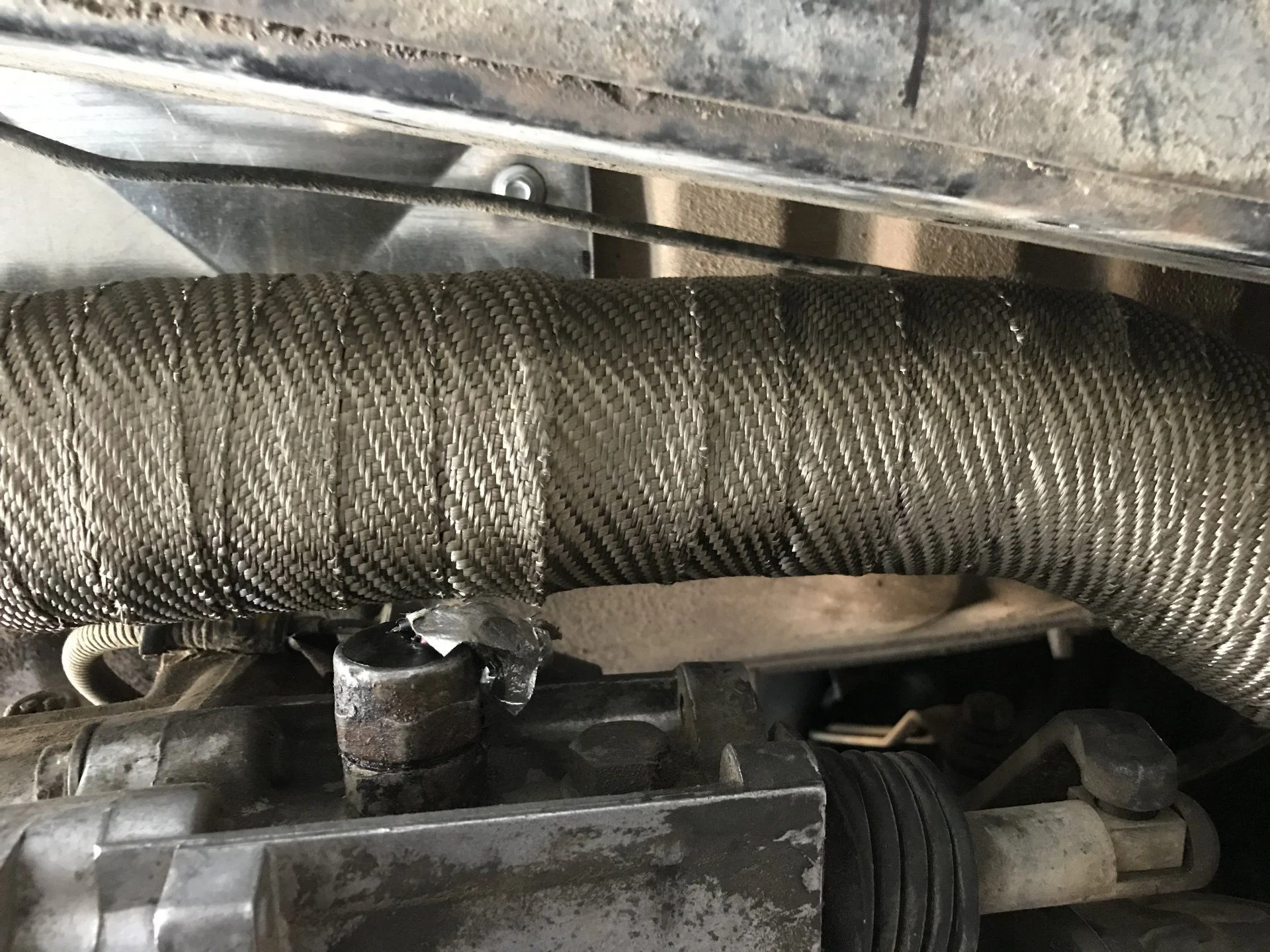

Well I've been working on a lot of thinks. I had to made a bracket for steering stabilize that had to move over 4"on the frame to us stock stabilize. Welded up the exhaust its awfully close on passenger side but came out nice. Before putting in the exhaust I made a heat shield for the floor board. I ran new fuel lines and mounted fuel pump, installed heater hoses, power steering hoses. I've ordered wiring harness a few week ago from Mosley motors so I hopefully get it running in the next couple weeks then I can start putting the front clip back on.

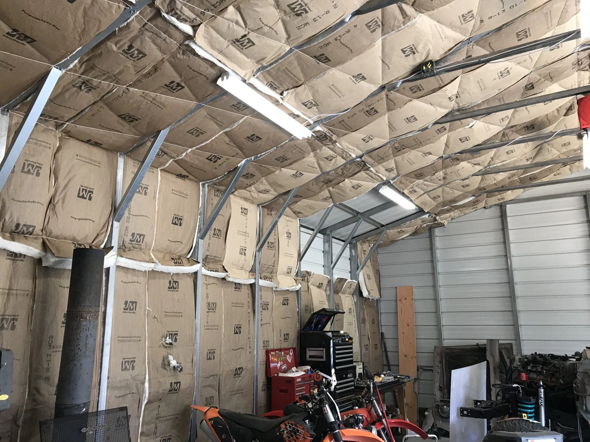

dry wall soon
I would pass on the drywall and go with 3/4" plywood. It will cost you more but will allow you to screw pretty much anything up on the walls you wish down the line.
Normally you only see drywall in a garage when you need a fire rated wall. Plywood or OSB is much more useful.

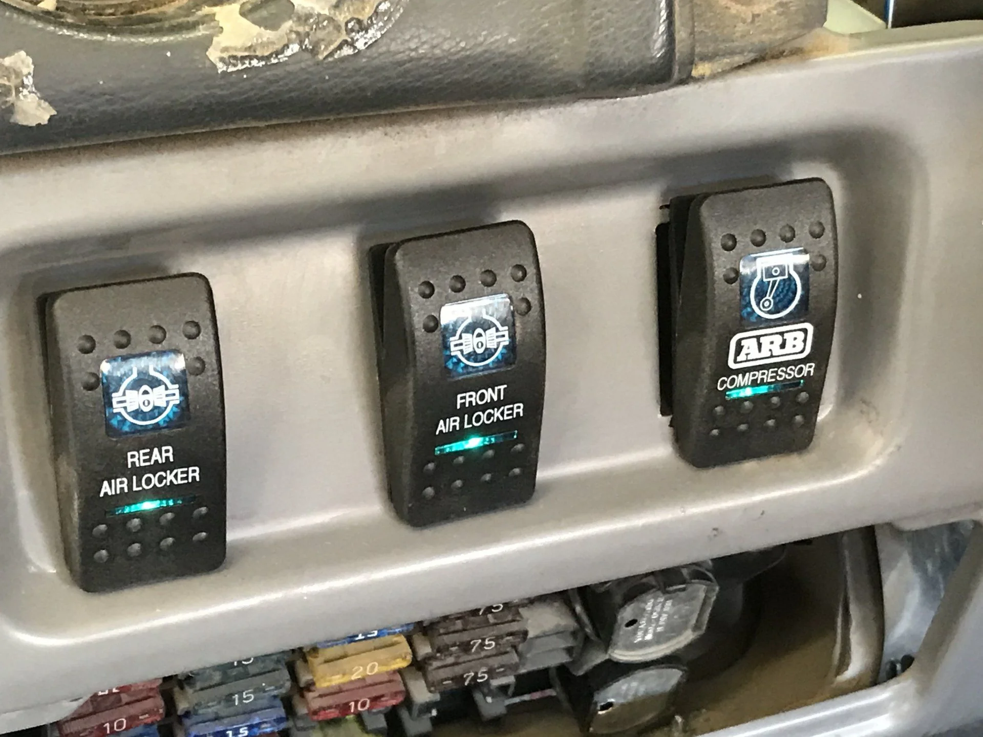

Add new speed hut gauges, twin ARB compressor and third battery for the fridge later.

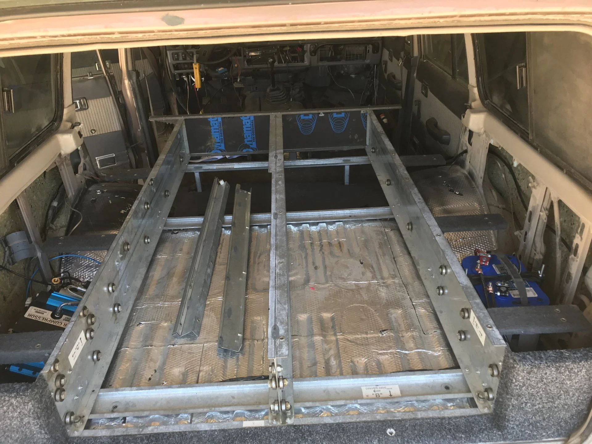

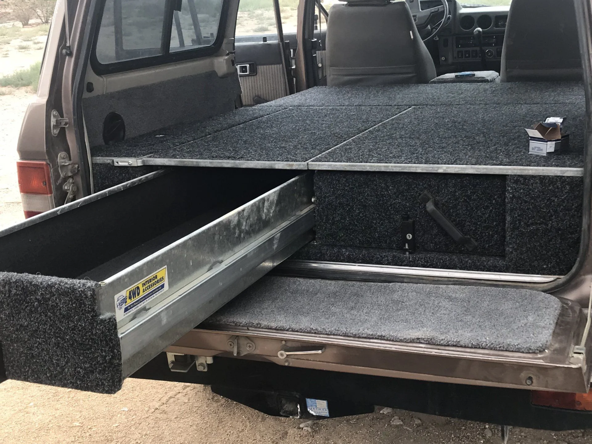

Reinstalled my drawers system in the back
All I need to do now is finish sanding and a paint job.

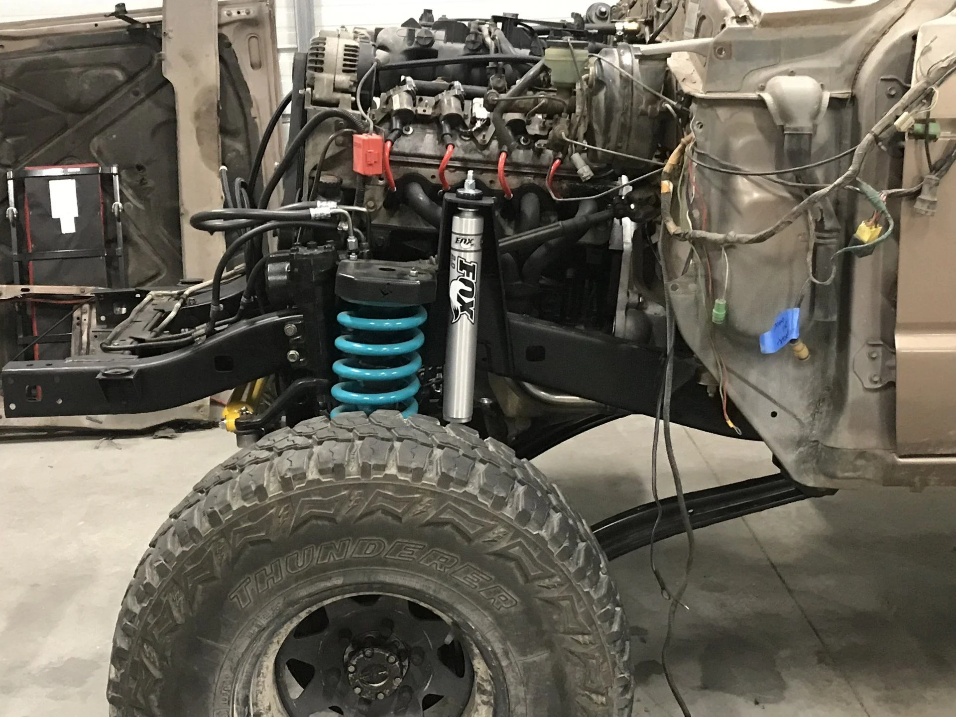

I had to change the front coils from Dobinsons because they where to stiff .I think it was do to the 200 + pounds less on the motor.
I put Icon variable rate 3 in lift for a stock fj80 and they work great it is so much smoother up front.

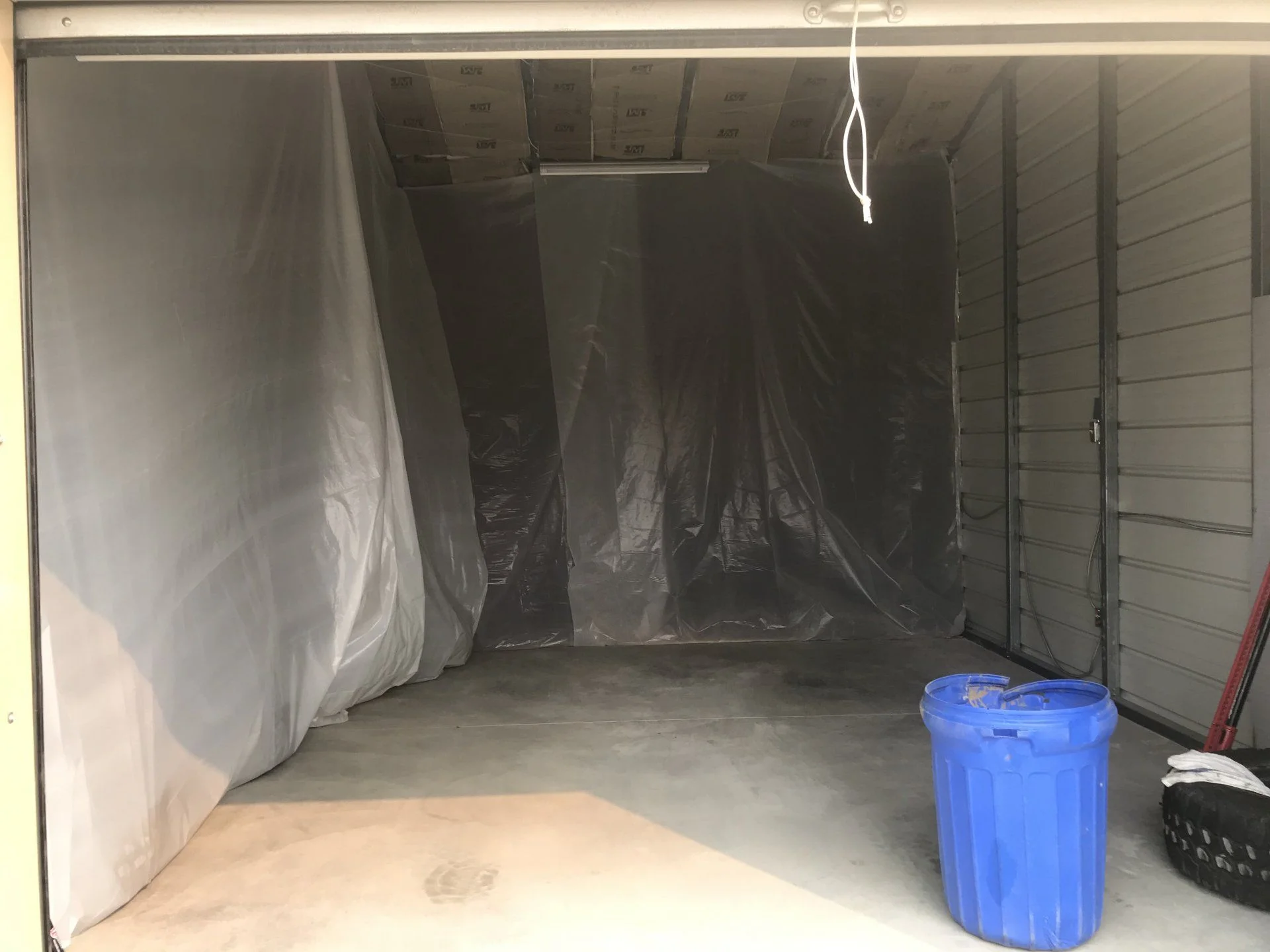

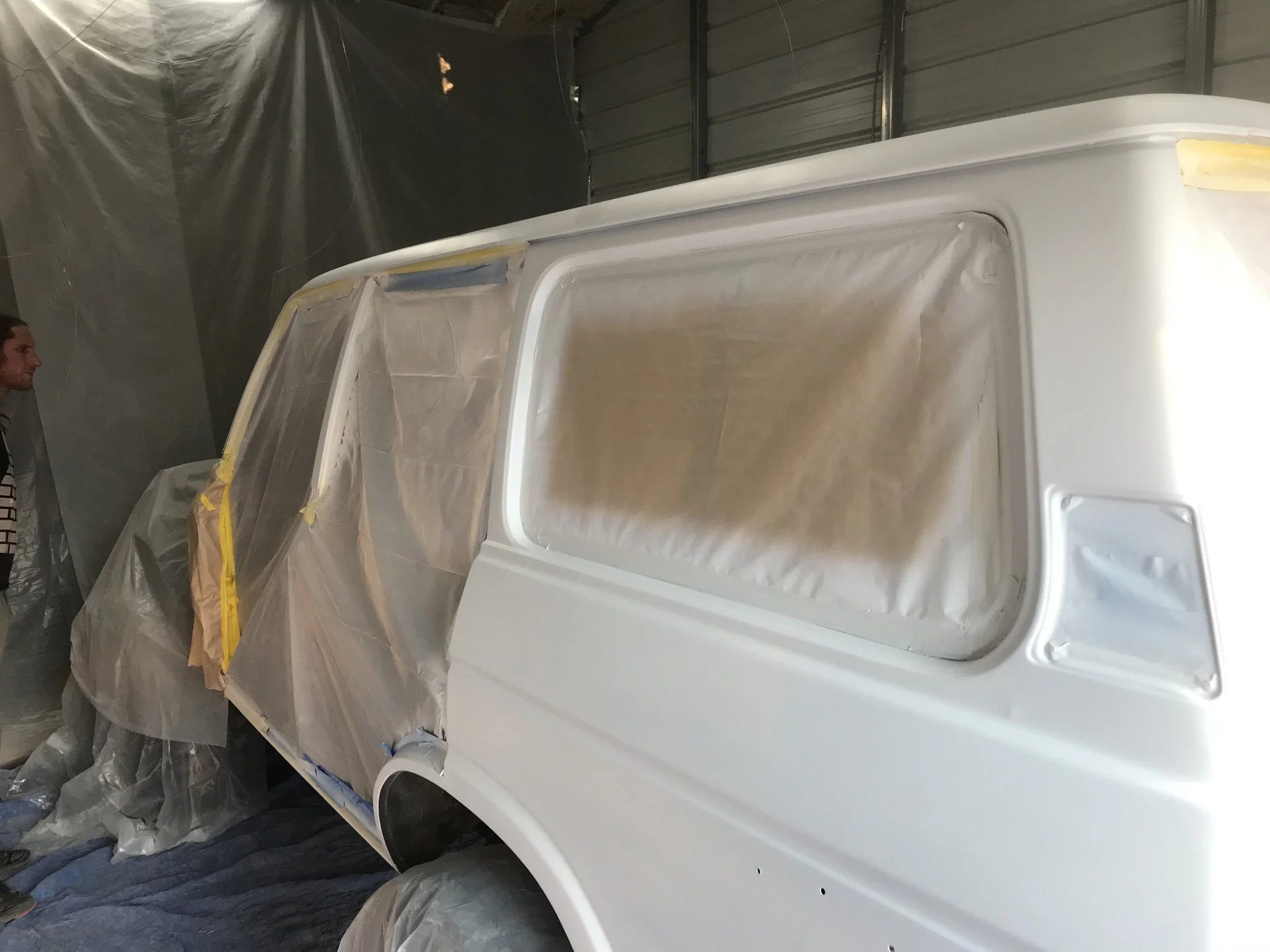

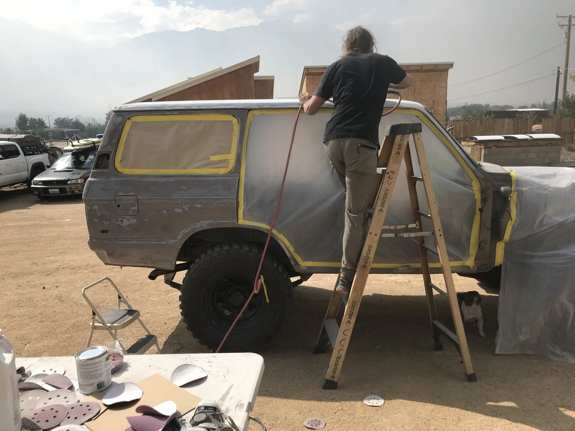

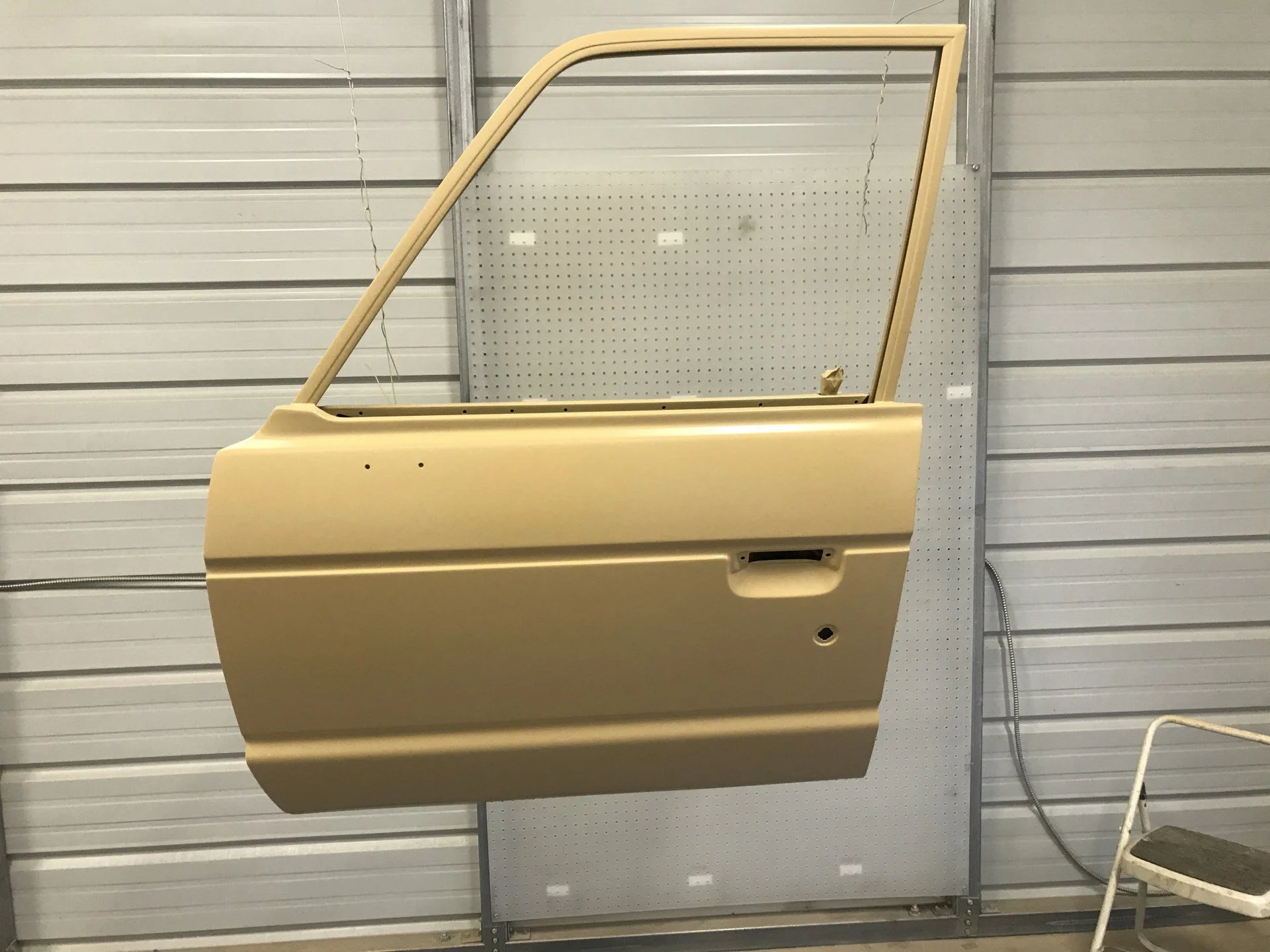

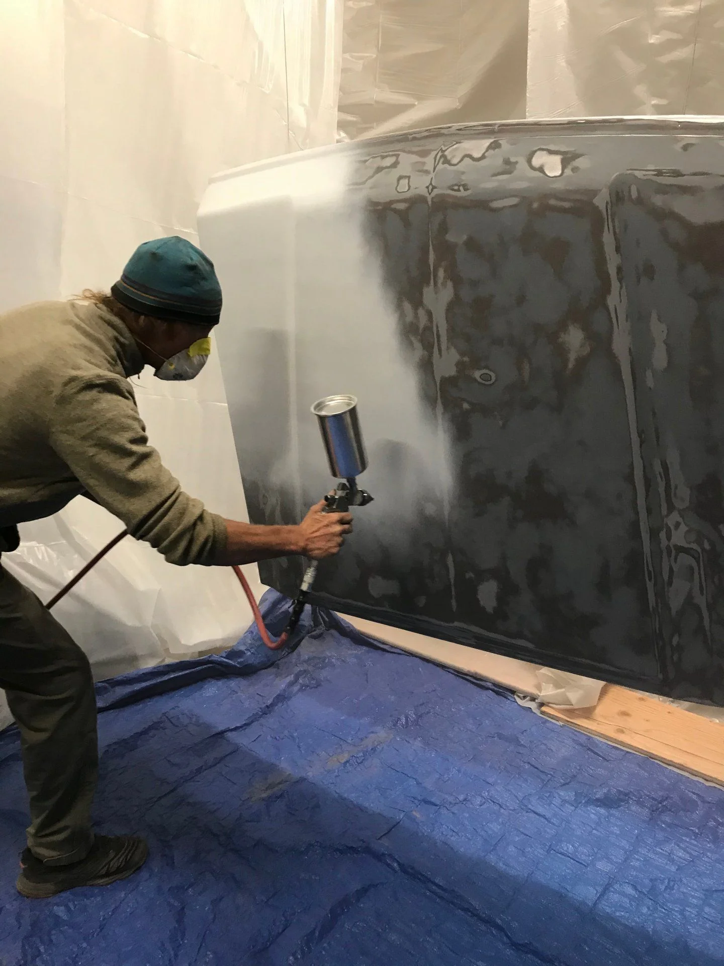

Here's what I've been up to made a paint booth in the garage. Sanded and primed and painted and cleared hot rod flatz desert storm tan. Did the rope trick on the fixed windows to get paint under the rubber. I'm thinking about paining the top white not sure yet.
