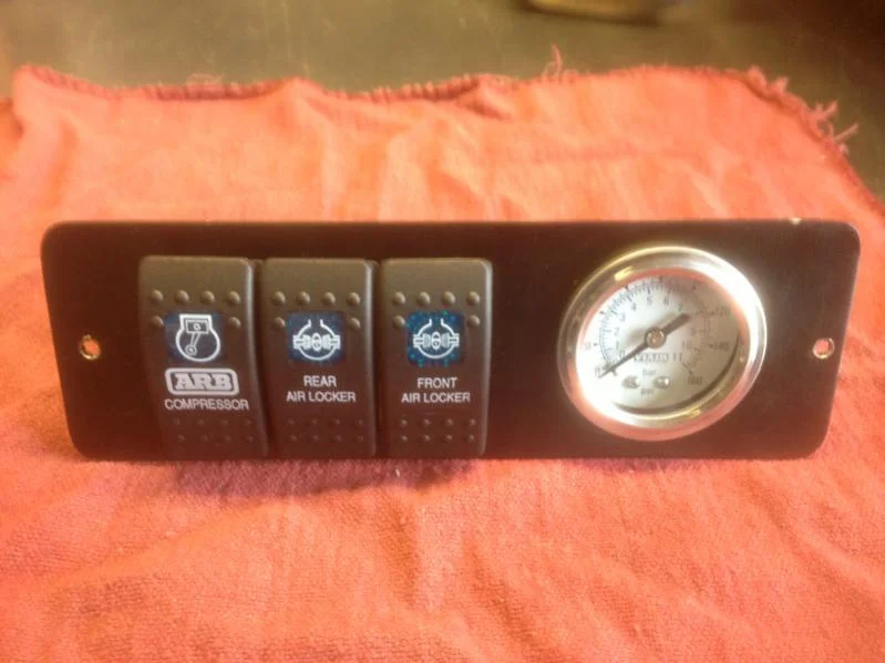

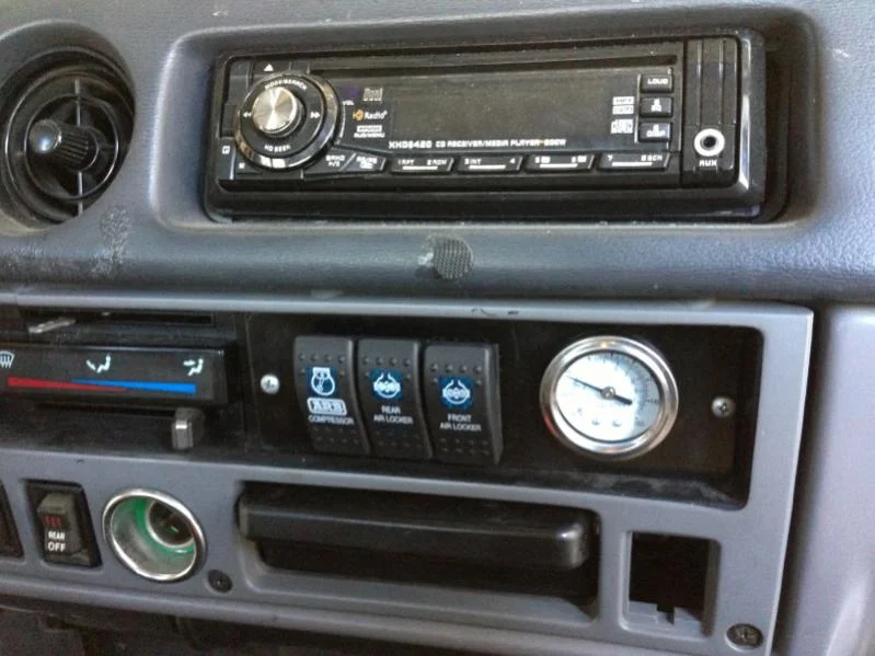

We've done quite a few ARB locker installs along with a variety of compressors. Over the years we've made a few different panels to mount the switches in the dash. Finally came up with a simple design that works. I'm sure we're not the first to think of this ......

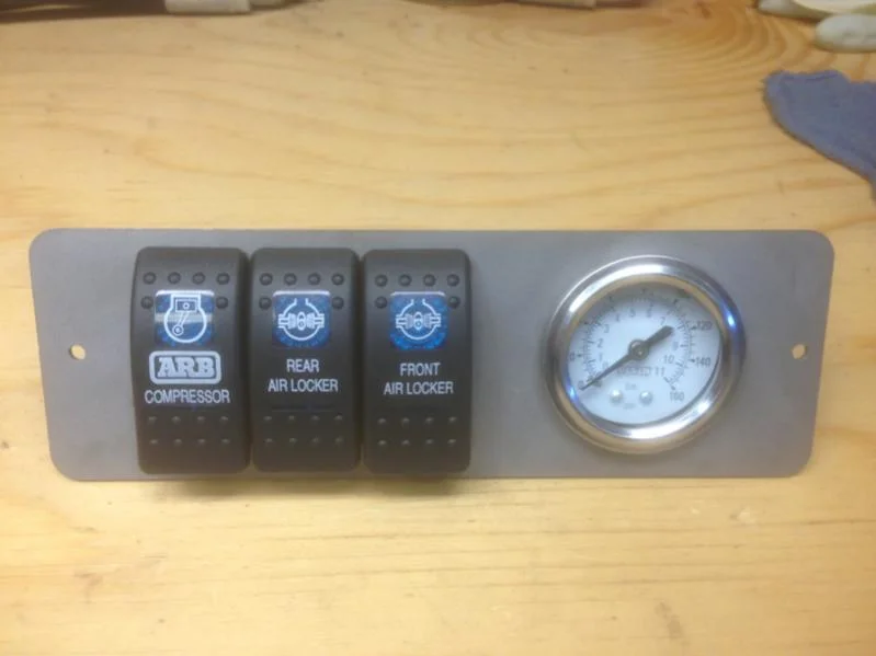

The panel is designed to use 3 of the switches and has a spot for an air pressure gauge. I had the panels cut locally on a water jet. They're powder coated semi gloss black. I've got the air gauges on hand as well.
Very simple install .......
Georg @ Valley Hybrids
looks really clean, I like it!!!
Very nice Georg. What size is the air gauge? Thinking I may buy one and put a vacuum gauge in it!
Crap. Another thing Im gonna buy from you...just got onboard air and that would be kind of nice to have plus de cluttering my switch panels

That looks dynamite.
Do you anticipate a smaller one that would fit in the ashtray space? I'm jut looking for space for 3-4 of those exact switches.
iirc the switches are too tall to fit where the ashtray usually resides. but in the current panel location there's enough room for at least one more switch, possibly up to 3 if you eliminate the air gauge.
georg @ valley hybrids
Georg, sorry for the multiple posts but I now see you've got the fittings and line, also. Can you post a price for the panel, gauge, fittings, 8 ft of line and I will PP tonight. :D
Thanks much. And very nice setup. :)
