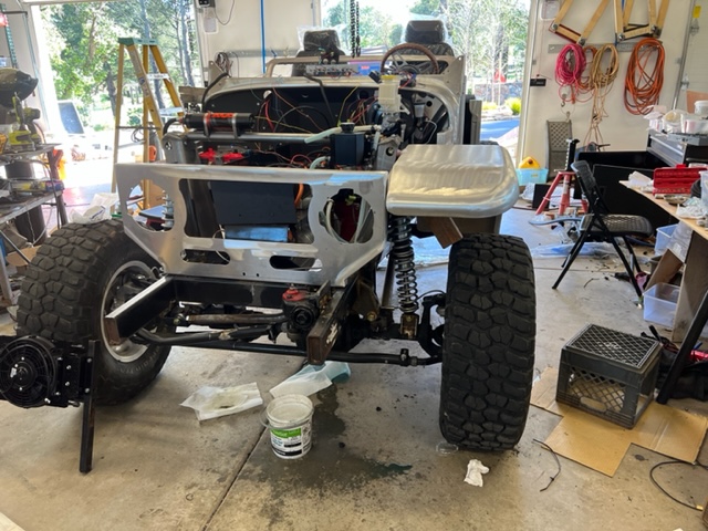

Okay, the chickens are really coming home to roost. This is my first attempt to get a fender on with coil over tower in place and tires. Not super happy with the look and I'm not sure it's going to work. This is the wide and high - where the hood sits right on the fender.
There is a LOT of gap here. they make a wide fender at the stock height, I should have bought that (maybe I still will). I don't like the gap, and it leaves that weird triangle, for which they have a part, but it's going to be weird fitting it in.
This is how the bezel mates up to the fender, this little bit sits under the corner of the hood, needs some trimming
For some reason, the fender doesn't follow the line from the cowl to the bezel, and goes in like this. Really a PITA.

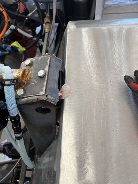

This is how much clearance I have, I was expecting another inch, and when I get the other side on, maybe I'll have more room. But, it's very tight. Had to remove the coilover fitting. I'm having to replumb the coilovers so they'll go into the engine bay rather than out into the fender well. Took many phone calls to get the right part number.
This is the line the hood follows, you can see how much the fender protrudes into the engine bay - throwing off my calculations taken from my fj40. All in all, I'm not thrilled with it.
that's the way it's supposed to fit. :There are bolt holes that align it. That gap in the top half is part of the design - it's a weird design. the little triangle that fits in there is just as odd.

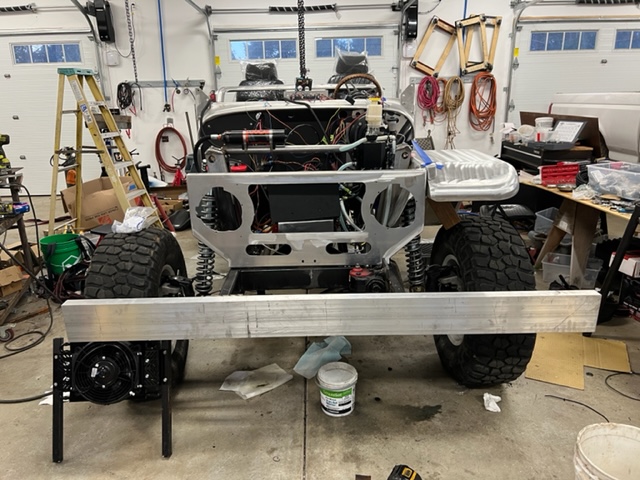

I've ordered the wide fenders at stock height from Aqualu. Ouch, but had to do it. So, imagining these fenders 4" lower, and a version of this bumper, what kind of turn signals should I use? Old school in the bib, or new school on the fender?
I used LED headlights with built in turn signals on mine I couldnt find anything that i liked. The LED headlights with the turn signals are an option???
