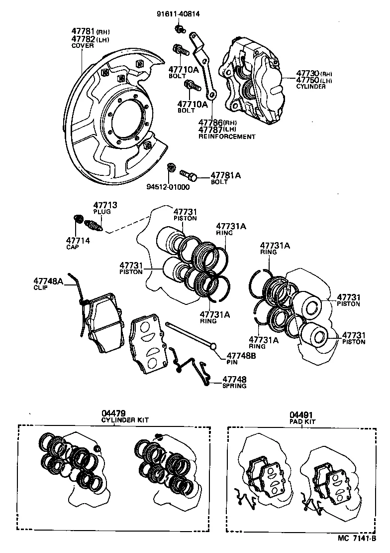

i can not find metal plates anywhere
this is the Toyota drawing
