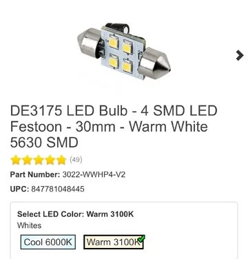

When you get the switch squared away, install this LED bulb. It's so much brighter & only uses 65mA.
DE3175 LED Bulb - 4 SMD LED Festoon - 30mm | Festoon Base LED Bulbs | LED Car Light Bulbs | Super Bright LEDs
