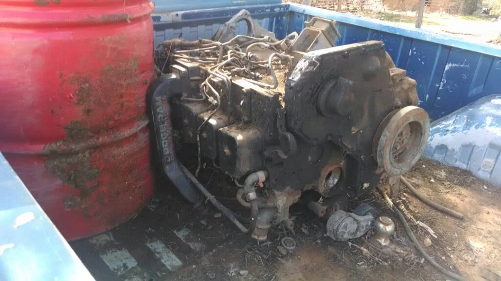

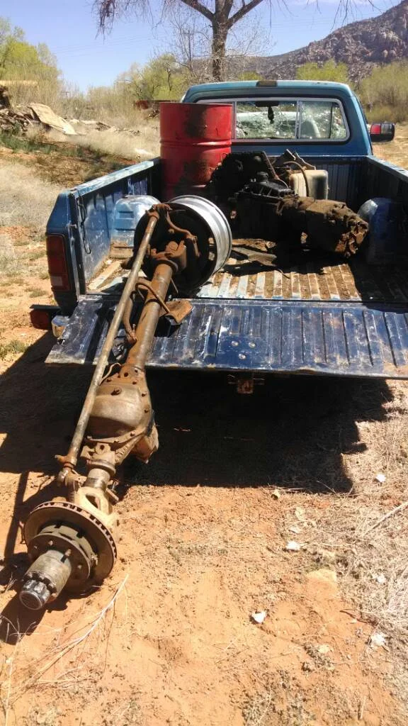

We left at 3 am this morning for our 600 mile journey and ended up with a running 12 valve truck. The other 12 valve in the bed with 130 k on it. A getrag trans with t case and a kingpin Dana 60 for 1300 bucks!
You bought a running 12 valve truck, a spare 12 valve block with trans and tcase, AND a early dodge D60 for $1300? Holy crap man, I thought I found good deals!
