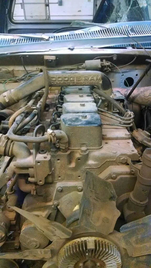

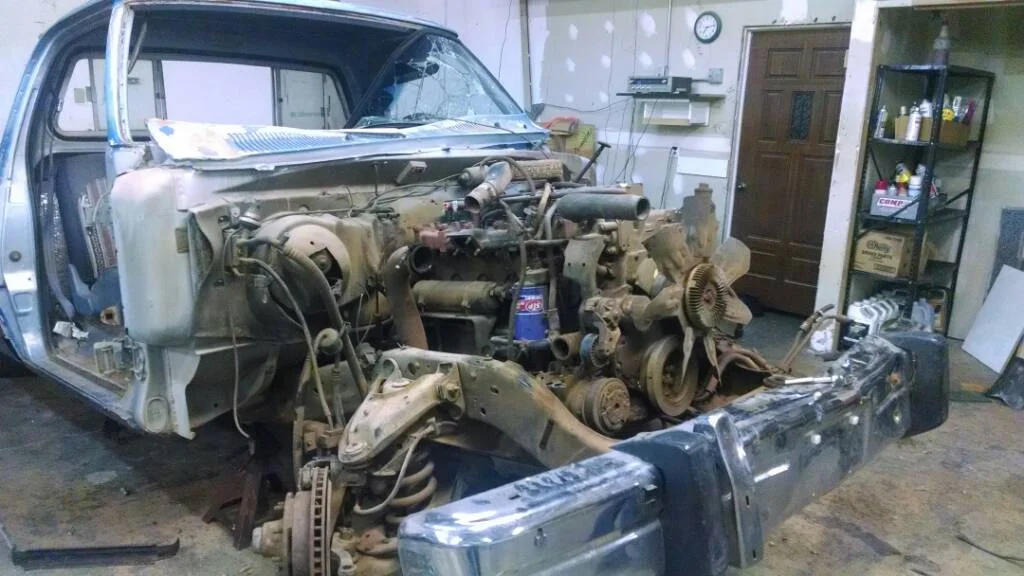

I did get this progress done yesterday on getting the 12 valve out. My buddies engine hoist broke yesterday so it didn't get pulled but is 100 ready to come out. I am taking mine down today to pull it out and start the engine work. These 70 hour weeks are really killing my time to work on everything
