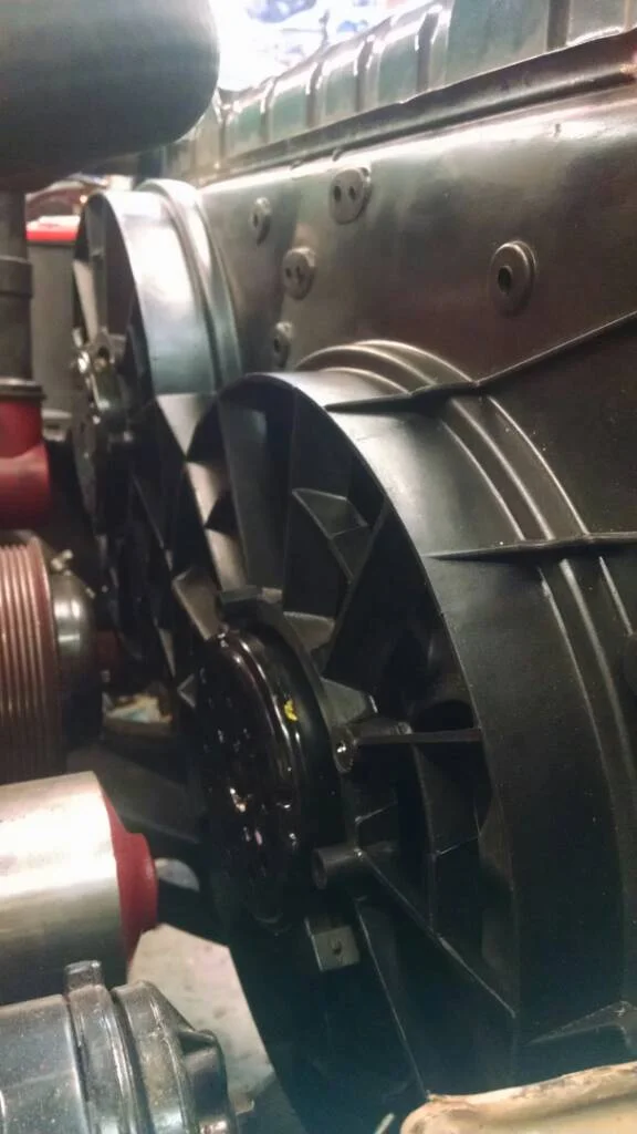

Got my dual electric fans and pig tails also got my Cummins input shaft!

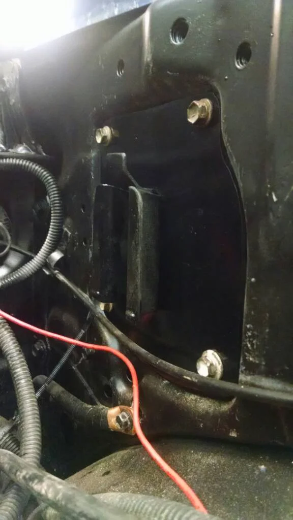

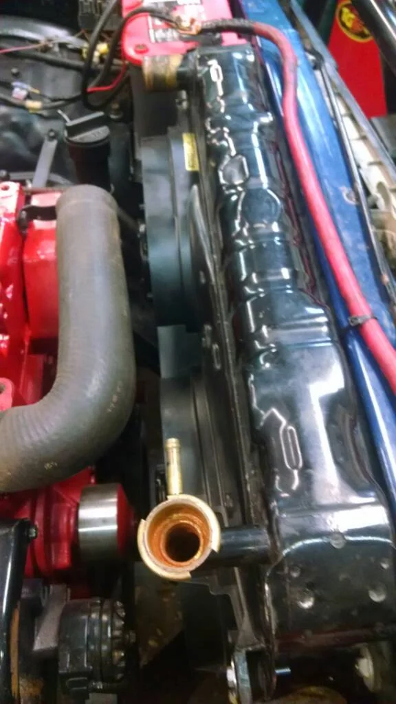

Got my dual electrics all mounted up and back in the rig. Last pic is the new location for the radiator resivour.

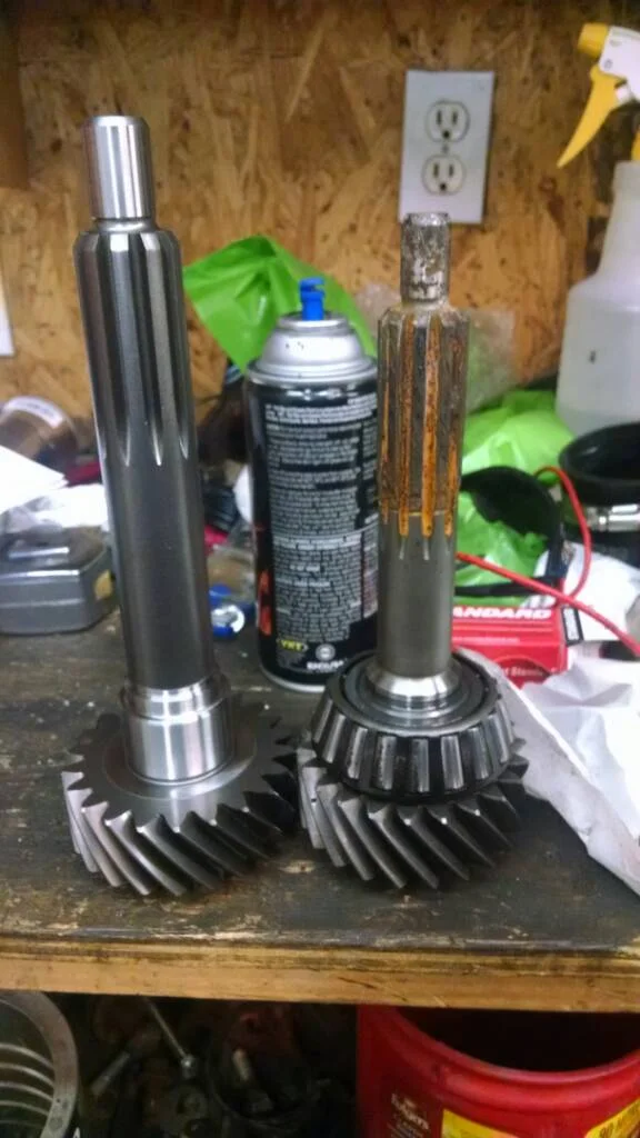

Here is the Cummins inputshaft (left) compared to the old one. It dwarves it.

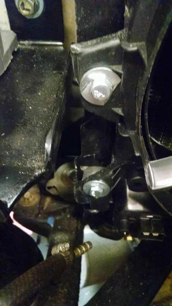

Yeah its getting real close now. Now its balancing working a few jobs to get the money for the rig but then you don't have the time haha. I'm curious as to how you mounted your fans like you did. I was going the route until I got it to fit this way plus I didn't have the room between radiator and motor for the square tube
It's either money or time we lack, we never have both at the same time!
The square tube I used was not inbetween the fans and radiator, but next to. I cut those tabs you used off and then mounted the square tube to the shroud with bolts, and the square tube to the radiator captured nuts.
Either way, looks like you got it sorted!
Oooooh! That makes sense now. I was wondering about the tabs too I was a bit confused but yeah fits well!
