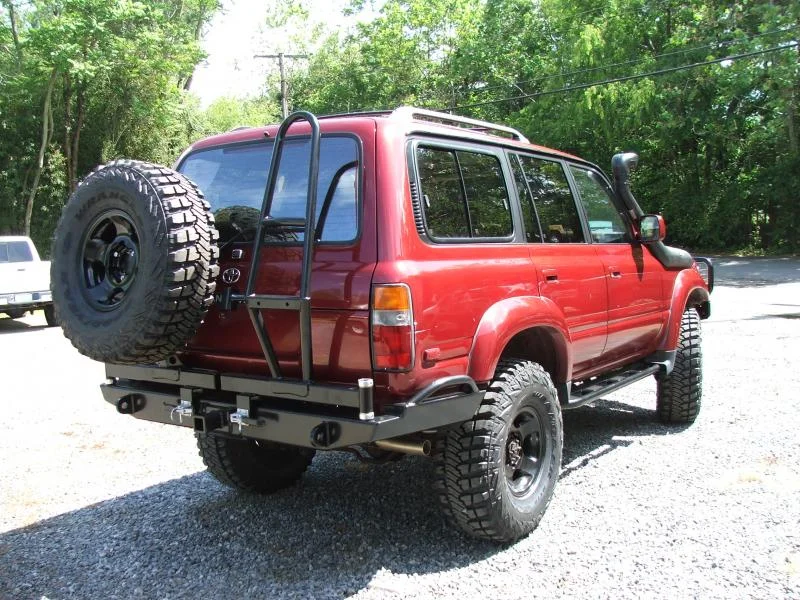

We've built sliders for Pigs in the past. If you're in VA, that makes it pretty easy for us to fab up something for you. Here are some shots of of some of the ones that we've built before. These particular sliders are grafted onto our replacement 3/16" rocker panel replacements.

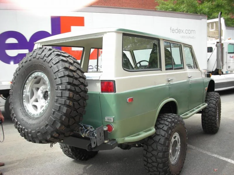

We can also bring the sliders off of the frame, to make them slightly lower, and more "step like". I don't have any pics, but we've put plate across the top before also to make them a little more running-board-esque. This obviously is not a 55, but this is an example of our sliders coming off of the frame instead of the rocker.
